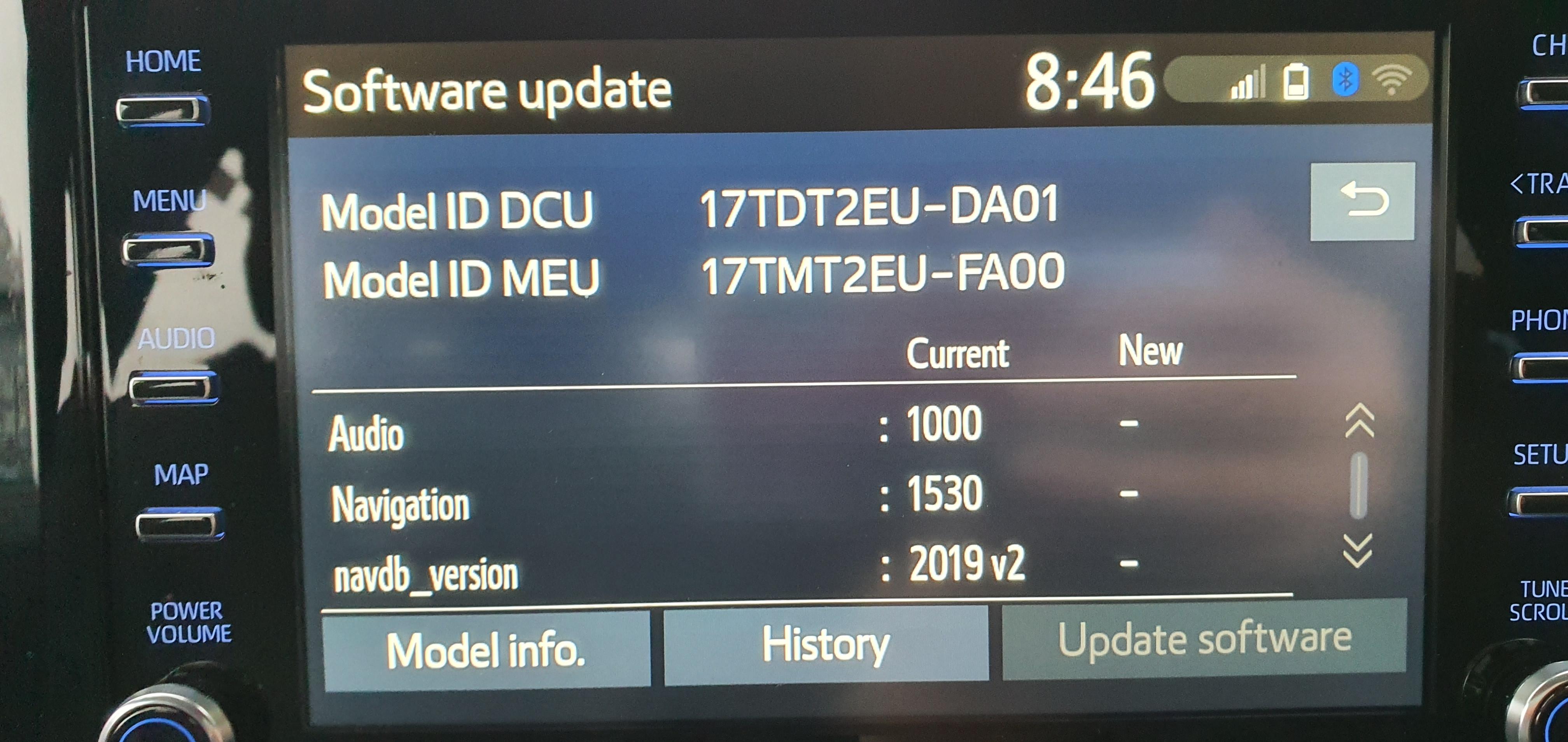

just been to collect the corolla st from the main agent for a repair to front wing and have had the software/firmware updated. not the one you can download from toyota but main agent only type
any idea what has been updated and what I will notice

What version is it?
Here is the pic from the car
There is a newer Audio version 1010 (or 1100, don't remember exactly).

latest audio software available this date is: 1011  (ToyotaTouch 2 MM17 - Software fixes for DCU : BE-00200T-TME)
I believe it is dealer only.

There are 3 things that can be updated
Audio is DCU ( Display control unit ) latest is 1011 on bulletin BE-00200T-TME, can be updated at dealer or via toyota-tech.eu ( chargeable access )
Navigation is MEU ( Media extension unit ) latest is 1530 on bulletin BE-00200T-TME, can be updated at dealer or via toyota-tech.eu ( chargeable access )
navdb_version is the Maps and updateable via dealer or MyToyota latest is 2019v2 ( new due April ish )
