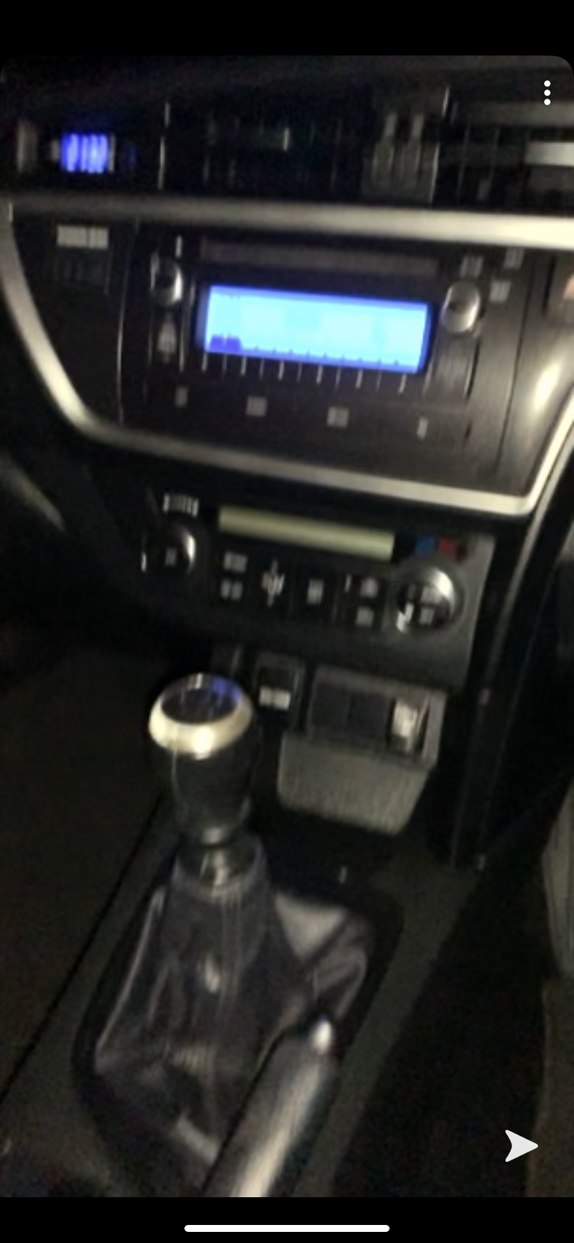

Iv a 2014 auris diesel and the silver ring on knob is worn down anyone know if it can be replaced because it doesent liook nice worn down and anyone know of where I could get one cheap if they are expensive thanks

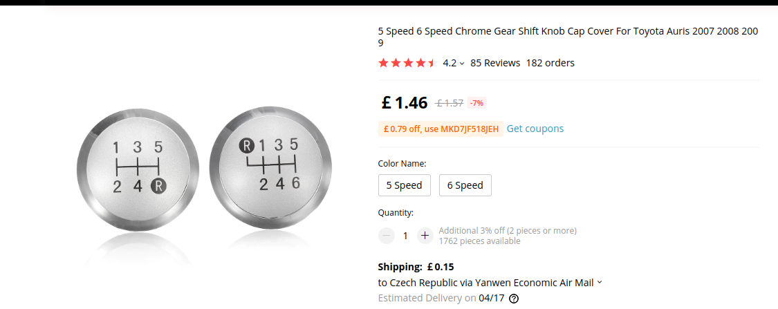

I saw them being sold on aliexpress, you can either just buy the toplate for 2-3 GBP, or the whole thing for under 10 GBP, up to you.

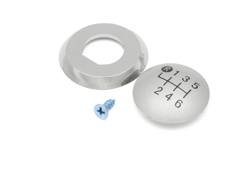

I think the replacement is like this, you unscrew the knob, then look inside ,there should be a screw, undo that, and whole thing falls apart.
So, you can just replace the ring, and not the whole thing if you dont want to.

The top ring part is 33624-09040 for six-speed, and 33624-09070 for five-speed. I have had a little difficulty sourcing the part however.
I learned this from the post below:
Correction, the decal cap and the decorative chrome ring are both together in the part I quoted. It was available very cheap from my dealer.
In the original Toyota part, there is no screw. You can pry the chrome ring off with a plastic spatula or carefully with a large screwdriver. The new one pops directly on if you align the nylon key.
