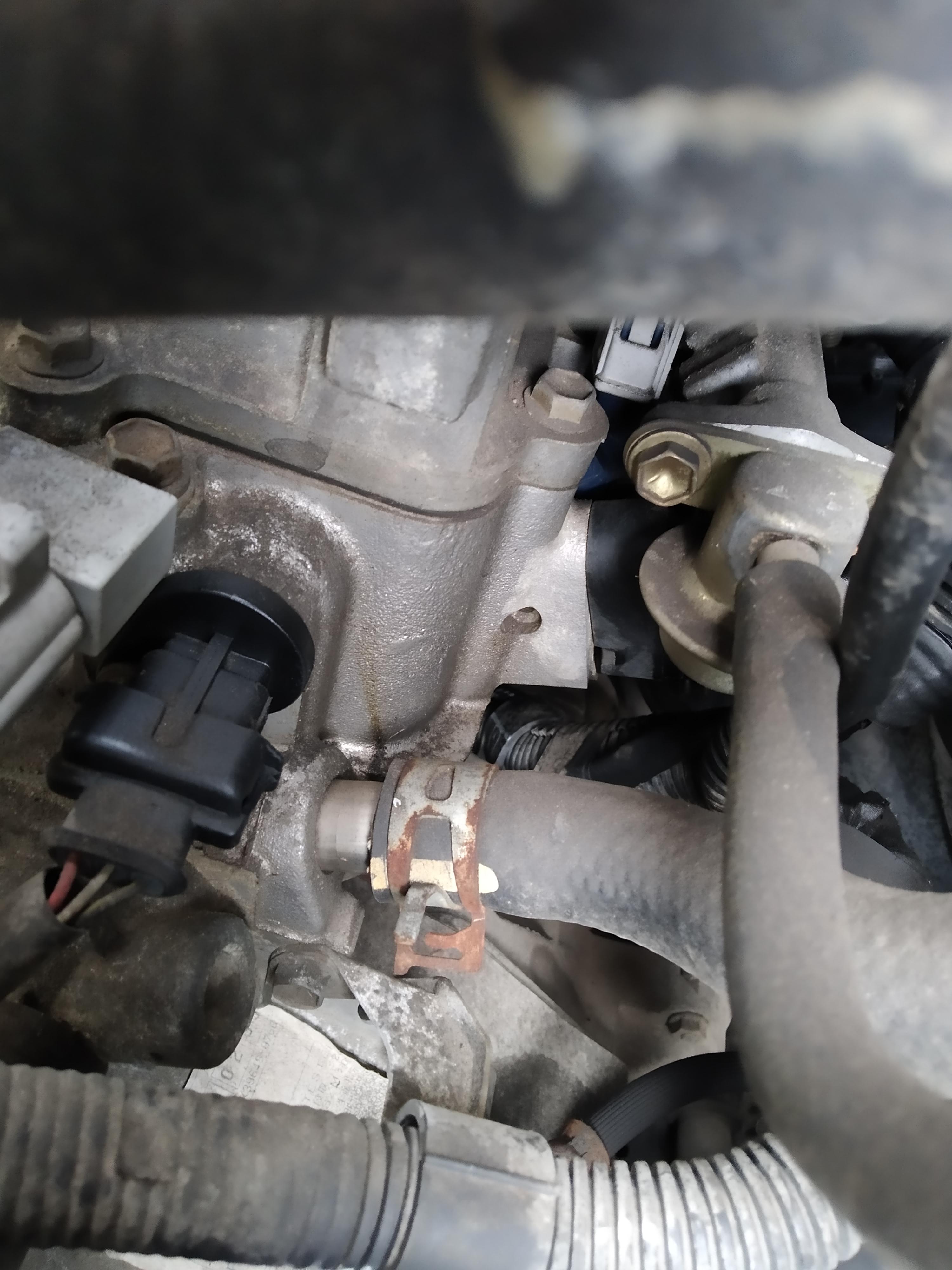

Idle reacts to cleaner being sprayed at air manifold 3.  I used to working on cars with carbs so I assume this is the air in?  What I'm calling no 1 cylinder.  I'm going right to left when facing the Engine
I would call that no. 4 cylinder.
Can you see any cracks in the plastic inlet manifold? Also what are you showing us in the picture?
I can't see if there are cracks in the manifold.
That I was trying to saw in the picture was one of the manifolds
I didn't realize the manifolds were all one piece.  Plus the gasket is one gasket for all four.  It's going into a garage this Tuesday but I had a Google and couldn't find and new manifolds for sale??
It may be that it's just the gasket that' s leaking but you'll soon find out once it's removed, eBay have a few pre owned ones for sale! Thanks for posting and please update us with your findings.
