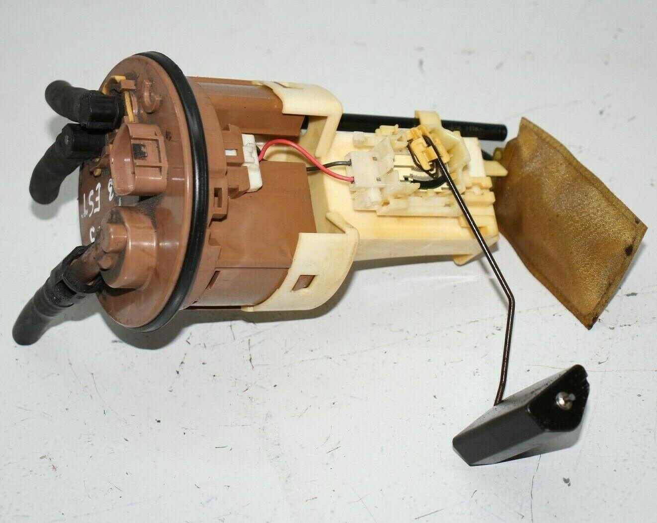

Thanks . So what is thing that is located under rear seats? Is it in-tank filter?
There should be nothing under your seats apart from the fuel tank. On the fuel tank you have the sender and a low pressure fuel pump. The low pressure pump has a strainer on it but is not something you need to mess about with.

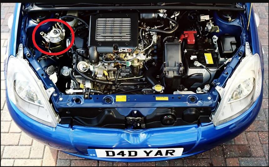

Thats what i have same as your pic ,so i wont be touching that lol. Is that blue car in the pic yours?
No the car in the picture is from google. I owned few mk1 1.4 d4d’s during the years. I moved onto mk2 1.4 d4d’s couple of years ago and i still have an mk1 same as yours in silver.
