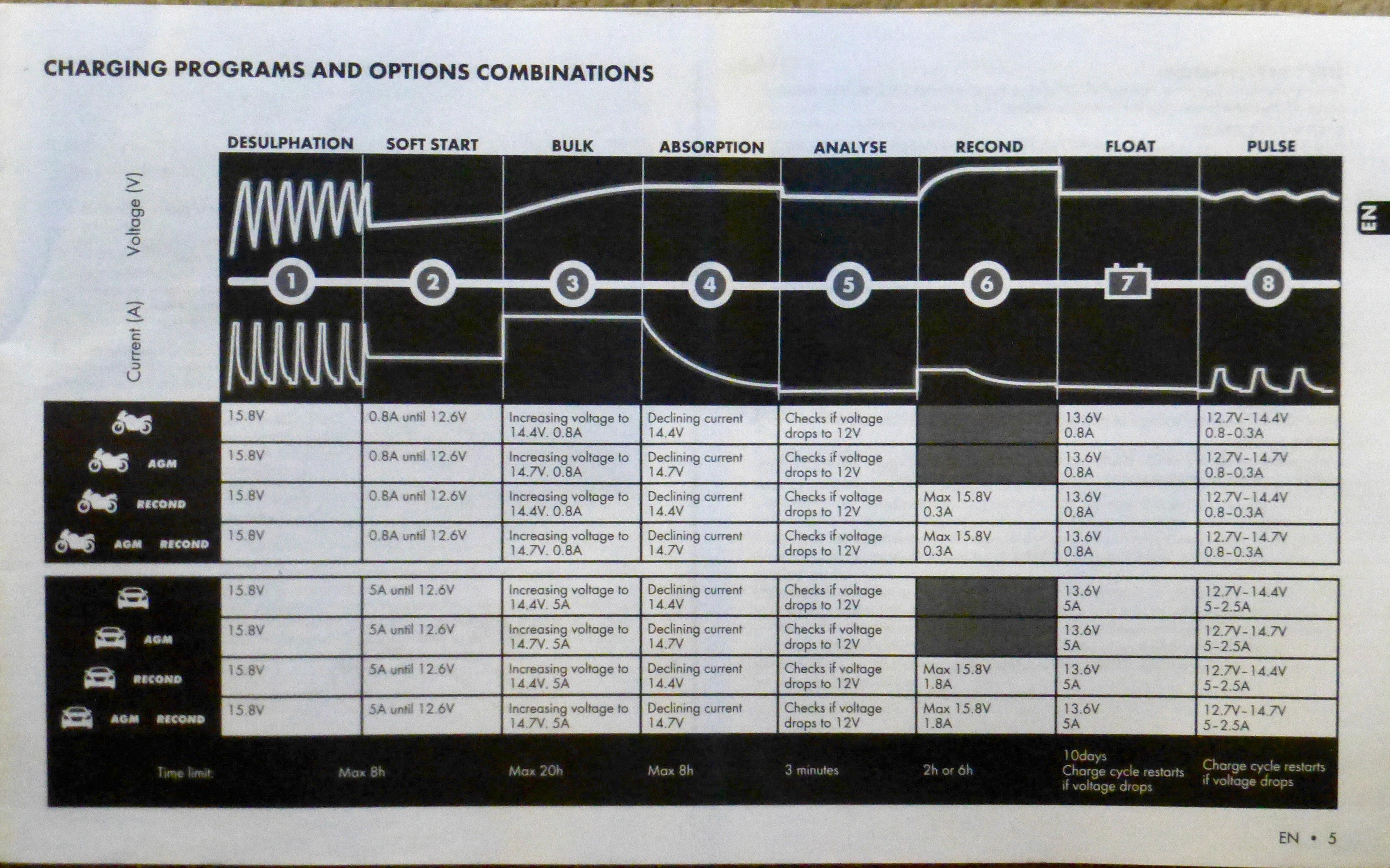

If it's of any use, this is a copy of the owner's manual for the CTEK.  I don't have one, I was just interested to see what it said.
(I'm sure it's available on their website too, but anyway.)
P1120616.thumb.JPG.3476ffa4cb26d8c54646be2a7e61563f.JPGP1120617.thumb.JPG.d7ac32e95cc4b25ec59f405b08fab595.JPGP1120618.thumb.JPG.8f1a4cf3faeb03e77243414b9e5ee23a.JPGP1120619.thumb.JPG.e0bd4007d4f9ff3682da7c80ad3a9753.JPGP1120620.thumb.JPG.02b1eedb8713bc53c408f3265546d2a8.JPGP1120621.thumb.JPG.f9ebc6e80ce6c8d7fdcab38654763d9d.JPG
