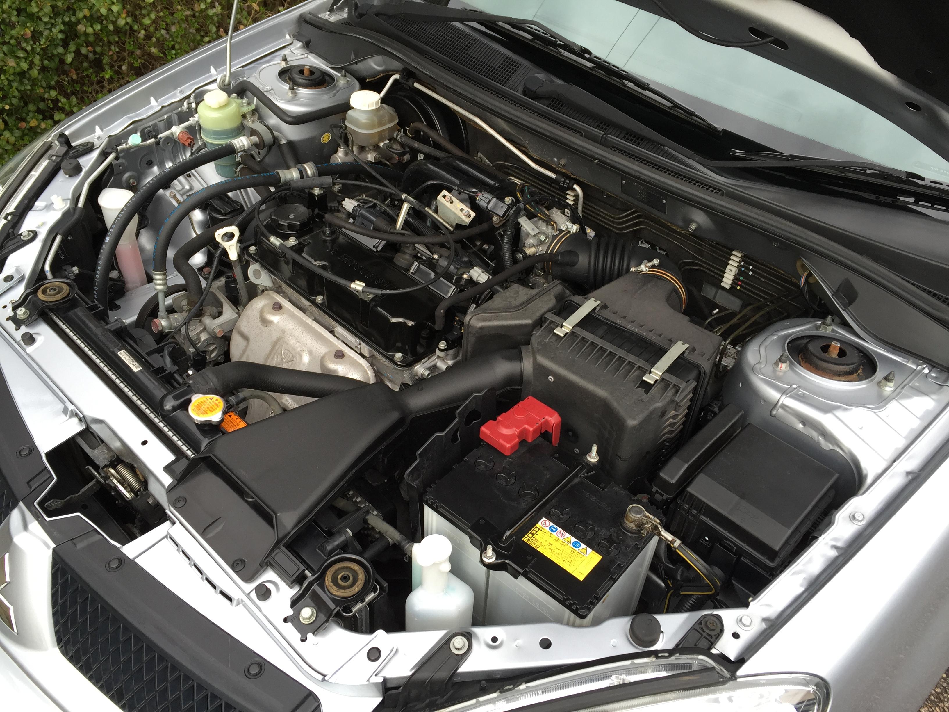

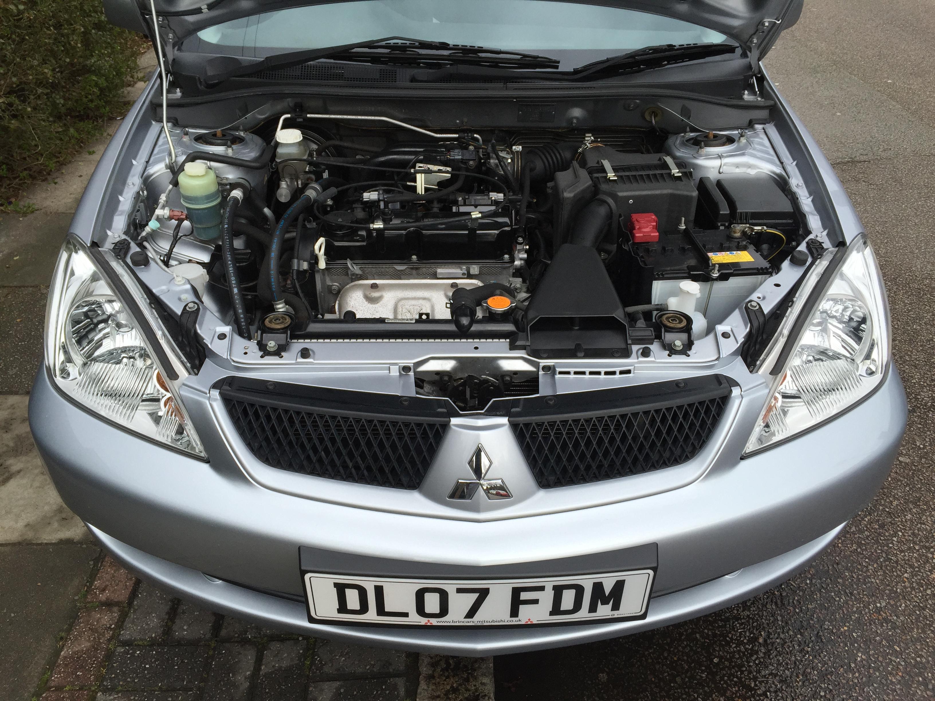

My previous car Mitsubishi Lancer a proper old school car despite build in 2007 had a non sealed Battery that needed some top up from time to time, I bought the car used 9 years old with only 42k miles then two years later sold it at 133k with its original Battery, there were no signs of aged Battery at all. Proper Japanese machine. Miss that car so much. 👍
