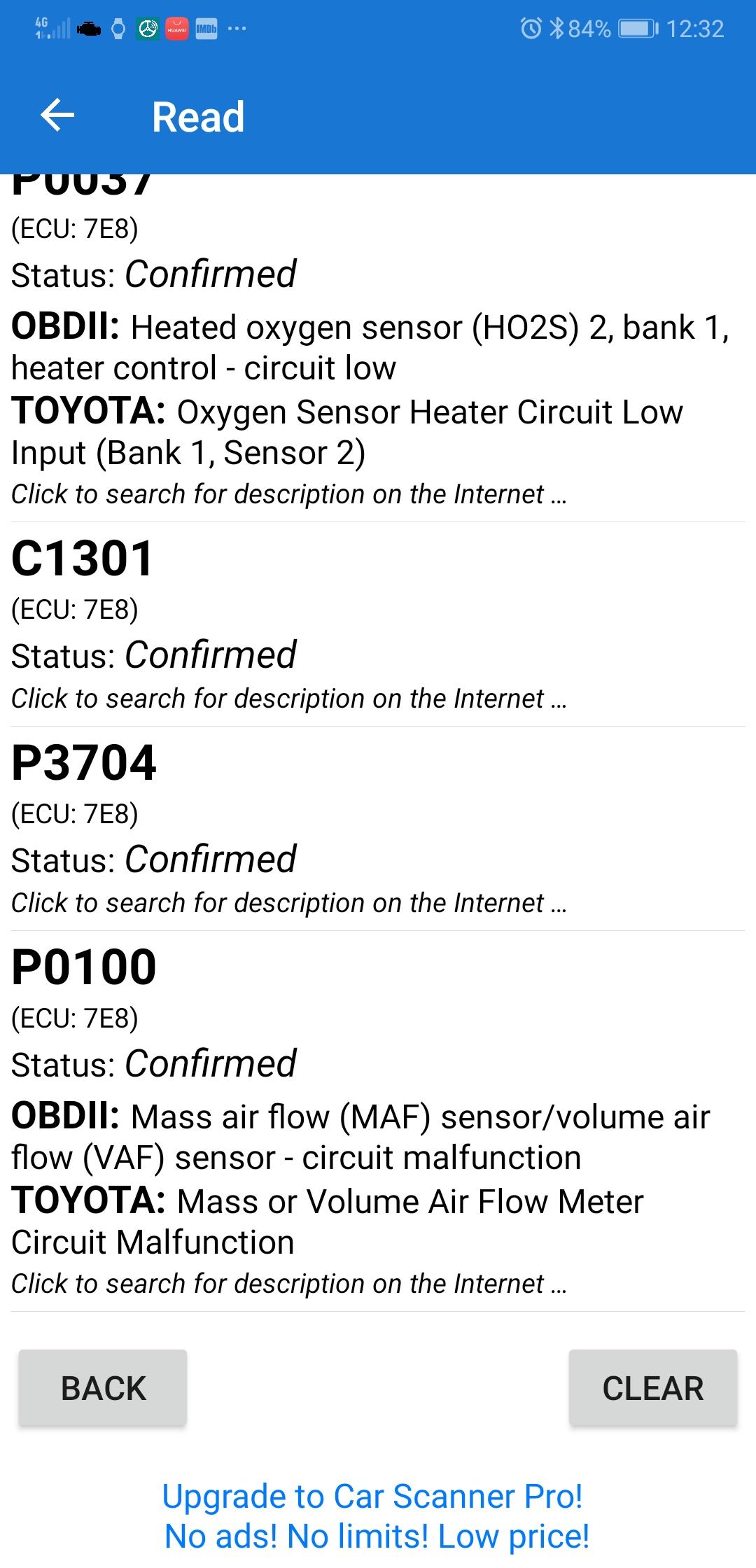

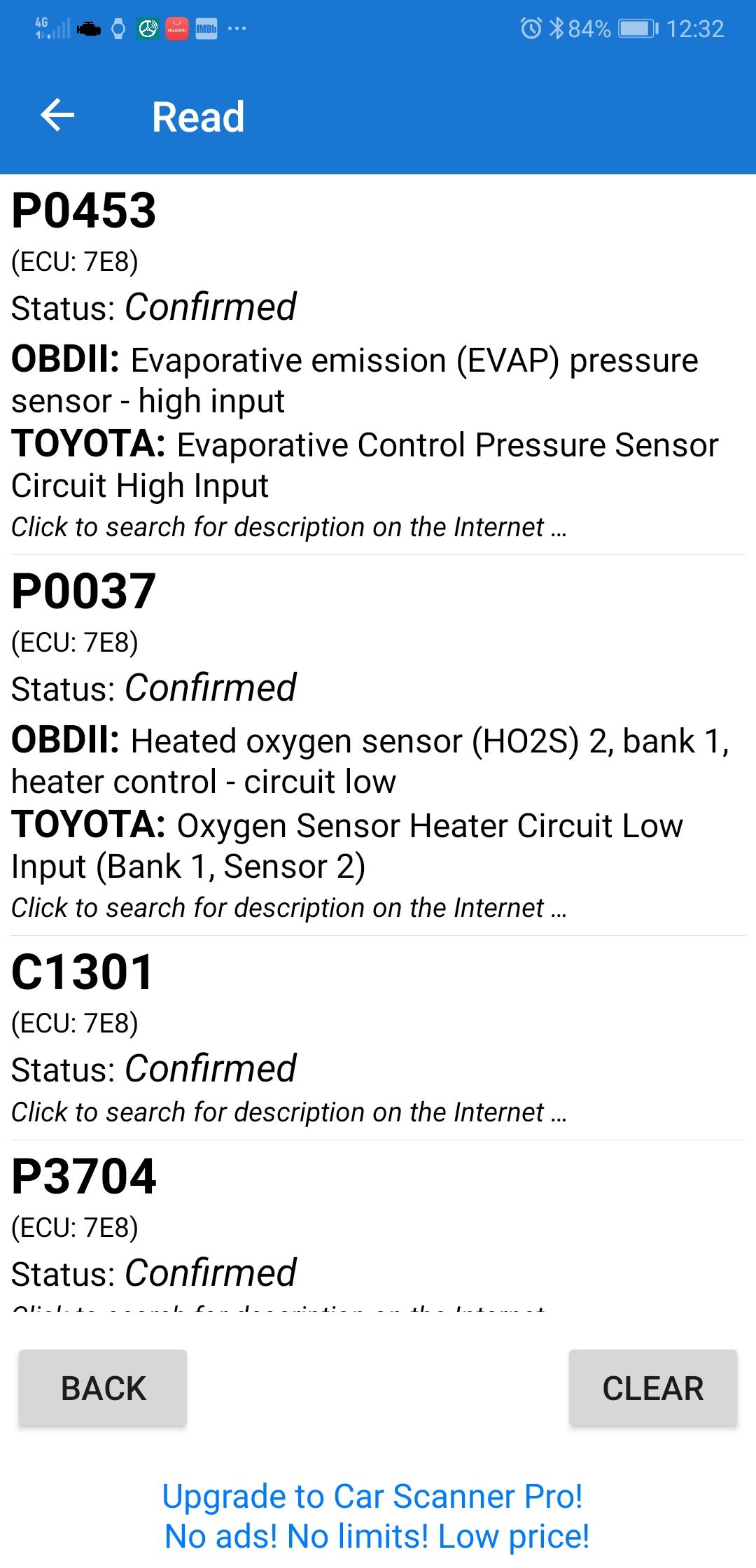

I have an engine management fault and the VSC off is flashing. I'm new to OBD2 but managed to get the following codes:
P0453 Evaporative Emissions pressure sensor - High Input
P0037 Heated oxygen sensor Low input (Bank 1 Sensor 2)
C1301 Unknown
P0374 Unknown
P0100 Mass air flow sensor/volume air flow meter circuit malfunction
The car drives fine but when I reset the fault will come back after driving for 5 minutes. Any ideas?
