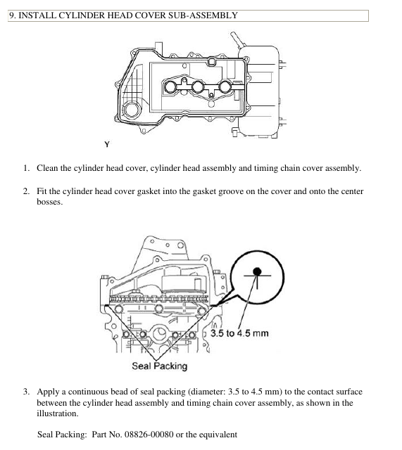

Hi mate I've change the rocket cover seal but I've noctie oil is leaking from the rocket cover seal and just put a new one could u tell me what I've missed or do u know what it could be
Where is it leaking from? Did you apply a blob of sealant on the joint between the cylinder head and timing chain cover?
It's all sorted now mate and do u know where the website is for this picture im trying to find the tightening of the bolts order and torque settings please thankk you
Thank you for the link it's going to really help me to do the gasket cover seal the right way if there's any other links
