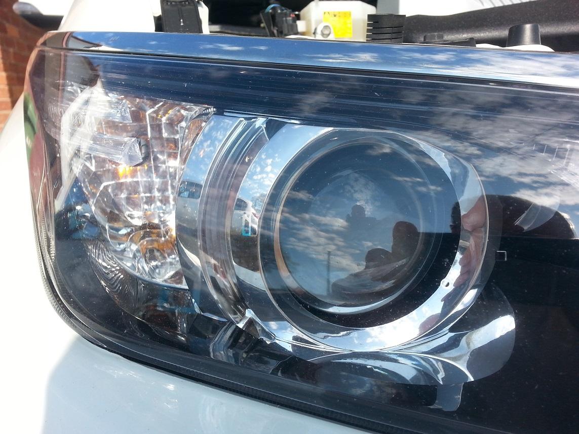

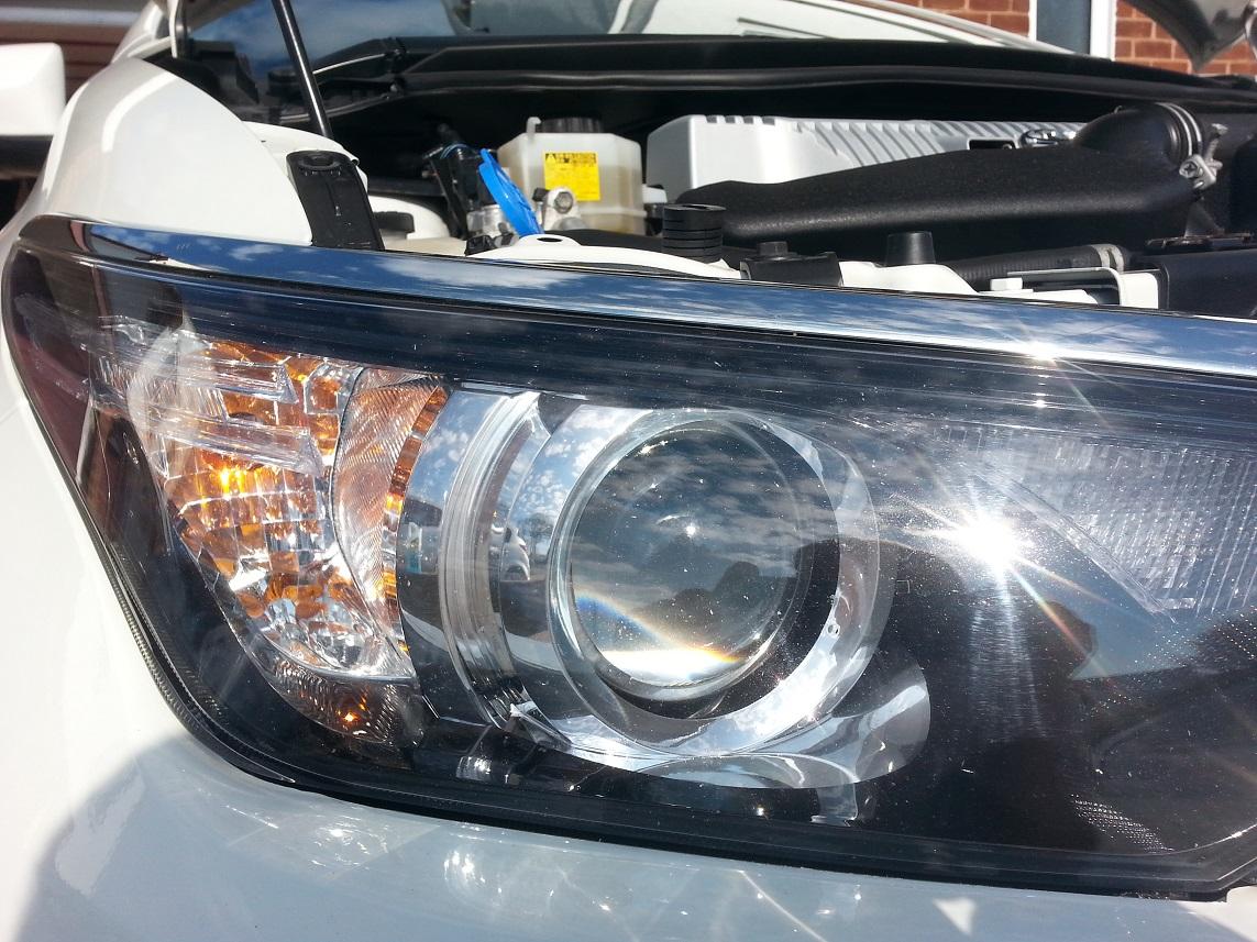

at last i managed to fit the chromed indicator bulbs to our mk2 facelift
i found there where 2 lugs on the new  bulbs that where too wide so i
had to use a diamond file to reduce the width of the glass lug.
here is a before and after pictures.
