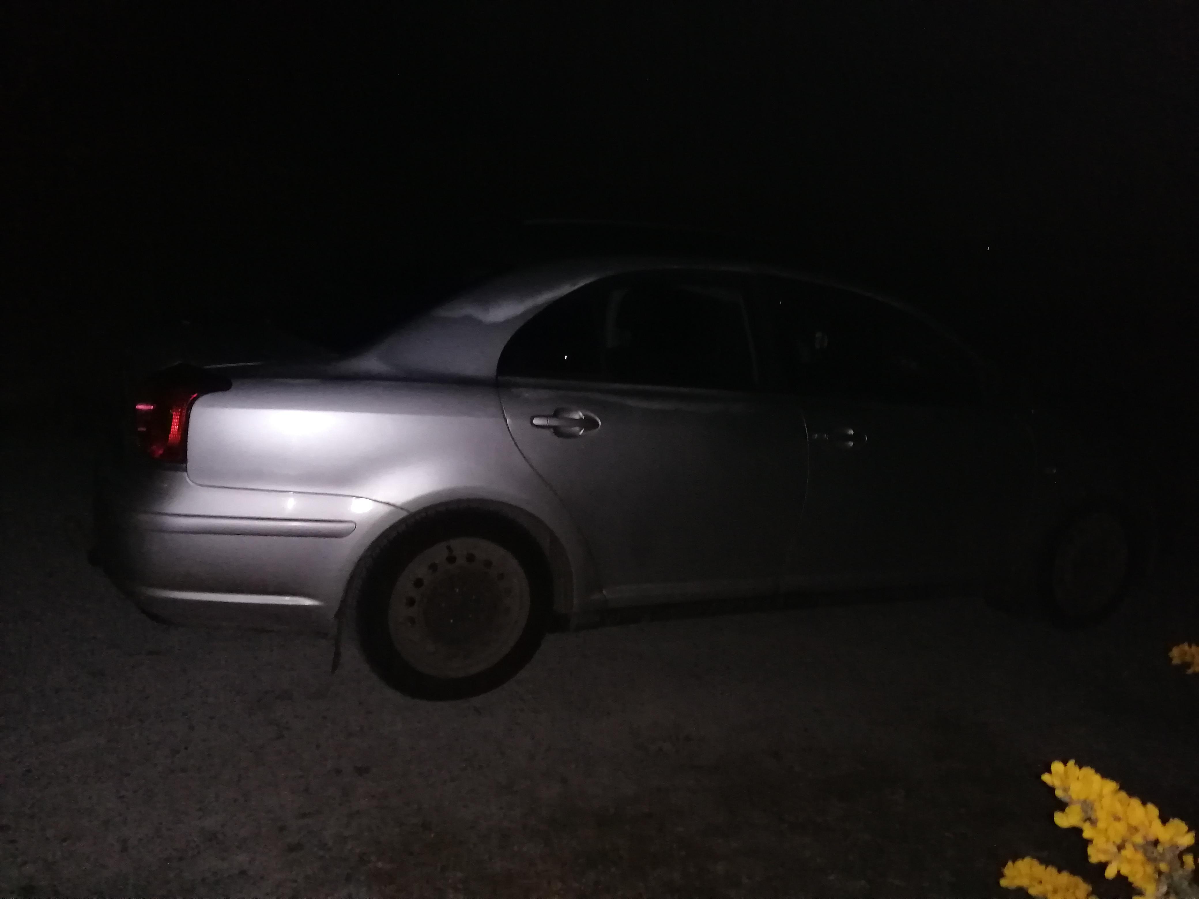

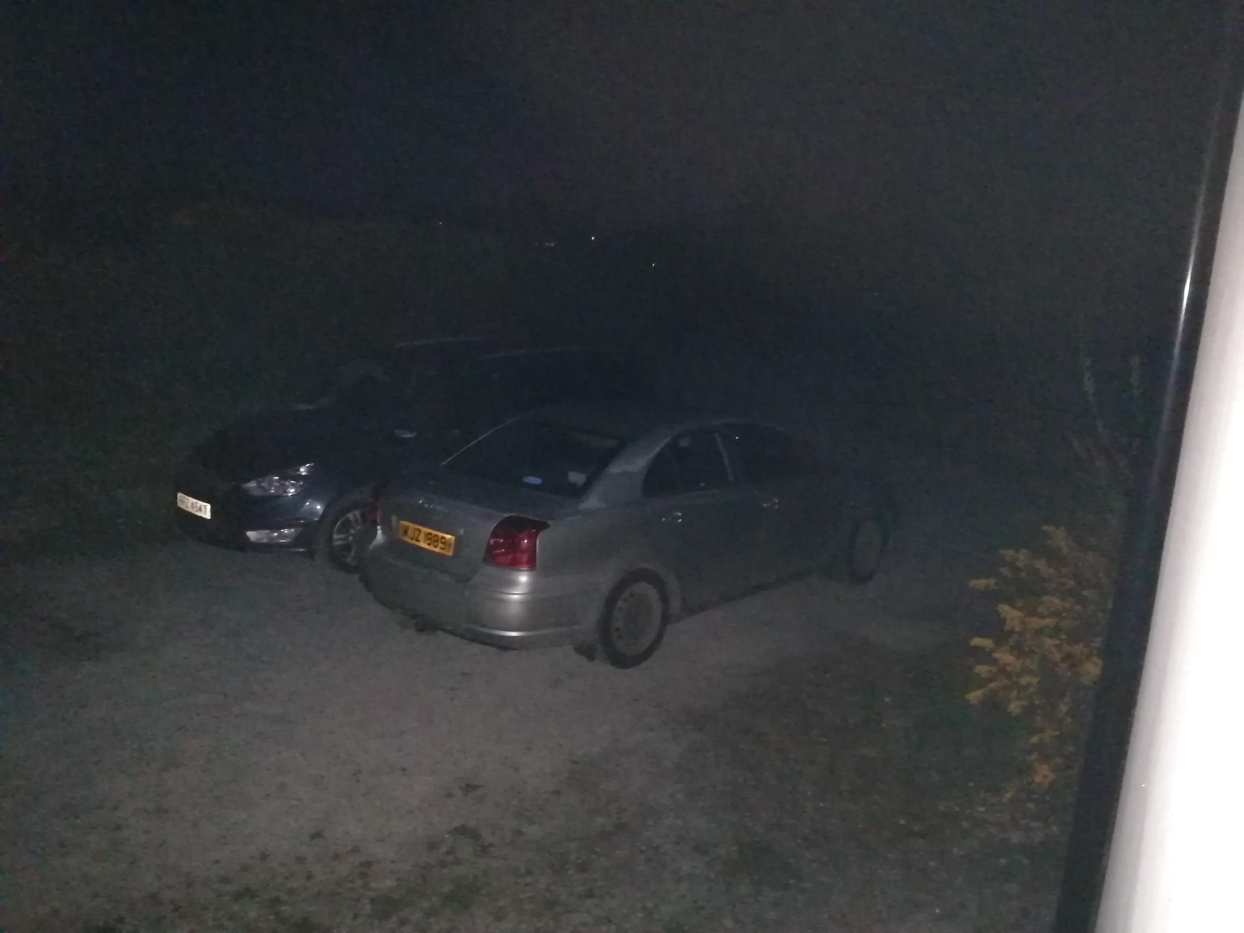

I take it your car is the saloon model?
Yes, it's awkward
