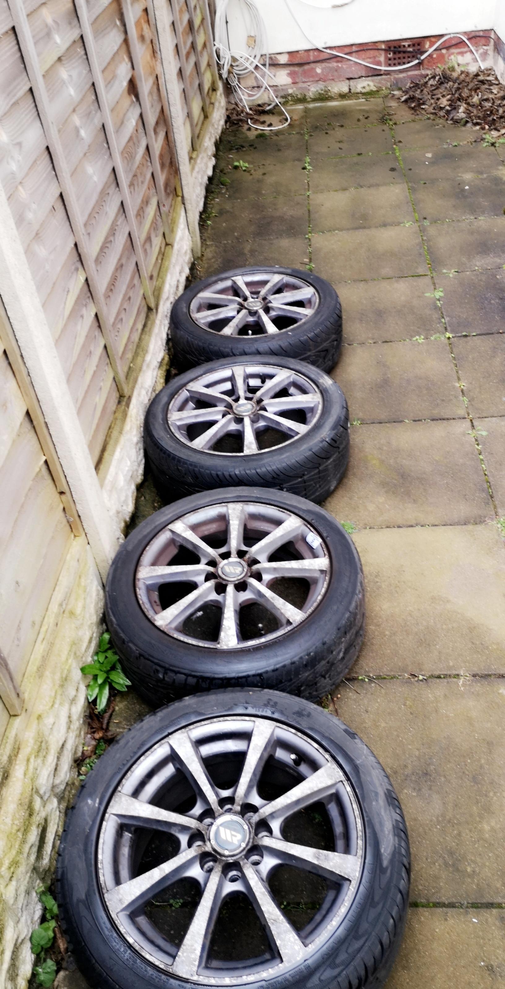

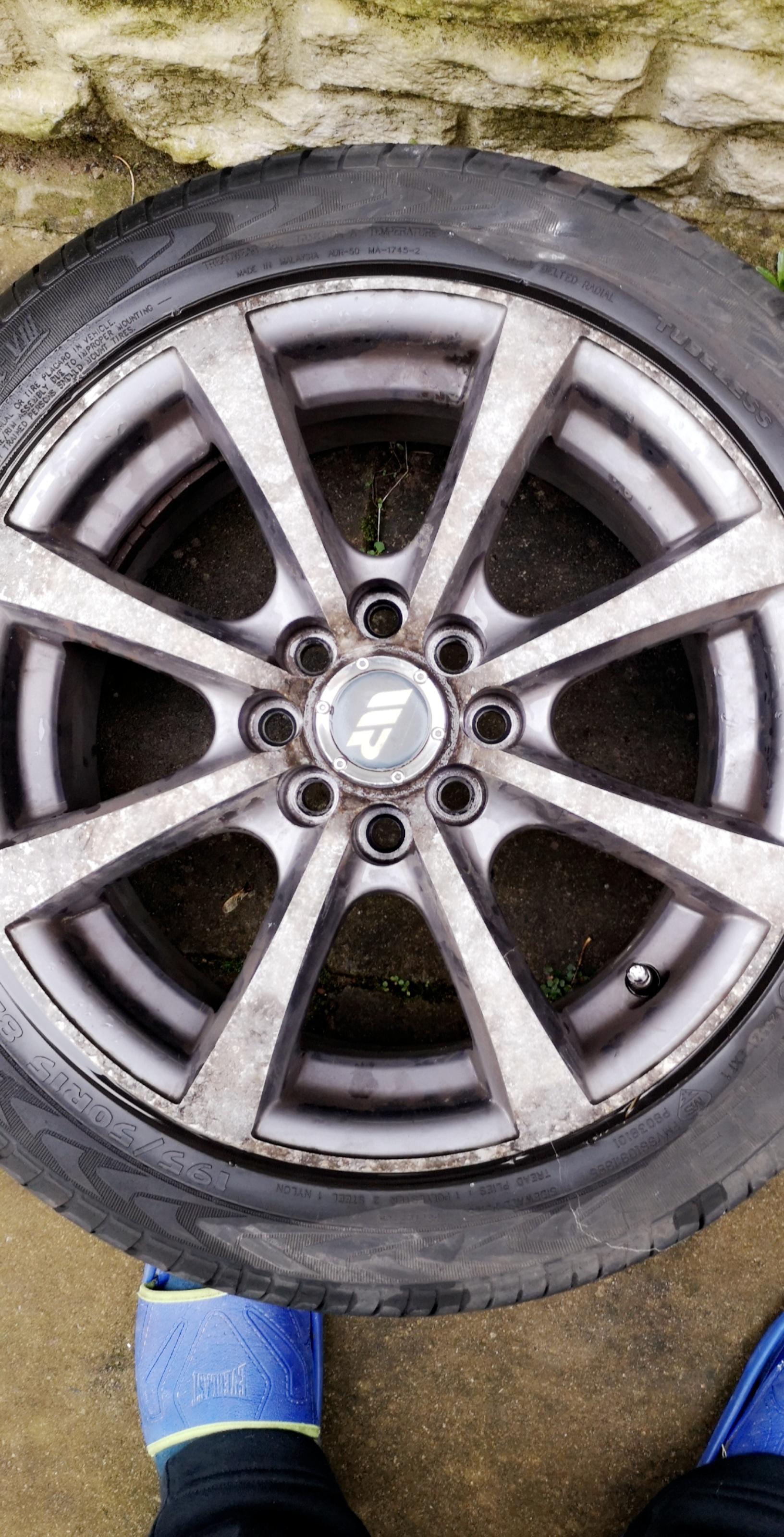

Hi, I have a Toyota yaris 2006 vvti 1.3 petrol. I have recently purchased ripspeed alloys that are multifit alloys can fit 4x100 and 4x108 and have 8 holes. I don't have the nuts I tried the bolts from the steel wheels but they don't fit. What nuts would I need?? Please help

Have a look on eBay, Yaris alloy wheel nuts, there should be many suitable alternatives. If the studs are the same as most then they will be M12 x 1.5mm thread.
I expect the steel wheel nuts will have a taper but the alloy wheel nuts are flat. Do your own research though because of those wheels not being originals!
Something like these: https://www.ebay.co.uk/itm/16X-TOYOTA-AURIS-MK2-2017-1-2T-ALLOY-WHEEL-LOCKING-NUTS-SET-FAST-POSTAGE/274298120466?hash=item3fdd712912:g:A68AAOSw3rleYnq0

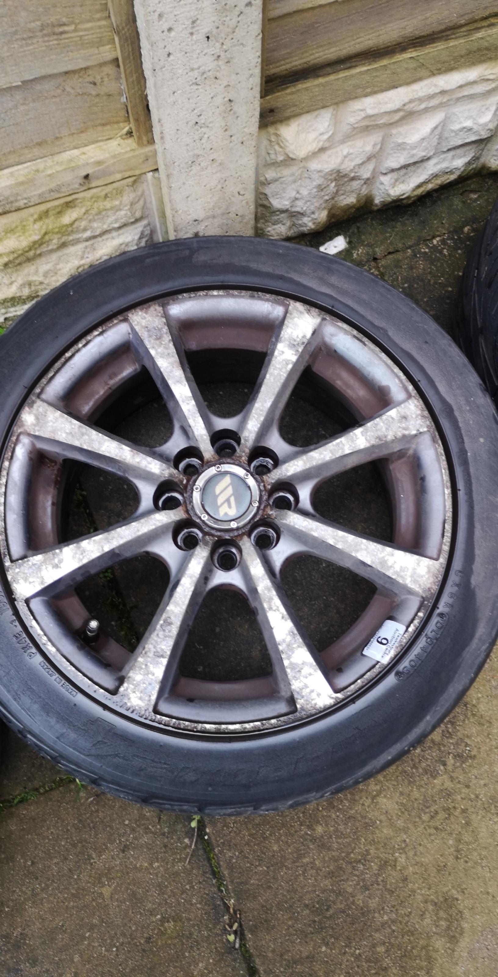

Just be mindful that they have to be flanged nuts as the tapered are for the steel wheels only but looking at your wheels you may need tapered nuts, hard to tell really.Sorry not much help really.
I've had a closer look and they appear to me that they accept flanged nuts, sorry for the confusion!
EDIT: I used to be indecisive but now I'm not so sure! 🙂
Be careful and make sure you get the correct nuts, get the wrong ones and your wheels will work loose and come off, might be best if you contact ripspeed.
I've just had a look and it appears that I will need m12x1.5 with a 60 degrees seat. 37mm in height.
