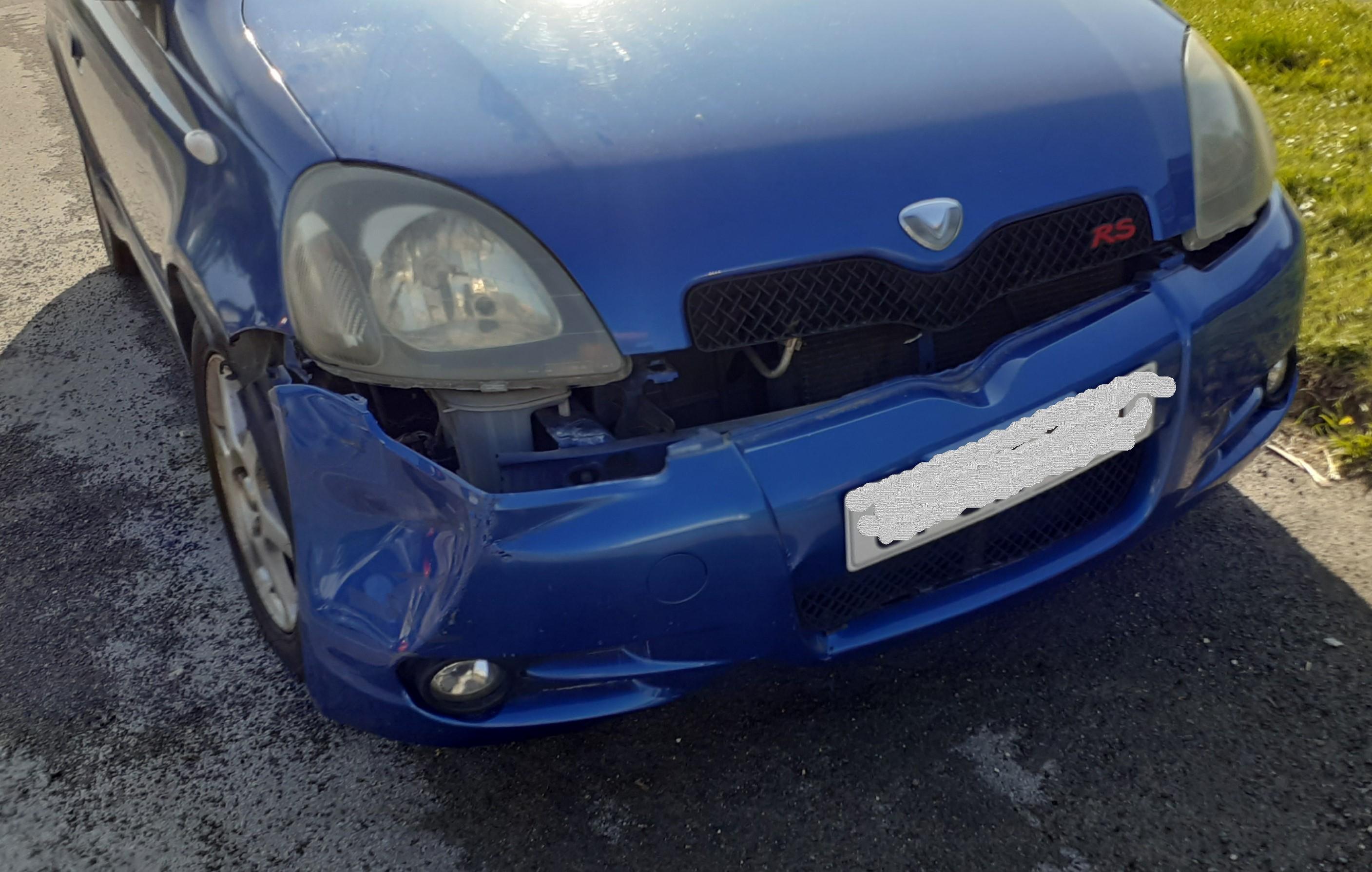

I am looking for a replacement front bumper for my Vitz RS Sports 2002 ,Japanese build.
I would appreciate it if anyone could suggest a supplier, or maybe you have one yourself.
Have tried internet search but no luck so far
See attached photo
Thanks
David

52119-52140  or 52119-52140-J0
if it hasn't ripped it mountings, you should be able to pop that back out with a heat gun or hot water
If you take that through insurance they will write the car off

I was parked outside my home and a neighbor's car dealt me a glancing blow as she tried to avoid another oncoming car. She could not get the other car's details, no witnesses, no dash cam footage either. She did admit liability and her insurance company, like you say, call it a write off. So with what cash they will give me should hopefully cover the cost of repair. Hence my question.

At a guess a brand new bumper will be in the £5-600 range from  a main dealer if they even stock them, it will be a special order from japan
If you can find a local body shop willing to work with your current bumper it may be £2-300 inc paint
They are the same as a T-Sport from that year, you can still get them new through Toyota dealer.
Usually a couple breakers on eBay too.
I would double check that they are similar but knowing what the jap spec car's the mounting will be different

They are 100% the same
