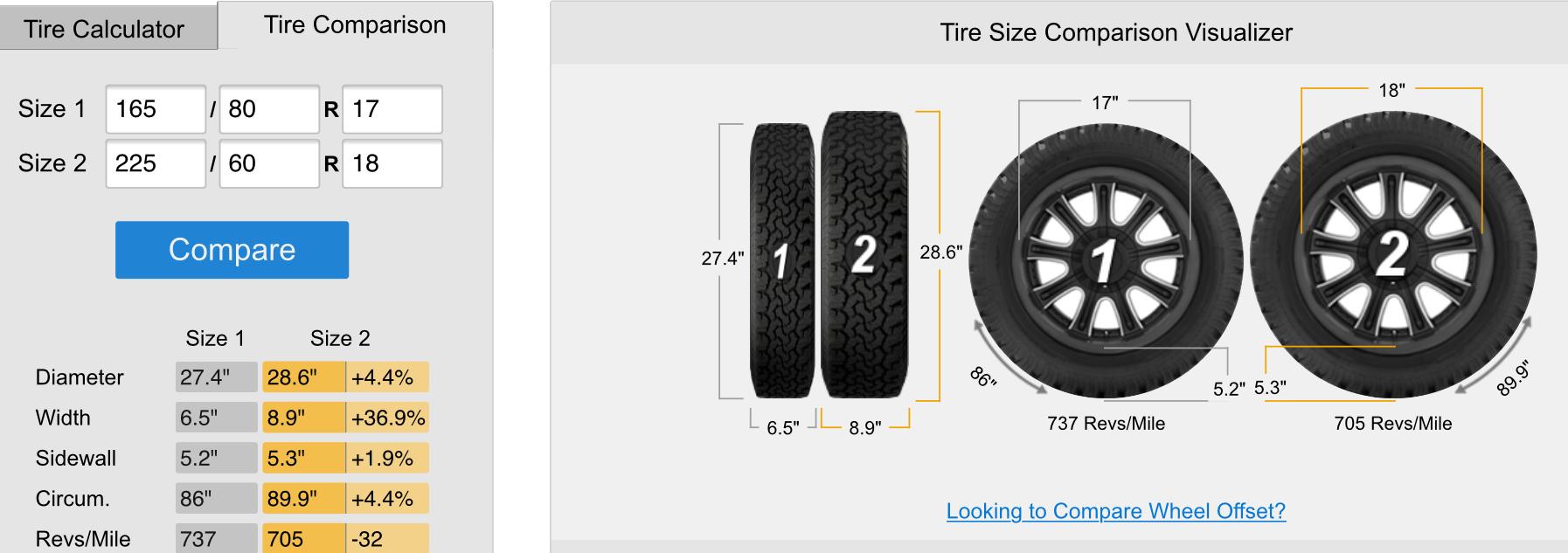

They are reasonably readily available - see here for example. Note that, as they say on the site, the 17" space saver is suitable for RAV 4's equipped with any size wheels from the factory. I have factory fit 18" wheels and a factory supplied 17" space saver ...
Although the spare is 17” and the wheels are 18”, it’s the tyre profile that makes the difference. Even thought the spare profile is larger overall the spare diameter and therefore circumference is smaller. See the diagram here...
