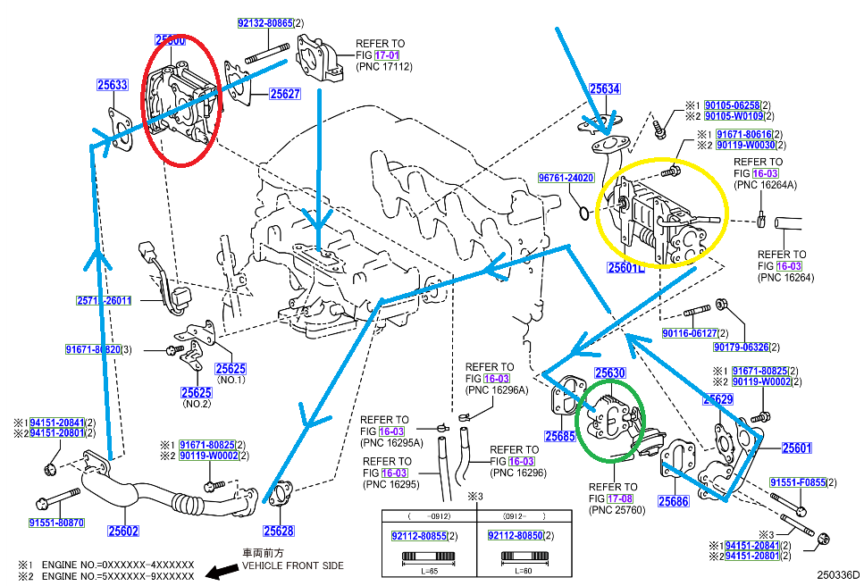

 Has the EGR been blanked off ?
There is also a lot more to the EGR system than Just the Primary EGR valve ( see pic attached ) and a blockage can be further back in the circuit, the gas follows the blue arrows passing first through the EGR cooler ( yellow ) then onto the secondary EGR valve ( green ) then through the cylinder head before coming to the Primary EGR ( red ) and finishing in the intake manifold.
Thanks for quick reply no it's not blanked of had car for first year no problem with car then got car service in Toyota got rear pads changed one day that popped up on dash so bought code reader and that code came up I can erase the fault but it come back drove car on motorway seems to trigger of dash lights when car gets very hot so may be blockage somewhere along system  I think.
