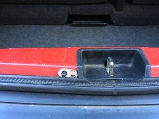

comes this little lockdown project: boot space illumination.
Having located the feed to the dome lamp behind the right rear light cluster inspection panel I was ready to proceed. eBay provided a pair of led tail-light lamps meant for an Audi and a door switch. As the carrier was a it rough with the lamps one was DOA. Once its replacement arrives I will have illumination on both sides of the luggage compartment.

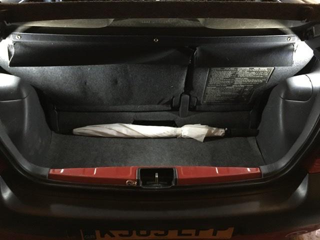

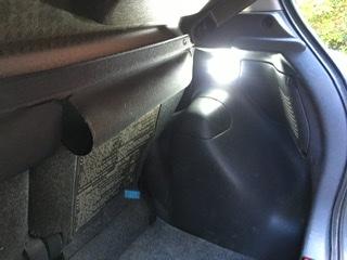

I now have a replacement for the DOA lamp sent last week. Now with illumination on both sides:
