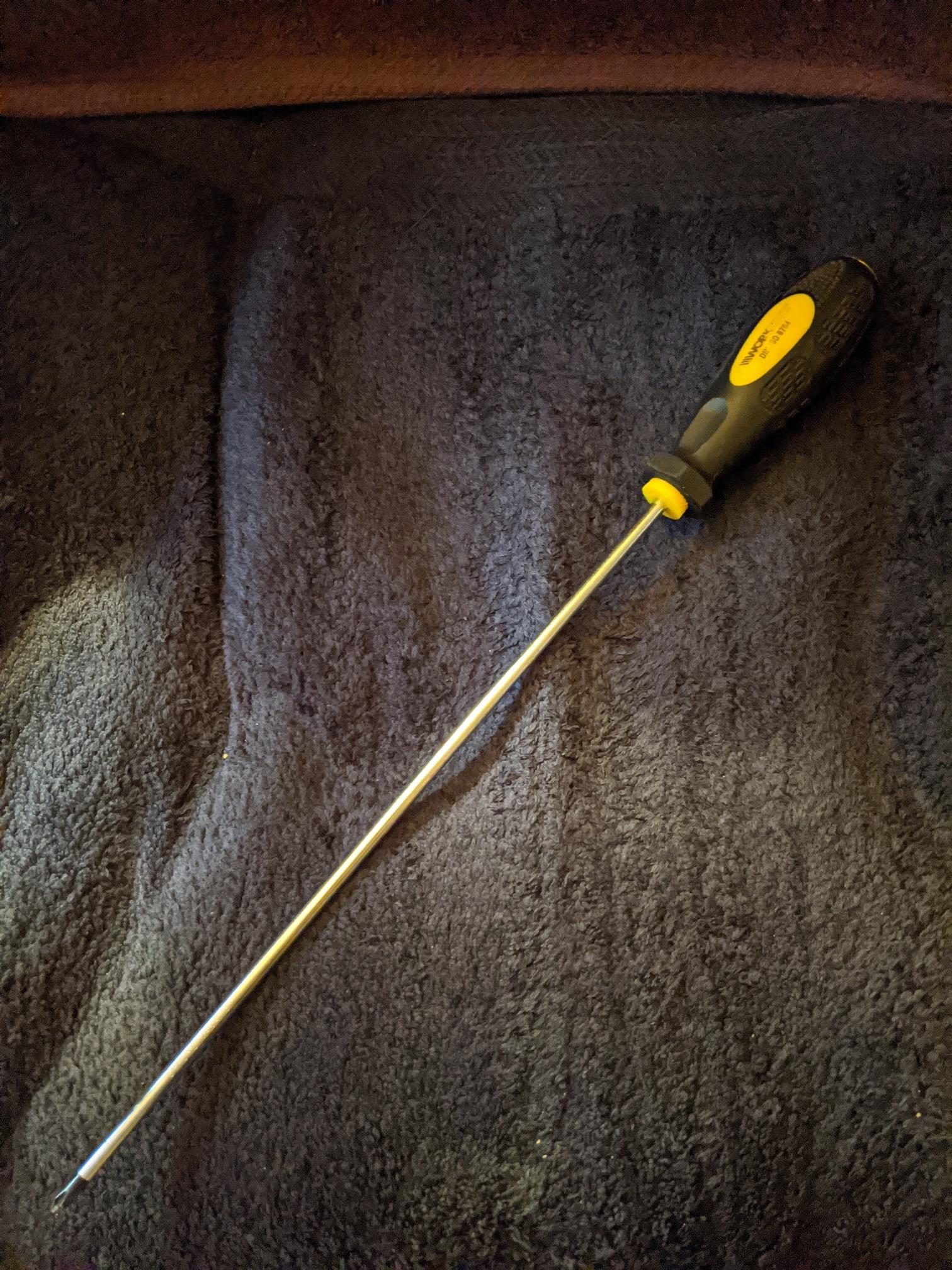

Obviously take care as you'll be near a moving belt but you can try and localise/eliminate either the alternator or the water pump by using a long screwdriver like a "stethoscope" while it is running. Something like this 18" one that I have...
It'll probably be easier to "listen" to the alternator bearing first by touching the tip against its casing (obviously being careful of the spinning pulley and belt!) as near to each bearing (front and back) as you can get and then putting your ear to the handle and listen, You'll soon know if it's that particular item. Be extremely careful when trying to "listen" to the water pump bearing in the same way as there's not much "real estate" around the water pump housing to touch safely! I hope you'll see what I mean. Try a dummy test first safely by trying out your "stethoscope" across the rocker box top so that you familiarise yourself as to how it sounds and actually how localised you can get with it. JUST BE VERY CAREFUL WHEN YOU GET CLOSE TO SPINNING PULLEYS AND BELTS!! Don't just go charging in. Choose your spot carefully!
