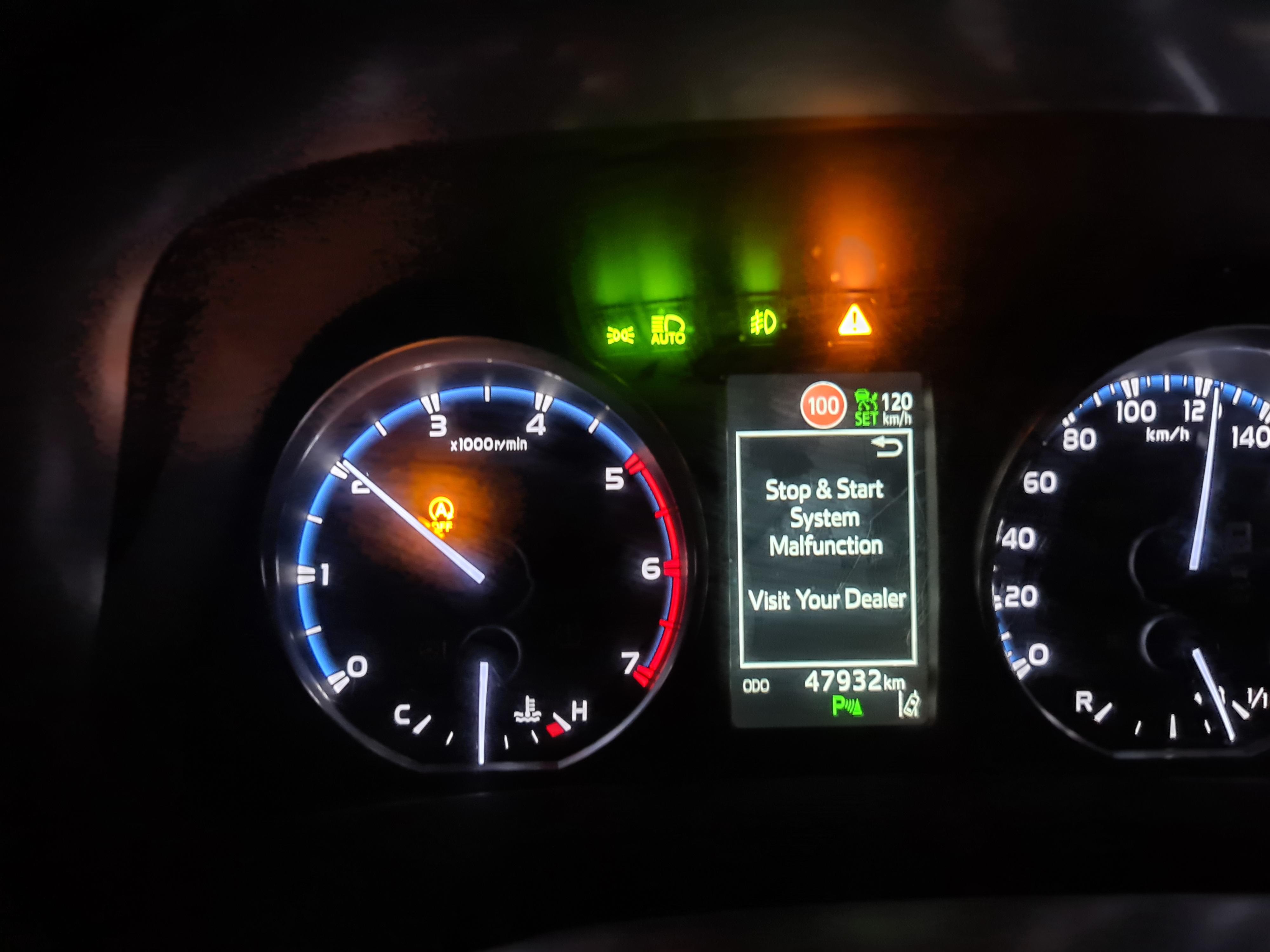

Please see attached photo. Its a 2017 2.0 liter Diesel Rav4
Any ideas? Thank you

Start by charging your Battery on a good quality charger, or alternatively drive a long distance and see if the stop start works again.
roadster-rav you might be wright.  Took it in to the dealers and car is still in. The service manager said it could be something to do with the Battery. Waiting to see what they will say
Dealership says fault code 1862 came up on diagnostics. Both clutch switches were on (pressed) simultaneously momentarily. They say i may have pressed it by mistake with my foot
