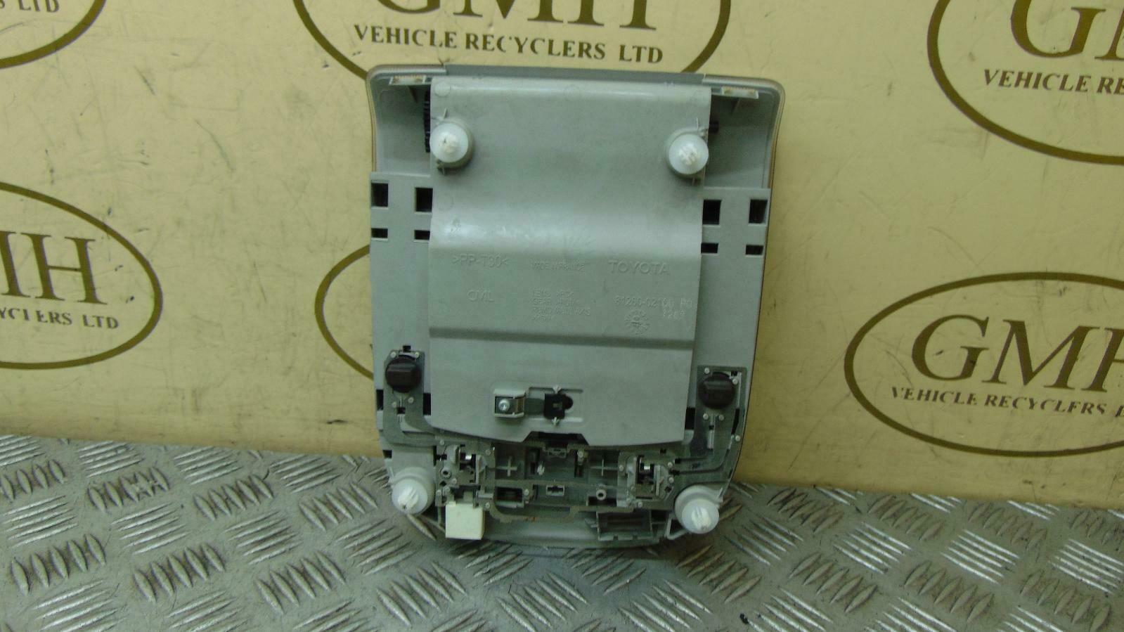

I think i know what you mean now, the interior bulbs use a twist in type bulb holder - you have to pop the whole light down as the bulbs are changed from the top (2 black holders)
Pic courtesy of GMH
