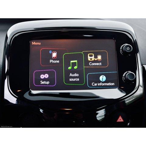

Can you post a picture of your headunit please?
and when i press Connect, it says searching for connection
It doesnt give me any option to pick smartphone or nav

Your headunit is the the earlier x-touch and does not support Apple carplay nor Android Auto it does support Mirrorlink which requires you to have MirroRlink compatible apps installed see HERE
I see.. In the car's book it is mentioned that mirrorlink is supported same as Apple carplay though. Today A friend of mine connected his iPhone x and it worked properly by downloading Appincar. So I guess I'll have to buy a new phone as well!!
