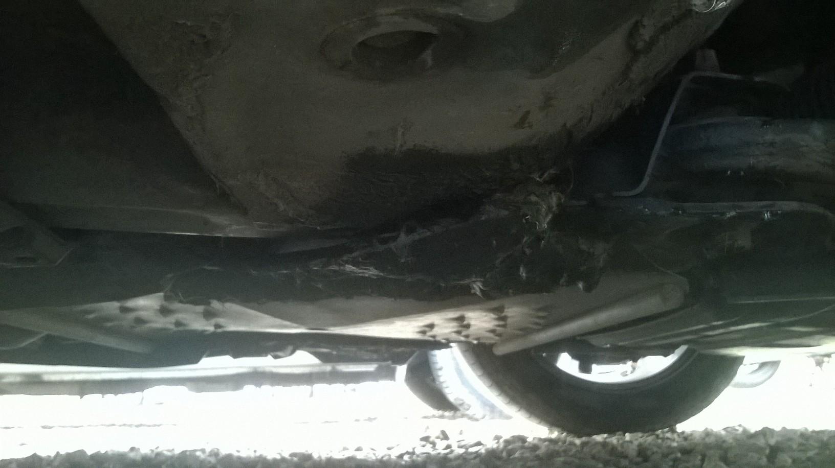

I also have the eBay cover. I had welded added bars to make it harder to cut! A picture.
James.
That's not the same one I bought,  mine is a flat stainless ventilated sheet.  It looks very robust but the instructions state bending down the rear end to clear the cat! It seems like bodgery but ive not fitted it yet. eBay number if you're interested
193351379983
