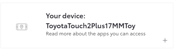

On https://www.toyota.co.uk/ when you go to My Toyota, then MY Vehicles,click on your Rav4 and then you should see the below.
Make sure that the Device is correct. Mine is:
