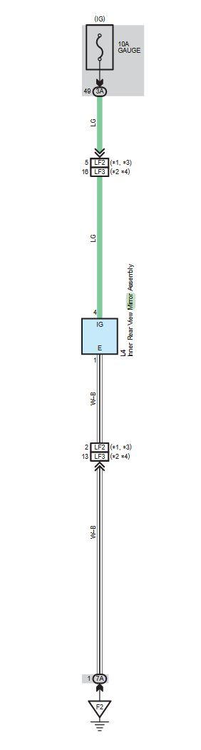

After the success in fitting Cruise to my 2015 Yaris hybrid does anyone know if the wiring is in the headlining to connect a auto dipping mirror from a better spec Yaris ?
i believe its X wires, i can look it up shortly
I have this on my excel it's a very useful feature to have
2 wires. ign (sw live) and ground

Bob Thanks that will be great
87810-0D080 (also fits the verso)
the cheapest one i can find
https://www.ebay.co.uk/itm/2014-TOYOTA-YARIS-INTERIOR-REAR-VIEW-MIRROR-87810-0D080/133143535124?hash=item1efff91e14:g:tMsAAOSwY4pdVXTP
it connects up with a 5 pin connector
the small trim that goes over the top to hide the wires is 87818-33010
only thing i can't tell you are if the mounts are different

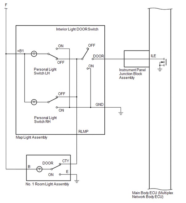

Have you got the wiring diagram for that stoopid little interior light.  I’ve upgraded the bulbs to led which sorts the front but I’m determined to add something at the back.  It’s got a door and a permanent feed so I could do with a little look.
I don't have much info on the newer cars, but it's not simple as it's all controlled by the B-ecu (BCM) the door switches all go into the B-ecu it then outputs to the lights
a rear light usually comes off after the switch in the interior light
Interior light - 81260-K0060
rear INT light from a C-HR
Room lamp assy - 81240-02080 - they come in black, grey or light grey
eg. https://www.ebay.co.uk/itm/394371821346

Thanks for looking Bob.  That’s not quite the same because the two lights of the map light are also the room light so I guess there’s a PCB with diodes.  I’ll go on the Techdoc and have a look when I get chance.  👍
