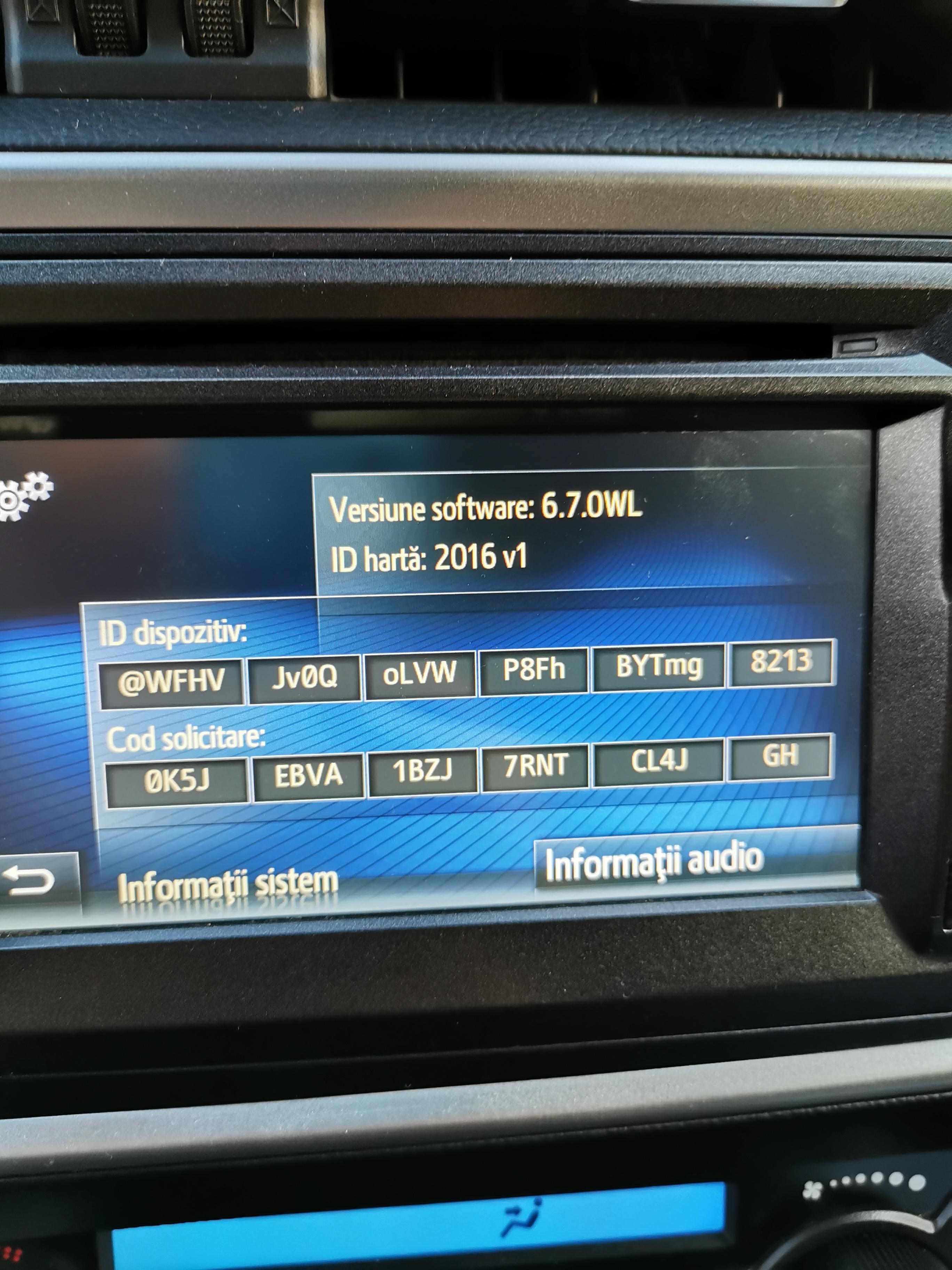

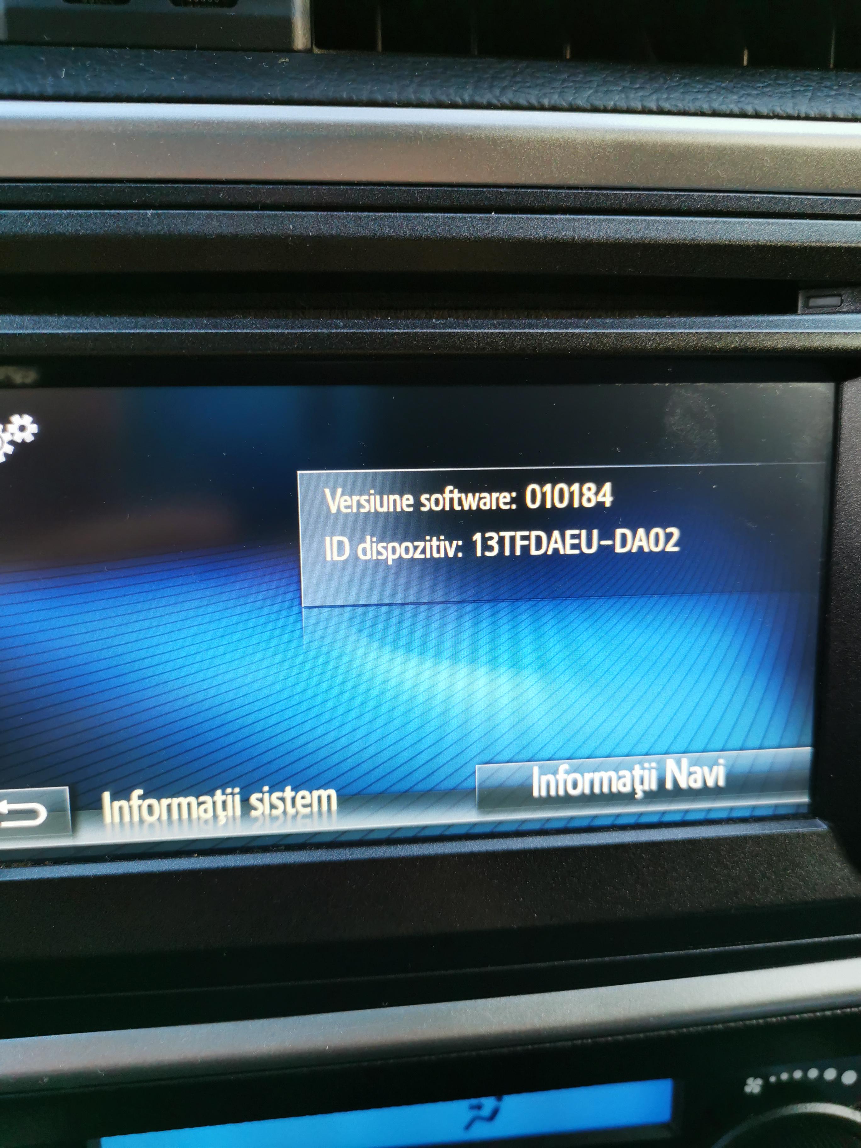

I have a problem with music play , IT say bluethooth error but the phone calls working , the problem appear after upgraded the phone to Android 10 (I think don't know for sure but it was immediately), some times just working let's say from 10 connection 2 it's working didn't find a pattern . What I try : Samsung S8 (Android 9) working no problem , iPhone 8 / se2 / xr working , Samsung a5 Android 9 working , I'm on Huawei the phone came with Android 9 working flawless 2-3 months , then I upgraded to 10 and stop working . What I'm looking now it's some free method to upgrade the unit (don't care about maps) I attach some info . Any tips / advise to try?
There are head unit software upgrades but the latest version is dated 02/2016 pre dating Android 10 so its unlikely there would be any fixes.
With "GO" navigation installed the nav ECU handles the bluetooth and software updates for the Nav ECU are bundled with map updates the latest being 6.15.0 issued in May 2020
