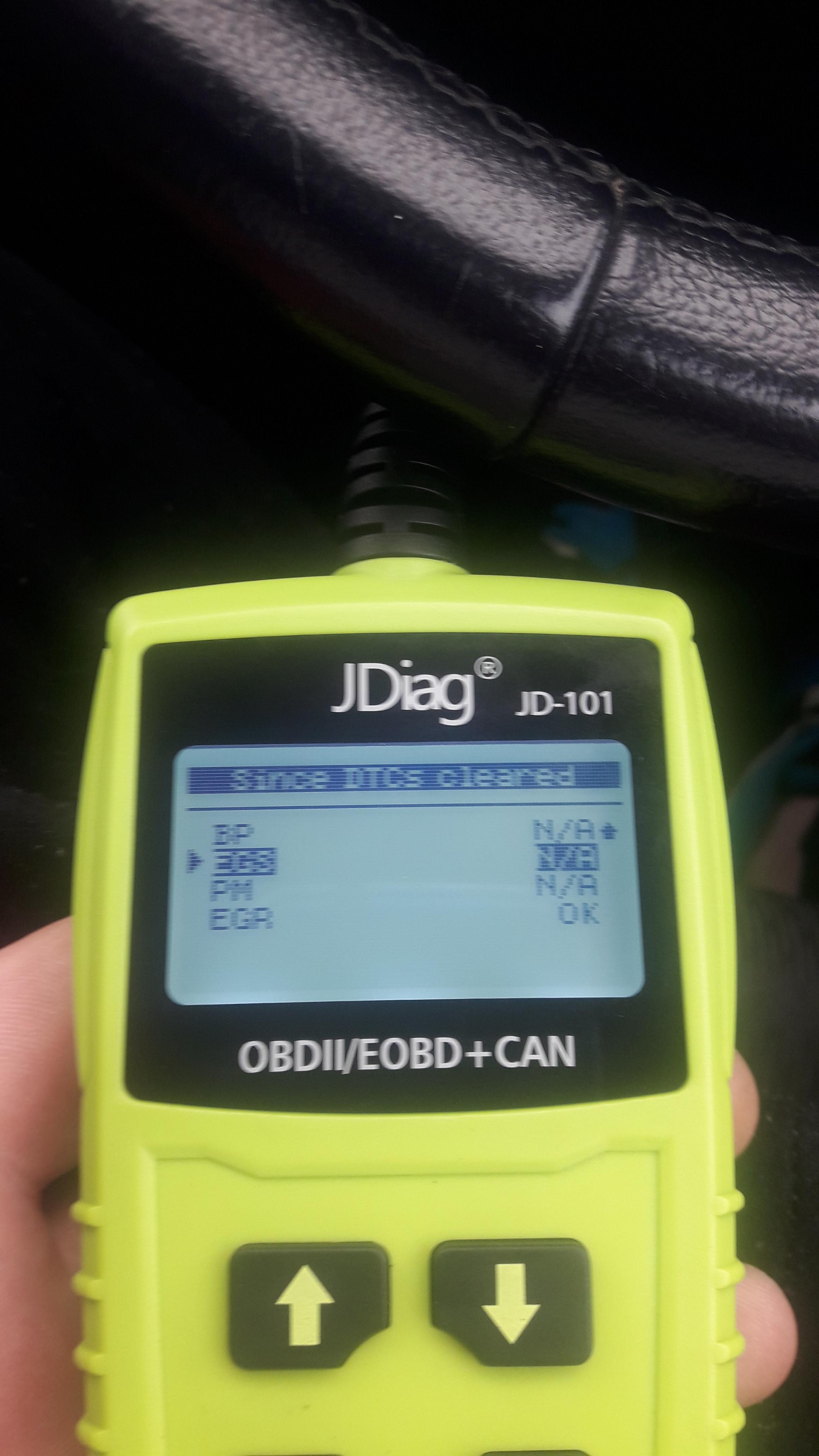

So I got Bosch air filter for my d4d and its solved the vsc system parking brake fault other air filter was Amazon blue print that was fault it wasn't properly fitting but new filter fits perfectly so as far as I can see problem fixed my 12 plate avensis d4d
