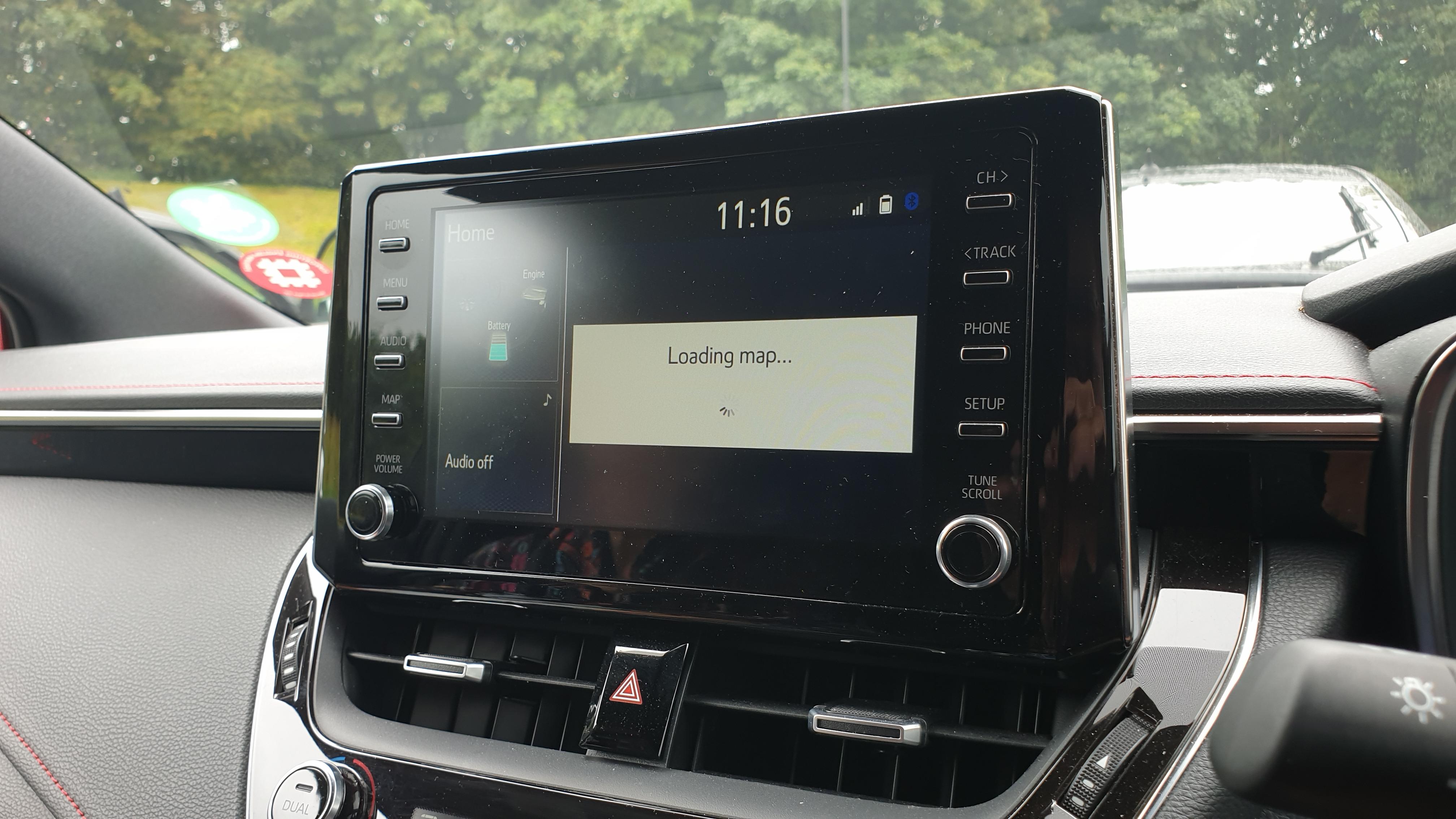

Although I've had the same problem a few times in the past, since Friday every time I drive my 2019 TS 1.8, after a short time the map goes off and I get the "loading map" whirly thing on the display. There's no way to get rid of it other than stopping & restarting the car. Also the clock freezes on the infotainment & dashboard. The voice commands for sat nav just says "not found" or similar though I can select music. It also happens if I've turned my phone off, so that isn't interfering with the system.
Anyone any idea what's wrong?
The audio = 1011, Navigation = 1530, Navdb_version = 2019v2, the DCU = 17TDT2EU-DA01 & MEU = 17TMT2EU-FA00
The picture was taken an hour after the clock time at the motorway servicesimageproxy.php?img=&key=567b4e06530f0081
