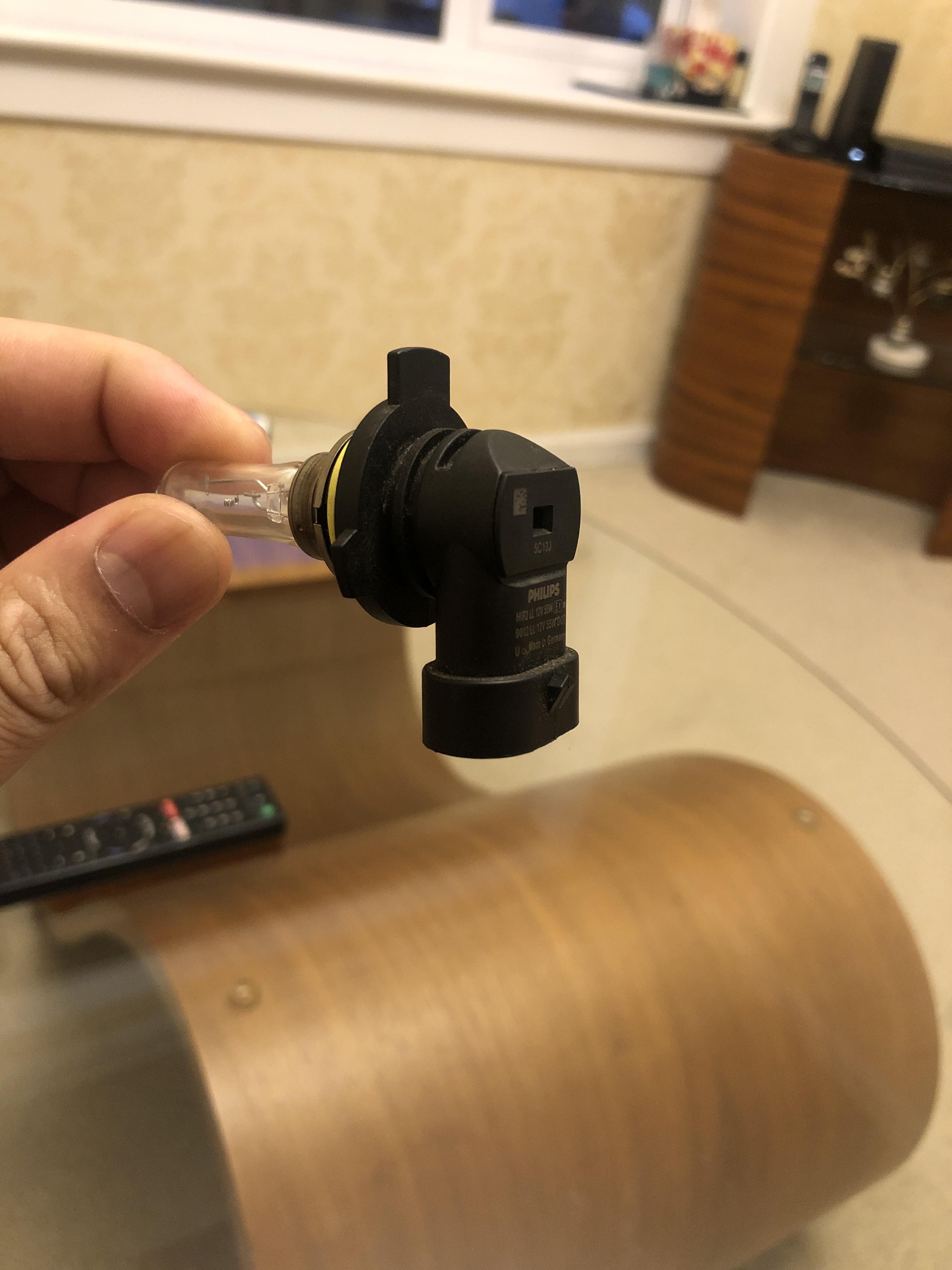

The bulb on my aygo has stopped working. I’ve removed it and it’s a Philips 55w bulb. The only one I can find online is an Osram one but I’d rather fit like for like.
Do I need to go Toyota direct?
Also has anyone used Philips white vision bulbs and do they provide a good upgrade?

It’s an old broken bulb - why no touchy lol.

Mixing the brand should not be an issue however the new bulb will likely be brighter/whighter than the old one opposite, Toyota do offer an upgrade Optiwhite bulb set for cars fitted with HIR2 bulbs part # 90981-YZZDN £46.79 for the pair
Hey Devon, the upgraded part sounds worthwhile. Have u tried it?

Wrong bulb fitment. You need HIR2 (9012) bulbs.

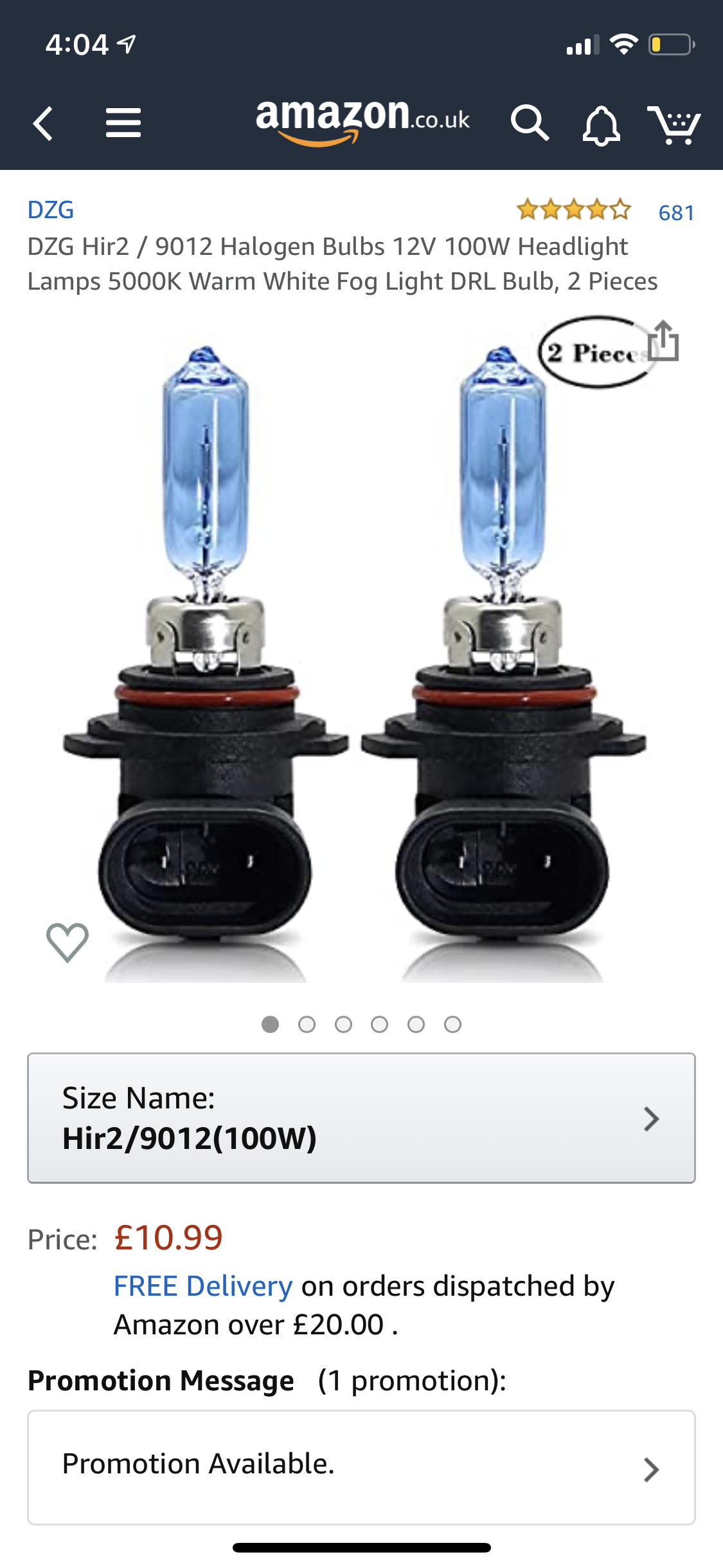

Just found these on Amazon. Reviews seem good and they’re priced well for a set - anyone used them?
They are 100w so maybe not road legal. Also it would be hotter and the wiring might be an issue. Although years ago I bought a ford which the previous owner fitted 100w bulbs that I was not aware of, no heating issue.
