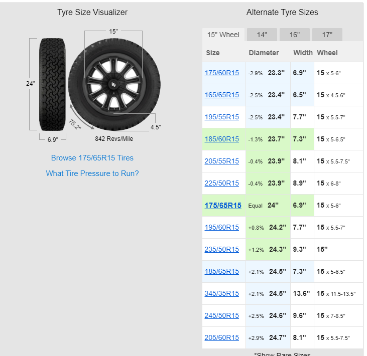

hi,does anyone know if 195/50/15 will be ok for my toyota IQ,thanks?

Assuming the originals are 175/65/15 then no it would too far away from the original to keep your speedo correct and your ABS/VSC happy see:
