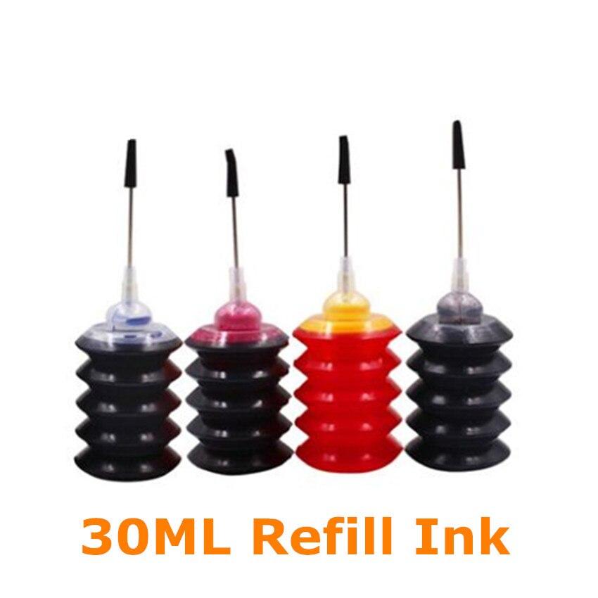

One of these ink jet printer refill bottles (if you're lucky enough to have an old one) makes a useful precision oiler when refilled with engine oil - good for keeping boot hinges lubricated without dumping oil all over the place.

Great tip regarding the ink refillers, might have some luck finding some at the office. If not, I think I might get ahold of a syringe or something.
The top section removes from my ones, which makes then easier to initially clean out (fiddly) and refill.
