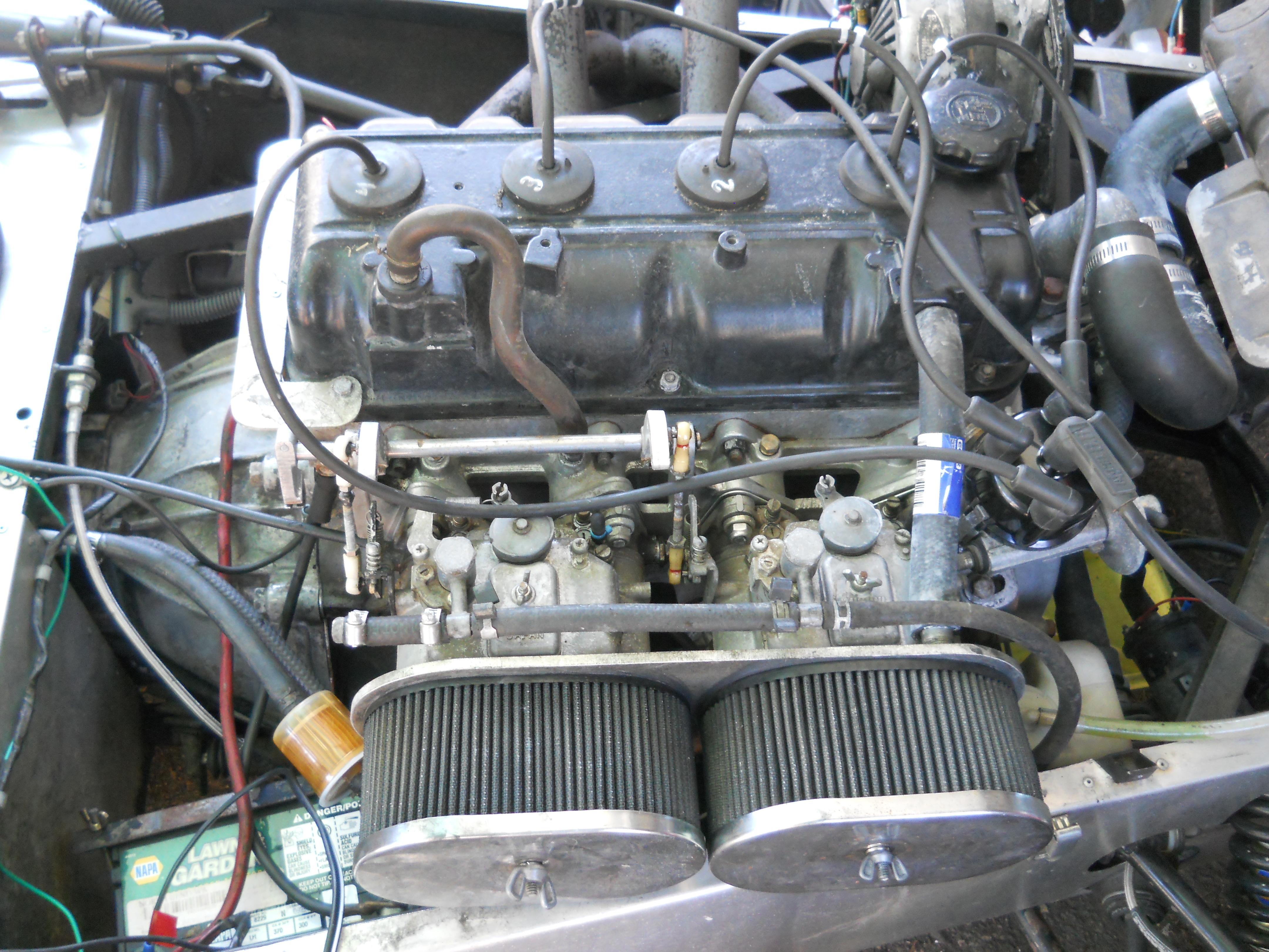

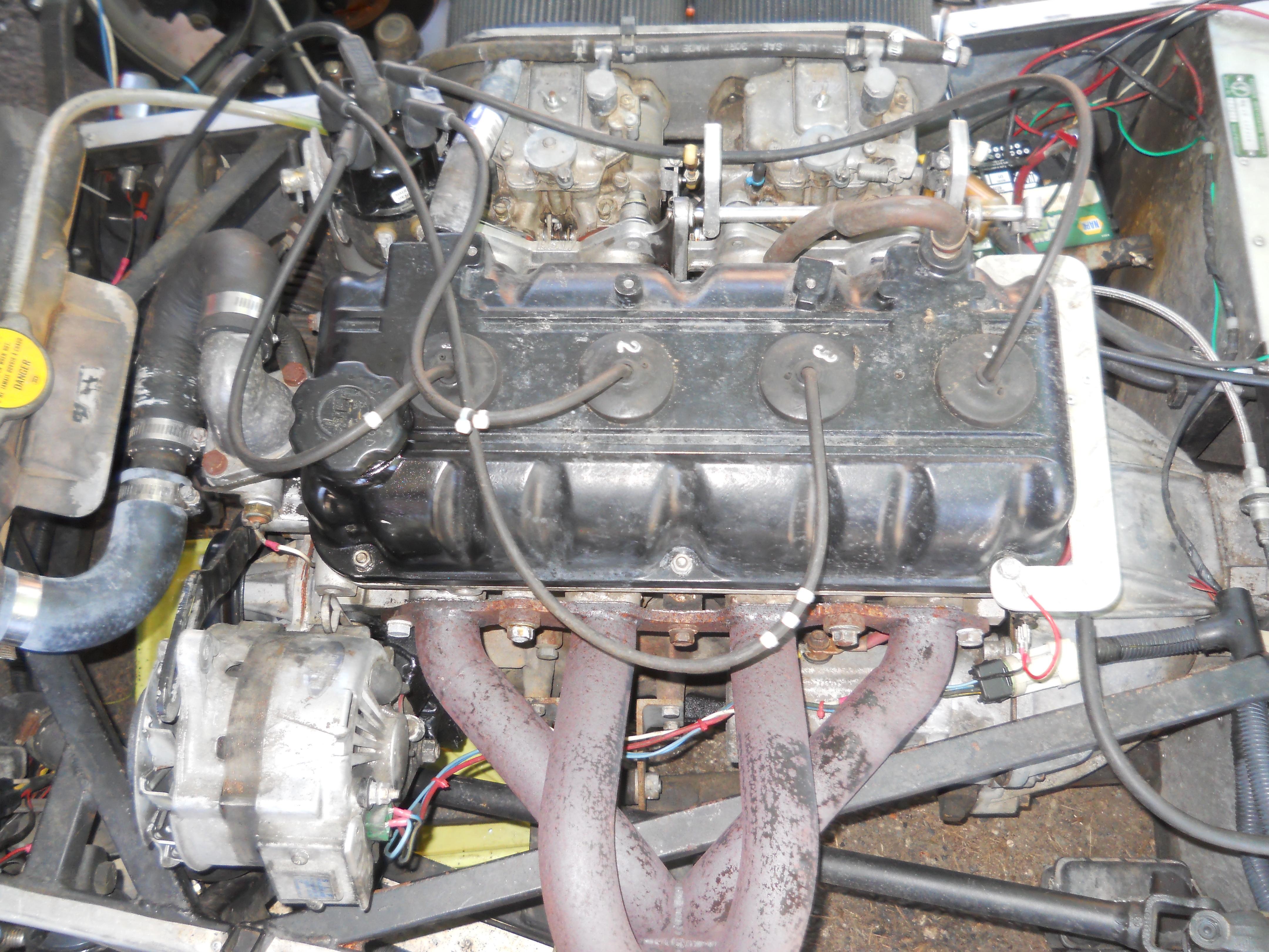

Just purchased a 2006 Lotus 7 kit car.  Engine/drive train is Toyota but I can't id the particular engine series.  the timing chain cover # is 11321-28010.  I will attempt to insert pictures.  Any help would be greatly appreciated.

Possible a e series engine from toyota
Sent from my Pixel 2 XL using Tapatalk
Its late 70's early 80's - 2T 1600, 3T 1800 or 3TC, probably from a Celica, Corolla or Corona
Gearbox wise W40, W41 or W50
Hope that is of some use
