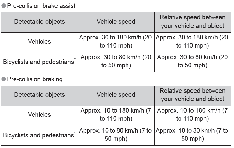

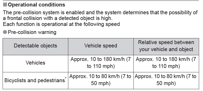

To be honest I'm a little uncertain as to how the system reacts, the manual doesn't really explain it very clearly. (page 346 onwards)
Is there a simple safe way to test that the system is working?

Oh so its not specific to bikes you mean then ?, TBH I have had a similar system in my last few VWs and TBH unless you or someone else is doing something silly then it won't go off, I probably had it go off three times in my VW and then was usually when overtaking and the system getting slightly confused why I was going so fast whilst approaching a car etc.

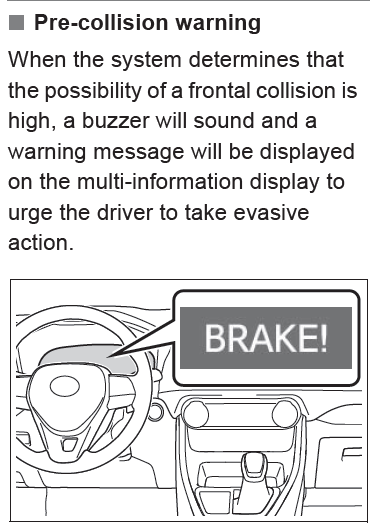

Funnily enough I had the 3 beeps and BRAKE warning come up yesterday when I stayed in lane with a parked vehicle in front of me and moved right late to miss on oncoming car.  The car didn't need to apply the brakes, but was getting ready and warning me I needed to do something.

Another reason I miss the modern instrument layout and Head Up Display of my last Prius.  The brake warning (along with others like "you're about to drive off the side of the road" [paraphrased!]) would appear in big black letters in a large red box in the HUD, and also in the instrument cluster which was way ahead just under the bottom of the windscreen - much easier to see both when looking straight ahead.

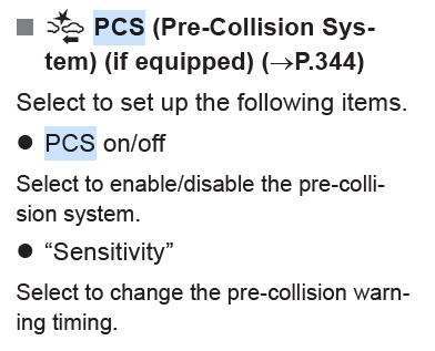

Dont forget that the pre collision system has three settings. If you have the car on the lowest sensitivity, it wont intervene until it thinks a crash is very likely.  The highest sensitivity will warn you to brake much earlier.

Where are said settings. I have the PCS on and Off option but cannot find sensitivity option.
Sorry, maybe I was unclear. You can change the sensitivity of the warning rather than the system itself (page 347).
The PCS will always do its best to avoid a collision within the limits of the system.

Yes undestand that trouble is I don't have the PCS sesitivity setting as per the manual. so not sure if Icon has that option or not. its not clear

When PCS is selected,  hold the ok button down for three seconds and then the sensitivity settings will appear
