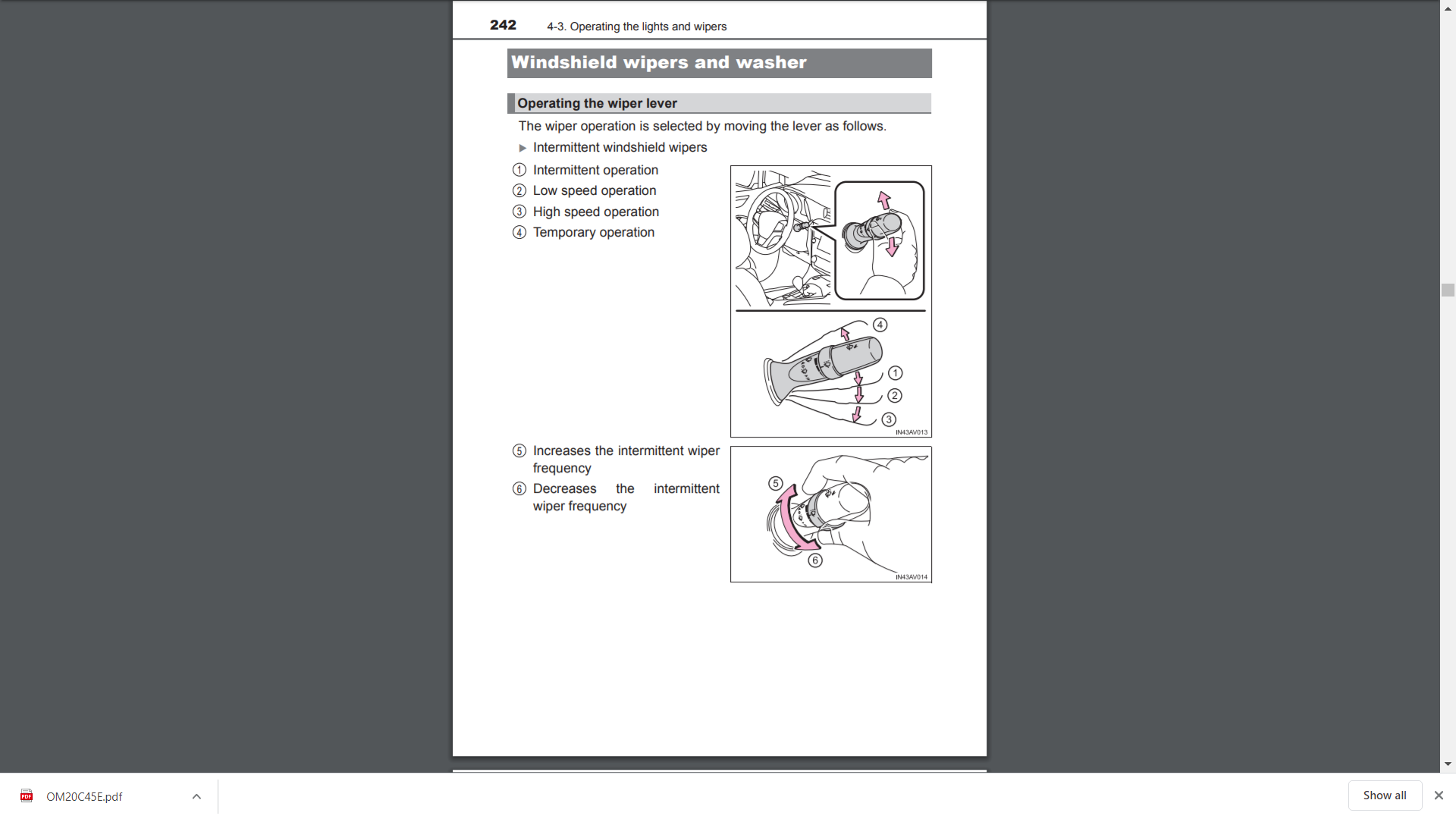

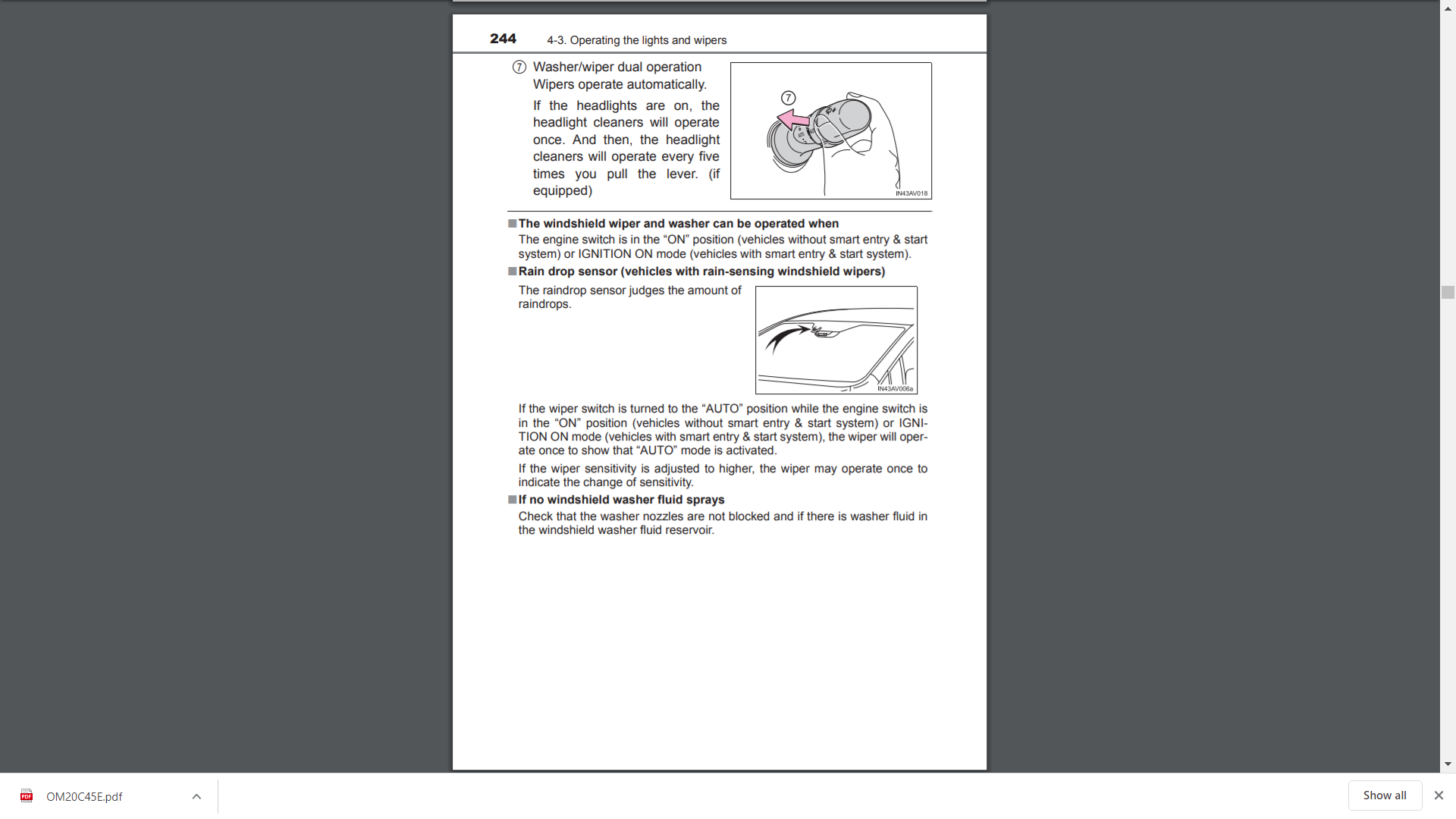

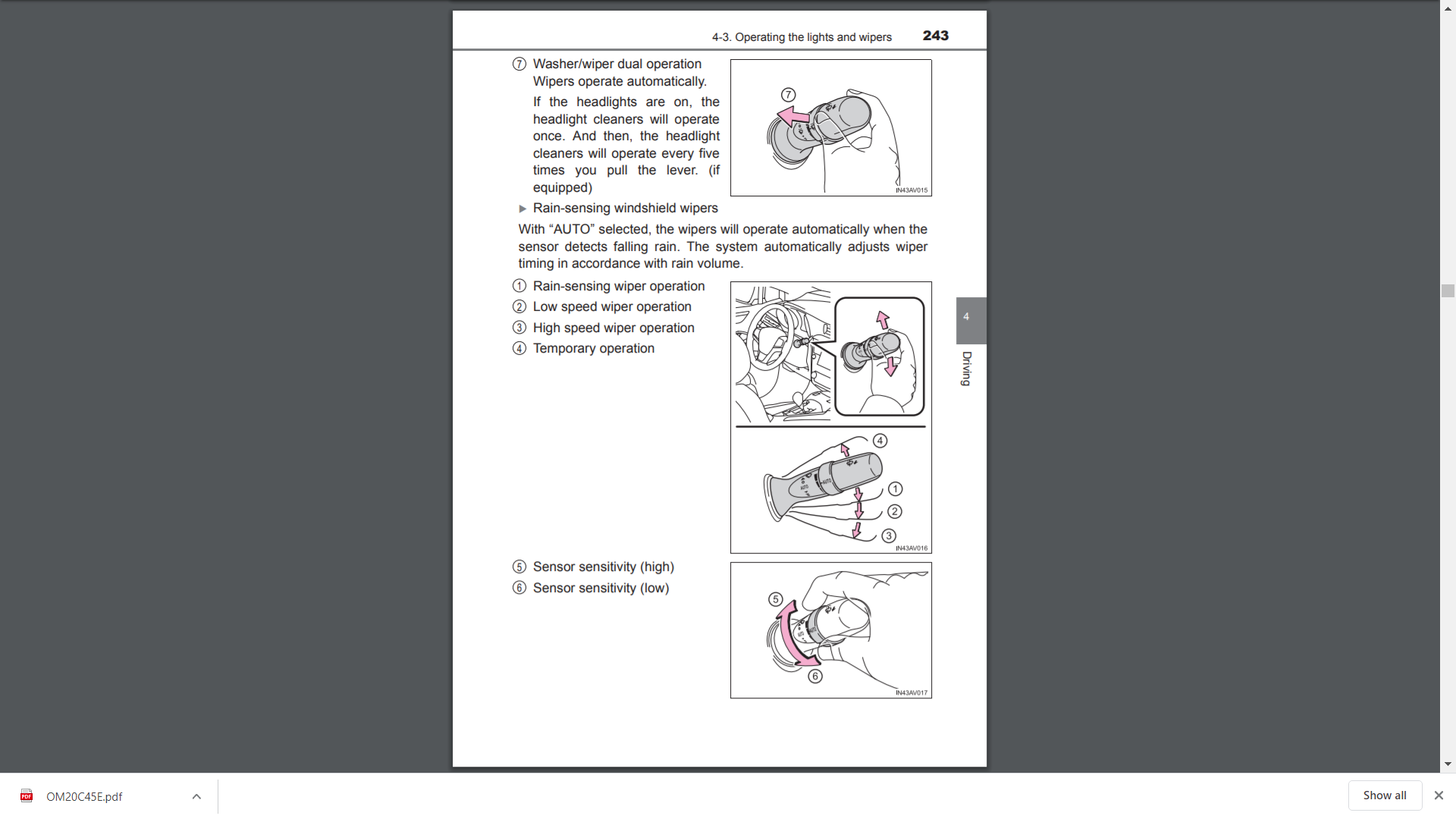

I assume you switched the wipers to off position from auto? Make sure there is nothing on the windscreen sensor, by cleaning the windscreen. The following are from the owner manual.
