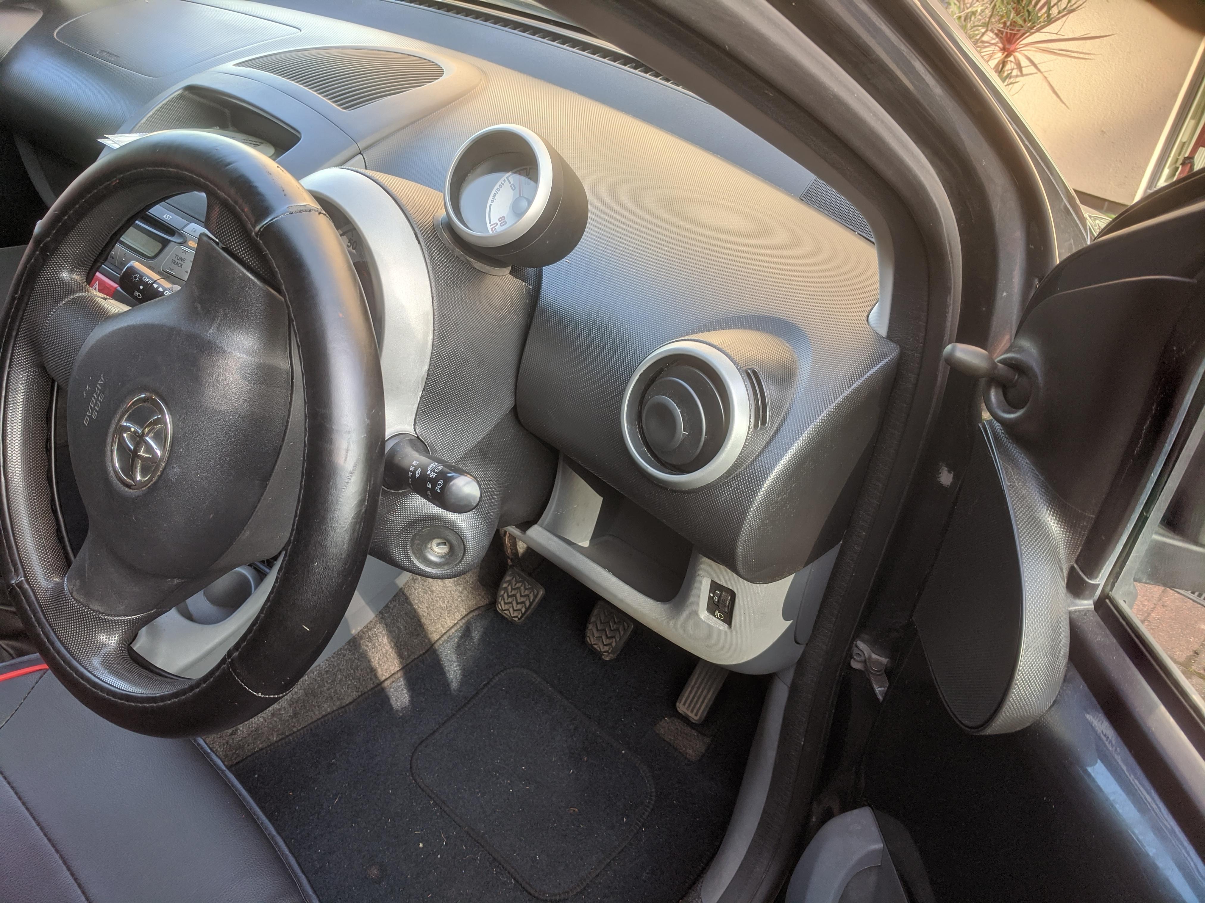

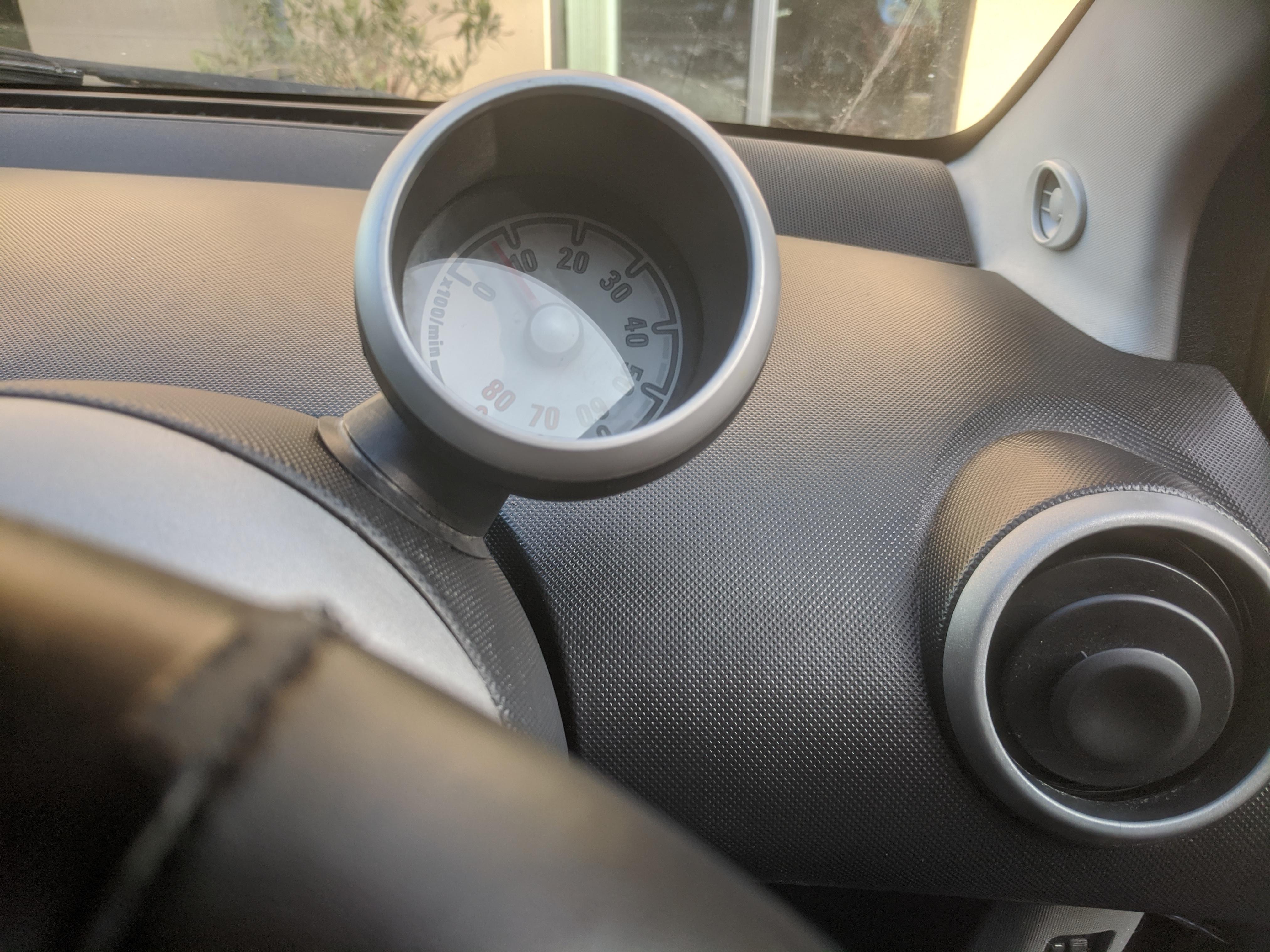

Hi all, didn't fancy paying £60/70 for a used rev counter for my 2005 Aygo, so bought a Vauxhall Agila one for £10, all fitted, working and doesn't look out of place. Unfortunately can't get the illumination light to work, only when side/headlights are off, soon as I switch sidelights on rev counter light goes out.  The Agila has 5 wires compared to Aygo's 4. Anyone have anyideas please.

Good mod that. Been thinking abut one for daughters car. Did it come with the pod too?
Had to cut a 1" x 4/5" slot, not noticable. Had to remove silver pod bezel to get pod in and then clip in.

Agila plug has 5 wires, Aygo 4, had to cut both and fit new 4 pin plug.
