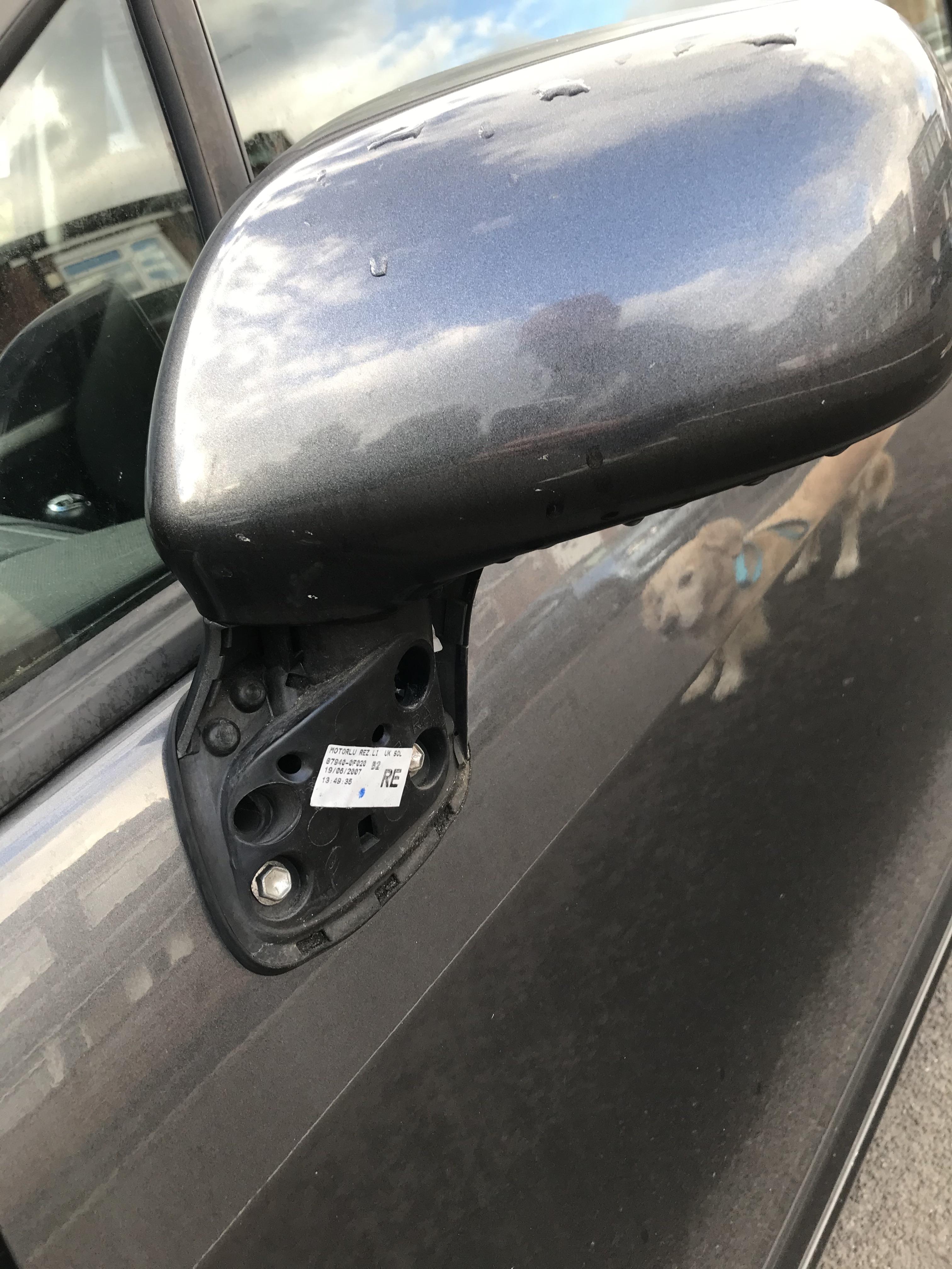

Hi all, I've had the unfortunate event of losing a piece from my wing mirror arm, not sure if someone has nicked it or it fell off... either way, I'm struggling to identify the actual part name so I can hunt one down. Can anyone help me with a name for the missing part or even better know where I can hunt one down? As you can see in the pic it is just the plastic cover.
I have a Toyota Corolla Verso 07 plate
Thanks guys.

Looks like you are looking for a left hand side lower trim piece.
Found a link to a rhs piece, but you might try contacting the seller to see if they have a lhs piece
Why not try your local Toyota dealer  ...?
£25 on eBay sounds a  lot  for a used part ?  though perhaps Toyota only sell it as part of the whole wing mirror ? so ask them first ..
There are lots of options as the part can be purchased colour coded also there was a part change in 05/2007 (looks like paint colour)
87945-0F010 (10 colour variations)
87945-0F010-B1 Grey 1C3 upto 05/2007 Retail £43-50
87945-0F010-B2 Grey 1G3 05/2007 - 02/2009
