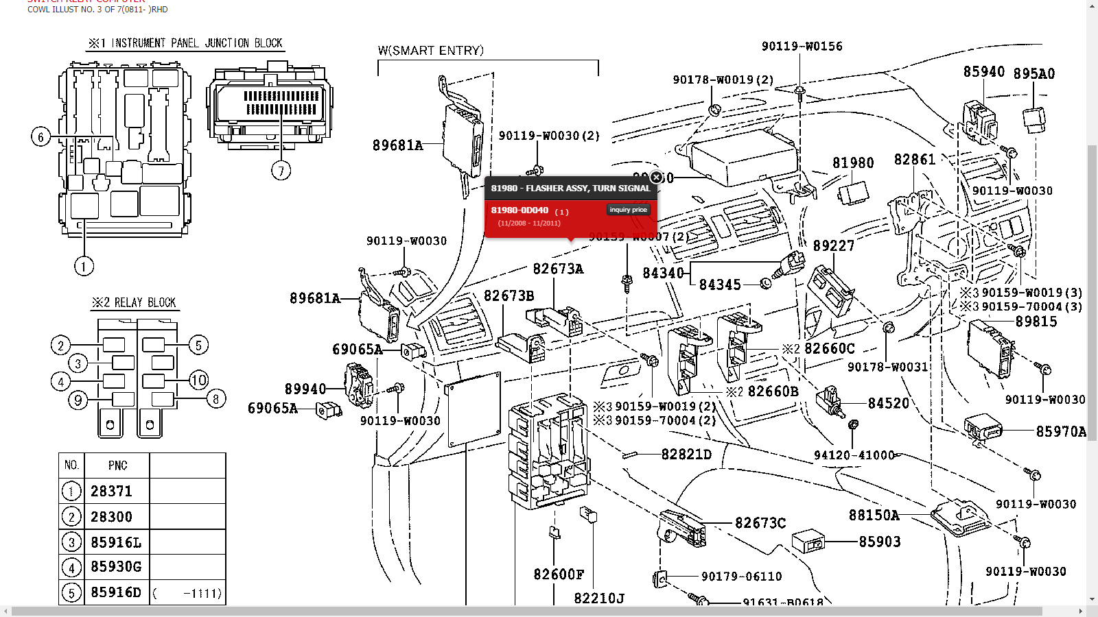

When you say the 'indicator flashing unit is rapidly clicking', do you mean the clicking and and indicators are flashing at a faster rate? Also does this happen on the left side, right side or both? Have you checked the bulbs all around? The front and rear bulbs are standard, whilst the mirror repeaters are LED.
Anyway the part number you are after is 81980-0D040, as shown in the following diagram.
I think this is what you are looking for -  image.thumb.png.f01fa37385dd55b03460d0566eaa3e8c.png
http://www.japan-parts.eu/toyota/eu/2009/avensis/zrt271r-awfepw/2_273560_041_410W/electrical/8401_switch-relay-computer/3#81980
