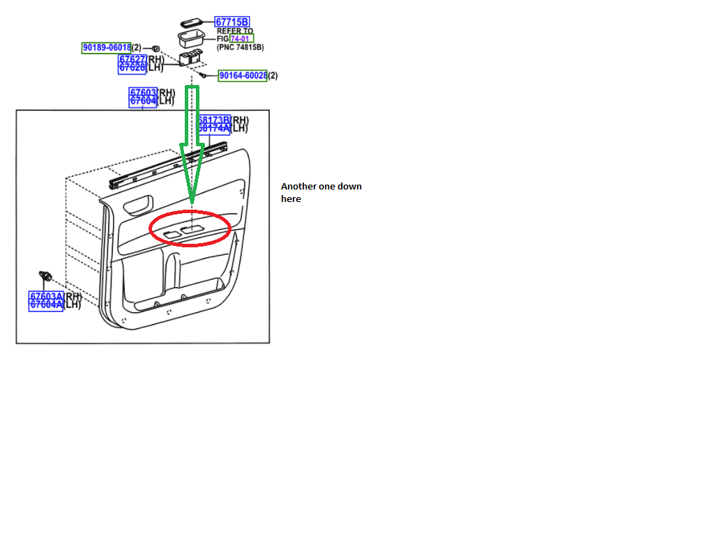

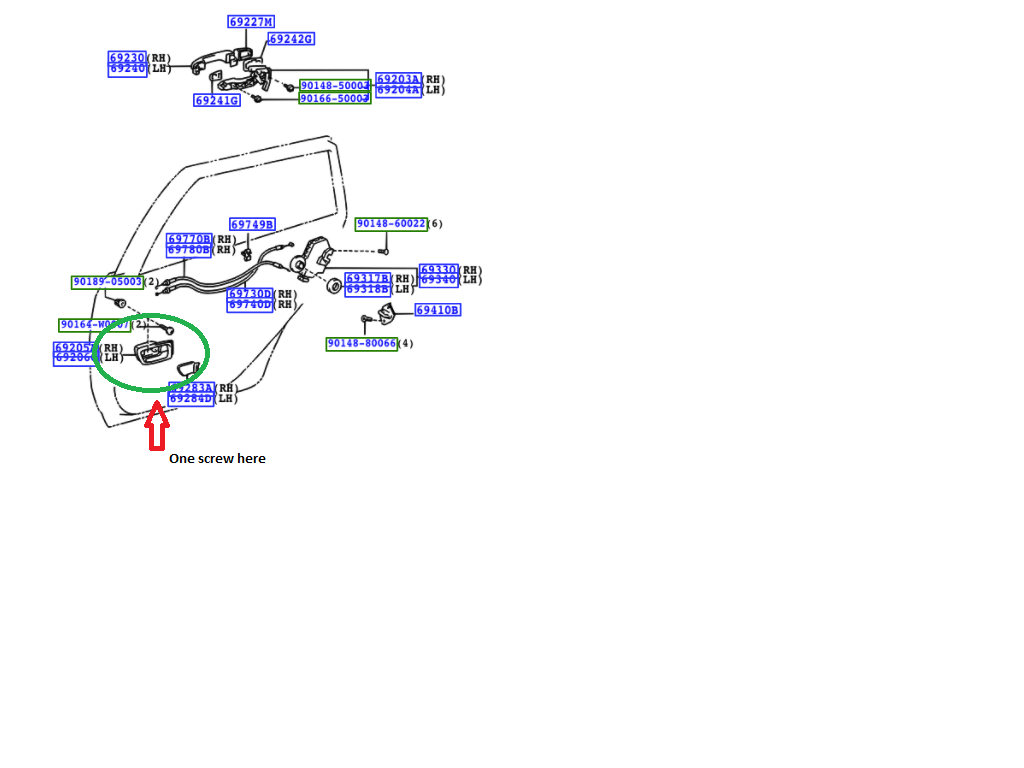

There is a screw behind the the door opening handle and another down inside the door pull handle:
