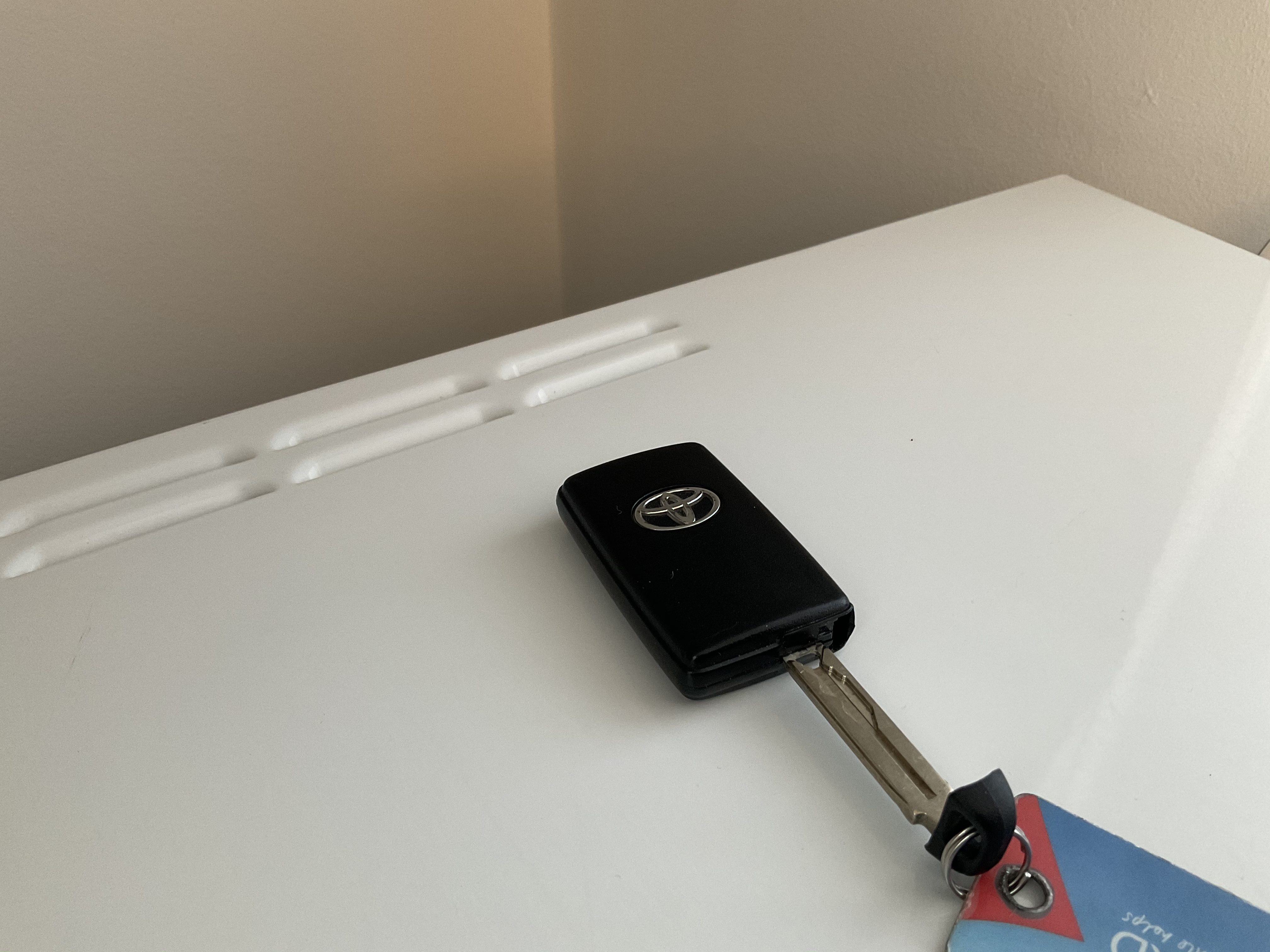

You can take the lead through window and shut the doors as usual and lock them with the service key build into your key fob. No need alarm just to keep the car secure.
Given that the alarm is automatically on & activated, wouldn’t an open window with lead & potentially wind or rain through it trigger the alarm?  I’ve never attempted to turn off the alarm - is that in the handbook?
If you lock the car with the key instead you ain’t activating the alarm so no worries here, just close the window up to the cable.
