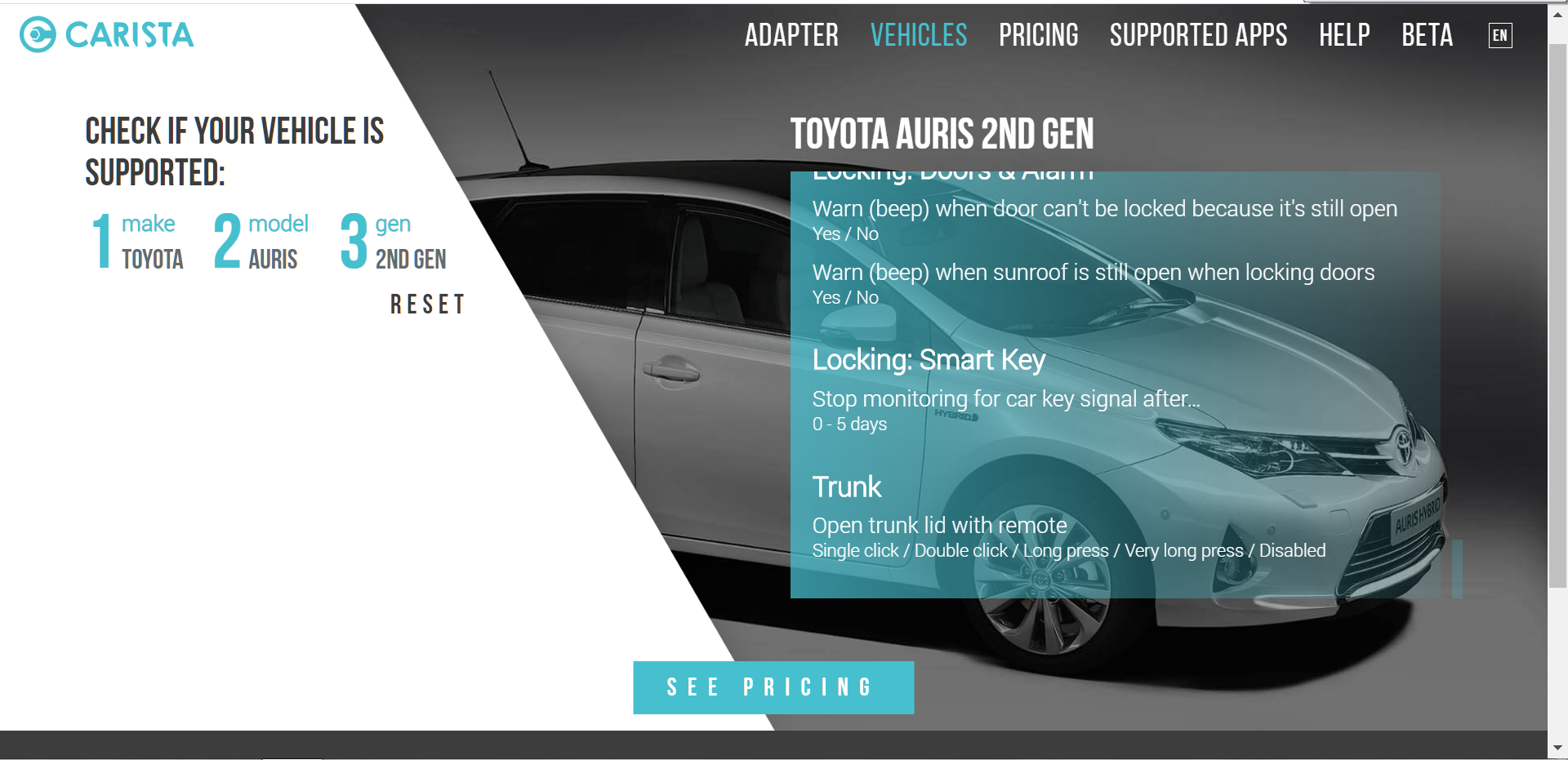

Perhaps there is a chance that the car locking is mode is set in a particular way, (I've not investigated this menu on our car) and this isn't actually a fault, like here:
In the Carista phone app:- https://caristaapp.com/vehicles/toyota/auris/2nd-gen  They give a list of customizations that are possible, but the list may include items that are only configurable in other, non-UK, markets.
On the page for your car, it lists these options :-
If this app lists a mode as doable, then I would think this is also configurable through the Toyota Techstream software that the Toyota dealers use.
Perhaps someone knows if this list is correct?

I have also checked and is not a customisable function either by driver or dealer.
Thanks for the info!  I can’t remember it doing this when I first got the car, that’s why I had it down as a fault! It’s a pity there isn’t a reprogrammable fix for it, but knowing it’s not a fault is reassuring! The only fault on this 2013 Auris was the A/C condenser developed a leak! It’s Still got the usual Toyota reliability!
