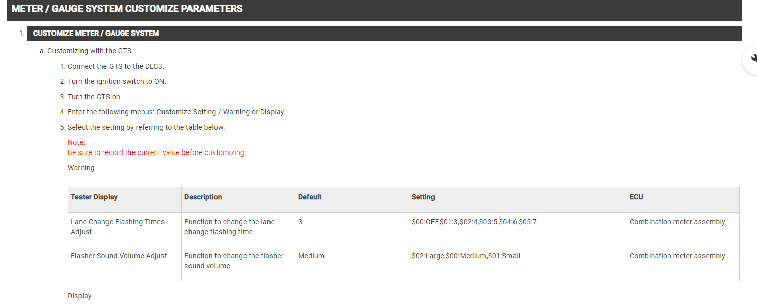

Toyota say that the parking assist kicks in with the rear cross traffic alert setting. It doesn't work on my wheely-bin.
Also, from another post, the turn indicator sound level cannot be adjusted.

Which Toyota, your dealer or Actually the brand?
page 427 of manual attached describes the PKSB function and how it works, can be switched on/off. It is not part of the RCTA system
Indicator sounder volume can be adjusted but only by dealer:
Contacted Toyota from Toyota web site.
Saw the PKSB in the manual, but it doesn't appear to be part of the cars package, 2020Rav4 excel AWD.
Tried local dealership, Norwich, but very little luck with the indicators sound level.
