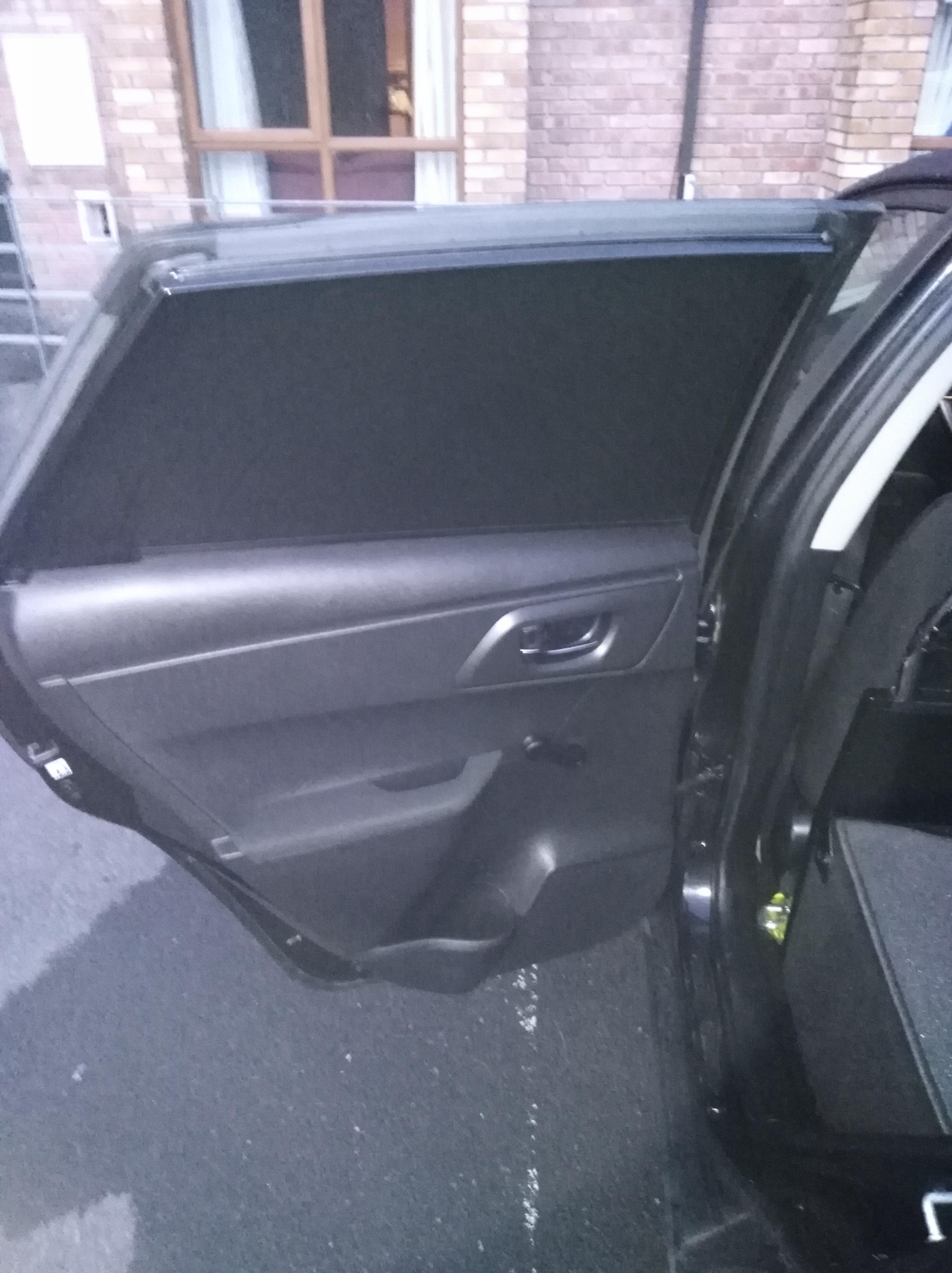

inserts ? its the same as the car the rear quarter glass is bonded in place or do you mean the interior, a picture may help
I mean interior, rear windows have black covers over windows ,I want to tint them instead as reversing from parking space you are totally blind .it's an auris configured as terra van
If they wind up and down, it more than likely a film on the glass, wind the window down and you should see the film, it comes off by carefully heating the outside of the glass and peel it off
otherwise swap the glass out
The Auris Van conversion is known as a N1 you don't see many in the UK
https://www.toyota-tech.eu/aimuploads/8f04003a-17f3-4584-8505-d4cbdd9a31d6/Auris_Conventional N1 kit TDK_PZ449-E5E30-00_AIM 003 230-4.pdf
Edit. fit a reverse camera ?
