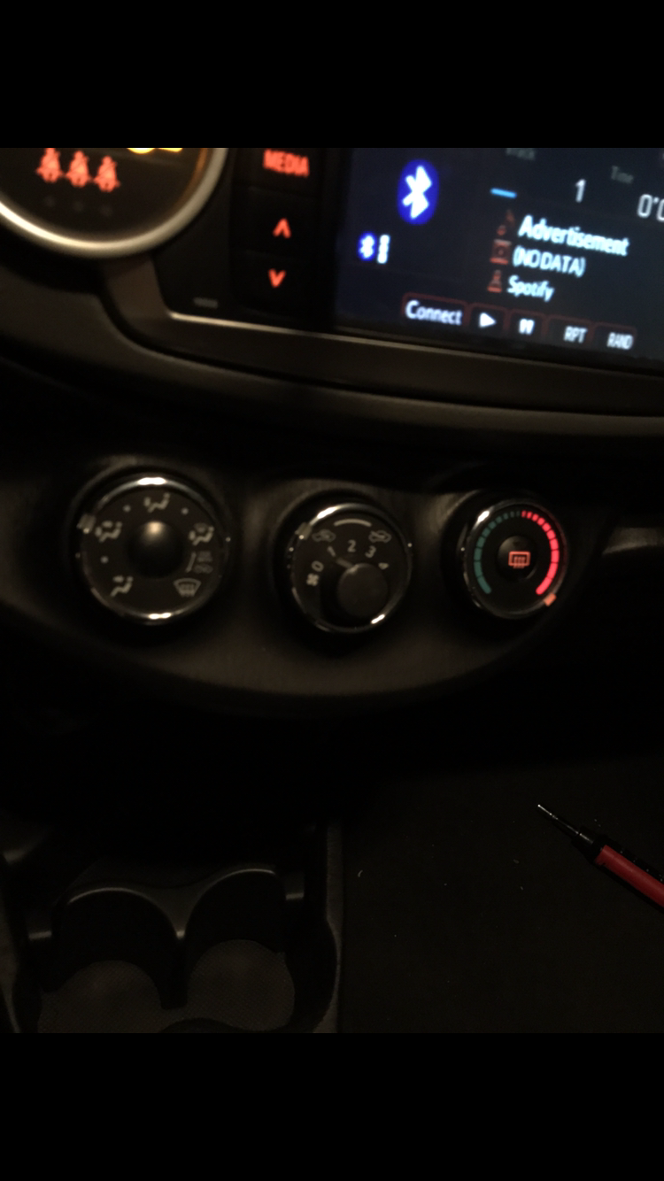

Hi, the small bulbs needs to replaced, anyone know where to buy them or got a link for them/know what type of bulbs they are.
Are you in the USA/Canada ?
the trim simply unclips from the dash using a plastic trim tool
90010-01145 should be the right part, iirc T3 (8mm round base) is the led replacement
im in europe, but thanks for the link, i was confused as to what size t3/4/4.2/5 etc.
