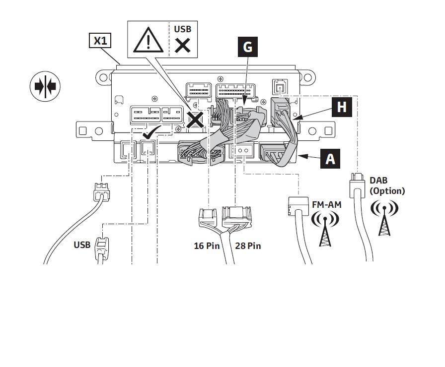

Thanks mate, its got the main cable G is attached but there appears to be another small cable H in the picture thats missing.

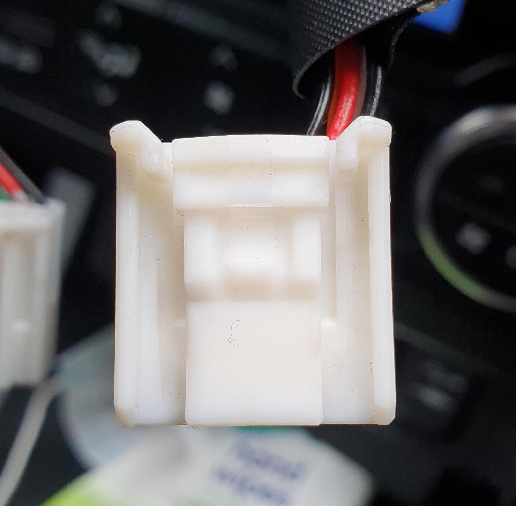

I was left with this wire (see pic), nowhere to fit, any idea what this is for?
Also the radio was hissing even when I pressed radio off knob, is wiring loom is different for Touch 2?
Regards
The loom should be the same, did you have the aerial plugged in ?
16 pin is for the aux in/usb and comes from the multimedia interface the touch2 has this built in

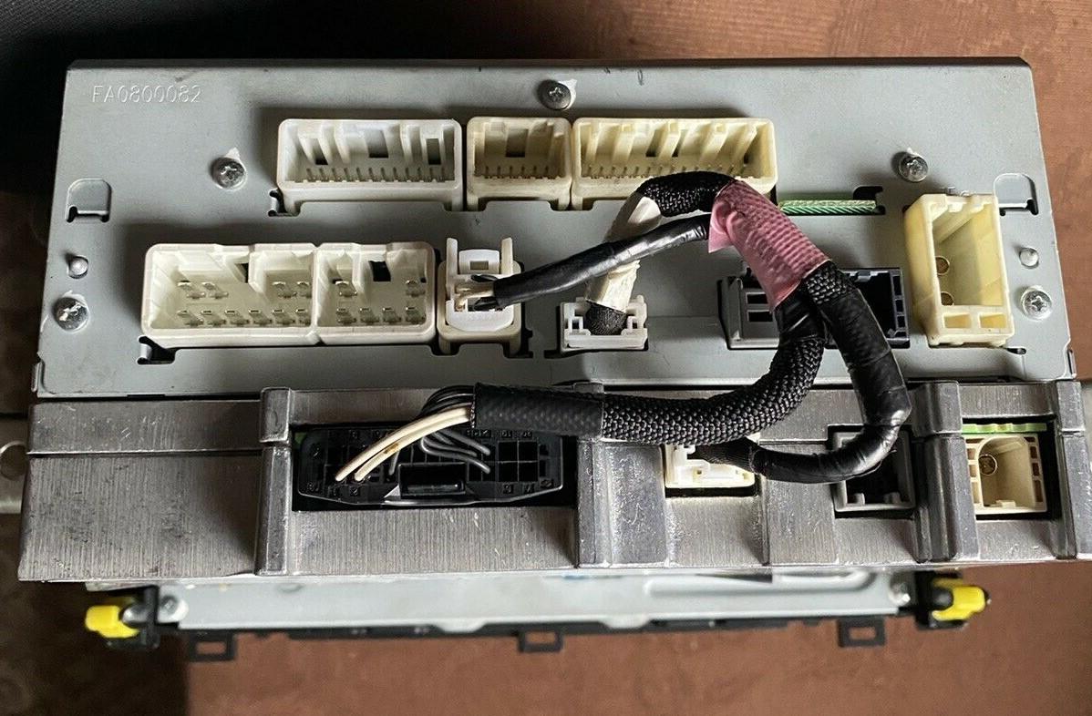

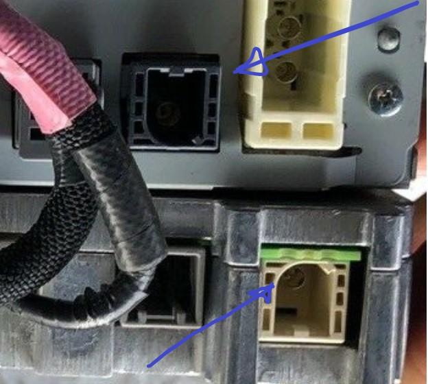

It appears that the GPS and DAB connectors are different on the Touch 2. The inside connector is round where as on the Touch its square.
I think I can live without the DAB for now.
The earlier GPS is the GT5-1s, sorry my mistake, The touch2 uses an SMB connector with Toyota housing

Correct, but the DAB antenna goes in the DA, and its the mirror image of the GPS antenna (smb)

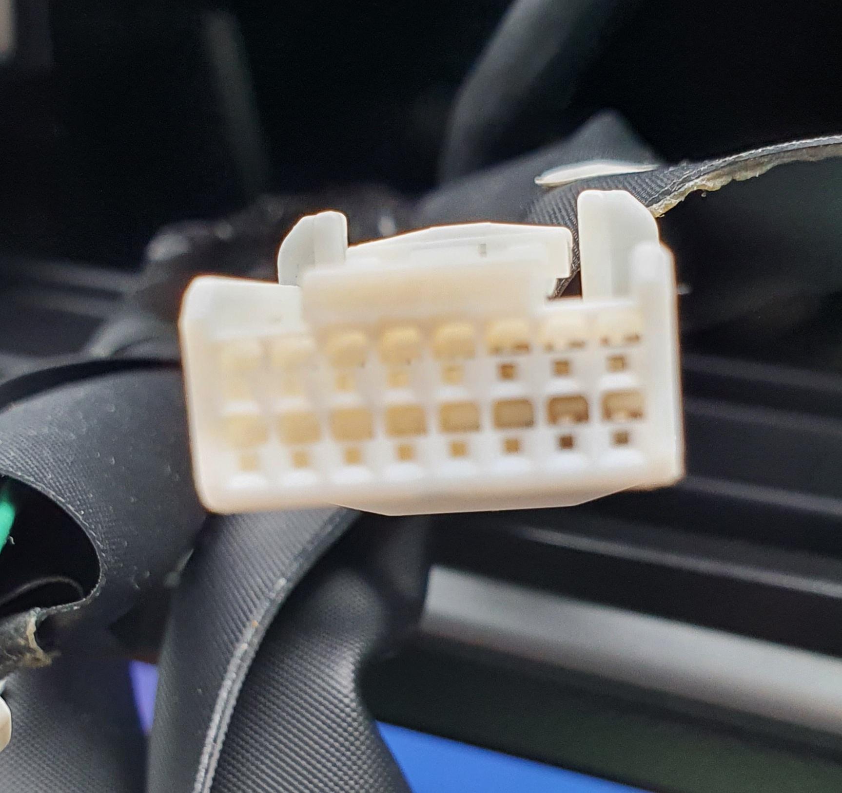

Everything seemed to work at first, including the USB until I put it in reverse. The reverse cam does not work!!!
I am guessing that 16pin connector has something to do with it. I have a feeling I need to connect the 16pin cable to the 24pin connector on the Touch2.
Is there any converters or is there a easy hacks?
Any pin outs for the 16 pin connector?
