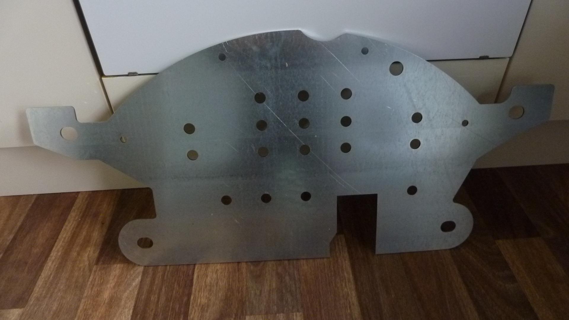

There is another thread dealing with catlocks, I said I will post photos of the plates fitted. They are 3mm thick, which is more them majority I seen, they at 1.5mm or 2 mm at the most. Dearer then most on eBay, but I believe they will be more difficult to get through due to the thickness.

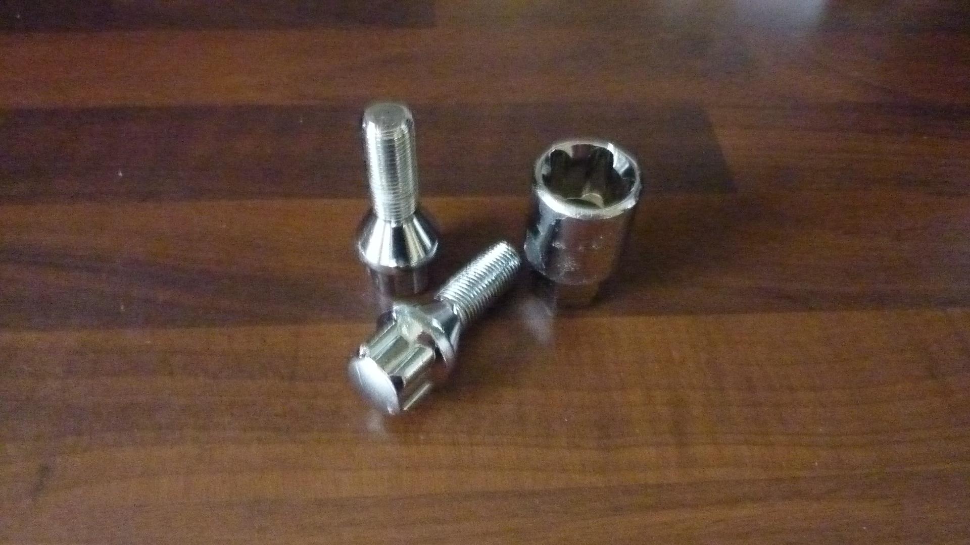

If you decide on the plate, replace the bolts with locking ones for alloy wheels. I just car filled over them. I also had 16mm steel bars welded on to make cutting more difficult.

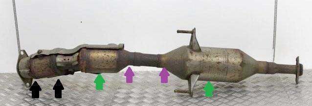

Just so you know, the first part of your exhaust system looks like this one -
This is actually an Auris gen1, but yours is very, very similar.  The front of the car (and the engine!) is to the left.
The catalyst is shown between the black arrows, this is the valuable bit, and not remotely as visible as this when it is fitted - it lives quite high in the transmission tunnel.  The scumbags undo two bolts located in the flange on the far left, and then saw through the pipe somewhere between the two purple arrows (this is for their speed and convenience - they could unbolt the flange on the far r/h side).  They then take away the first silencer box (green arrow) as well as the catalyst, just for simplicity, although that silencer box has no value to them.  The second silencer box (second green arrow) is left behind, that has no value either. The whole assembly shown has one part number when ordered as an (expensive!) replacement.
So, you would ideally need to be obscuring/hiding/protecting the left hand side assembly - especially the two bolt holes shown, this could be by caging the l/h part of the exhaust and/or fitting a plate (difficult to do the caging on this car as there is not much space around  when all this is fitted to the car)

Mark, the first one you show is what I ordered for the wifes 2010 Auris, also fits CT200, thats the 3mm thick one, much more thickness then others I seen.

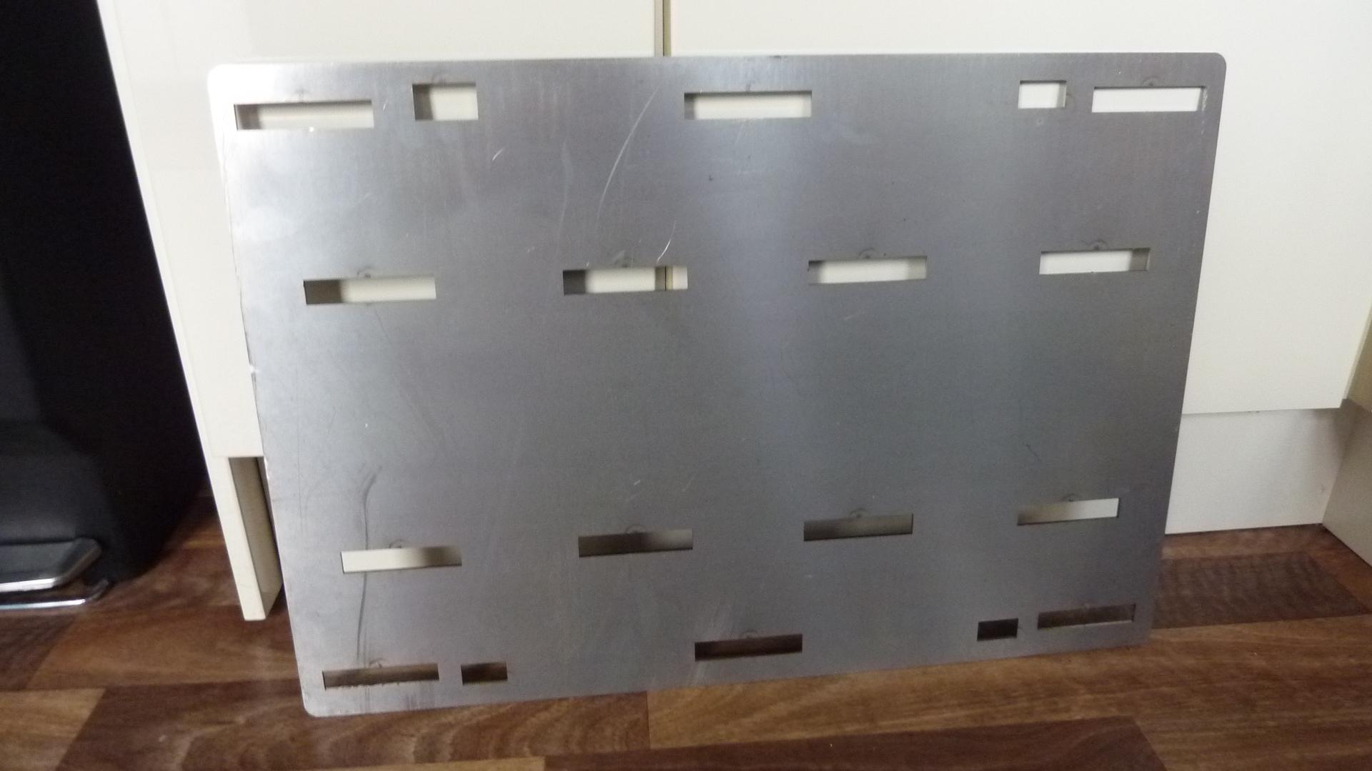

The one for the Gen4 Prius is totally different, its oblong, see photos taken this morning. When I went to collect the first to be done (Auris) it was already off the ramp so I couldnt take a photo but it is as the supplier photo. The seller will also send you a video of the fitting if you have Whatsapp.
His prices must go up and down, and your listing he includes p&p. Make an offer (he invites it) of £50. I paid extra for the security bolts (2) for the Auris.
