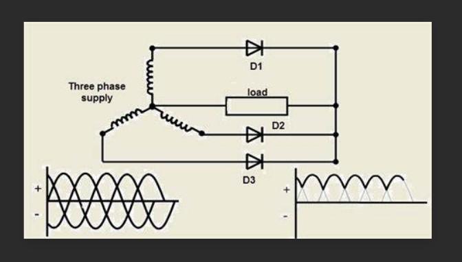

Low idle speed reduces the frequency of the ripple voltage because the alternator is not turning as fast. The alternator output is not pure DC but consists of three overlapping 'half sine' voltages. At lower speeds your eye can detect the change in brightness as the voltage changes. Its a bit like watching old films. You can see the low frame rate as 'flicker'. As frame rate is speeded up the movement in the picture becomes smoother because your eye can not then follow the very rapid changes. Same with the alternator.
The alternator produces the three sine wave voltages shown in the lower left of the diagram. Each is 120 degrees apart. The lower right shows the rectified voltage (by the diodes in the alternator). You can see it is not pure. The 'load' in this example would be the Battery and car electrics. The alternator is 'pulsing' the Battery with those peaks and that is what you see as ripple.

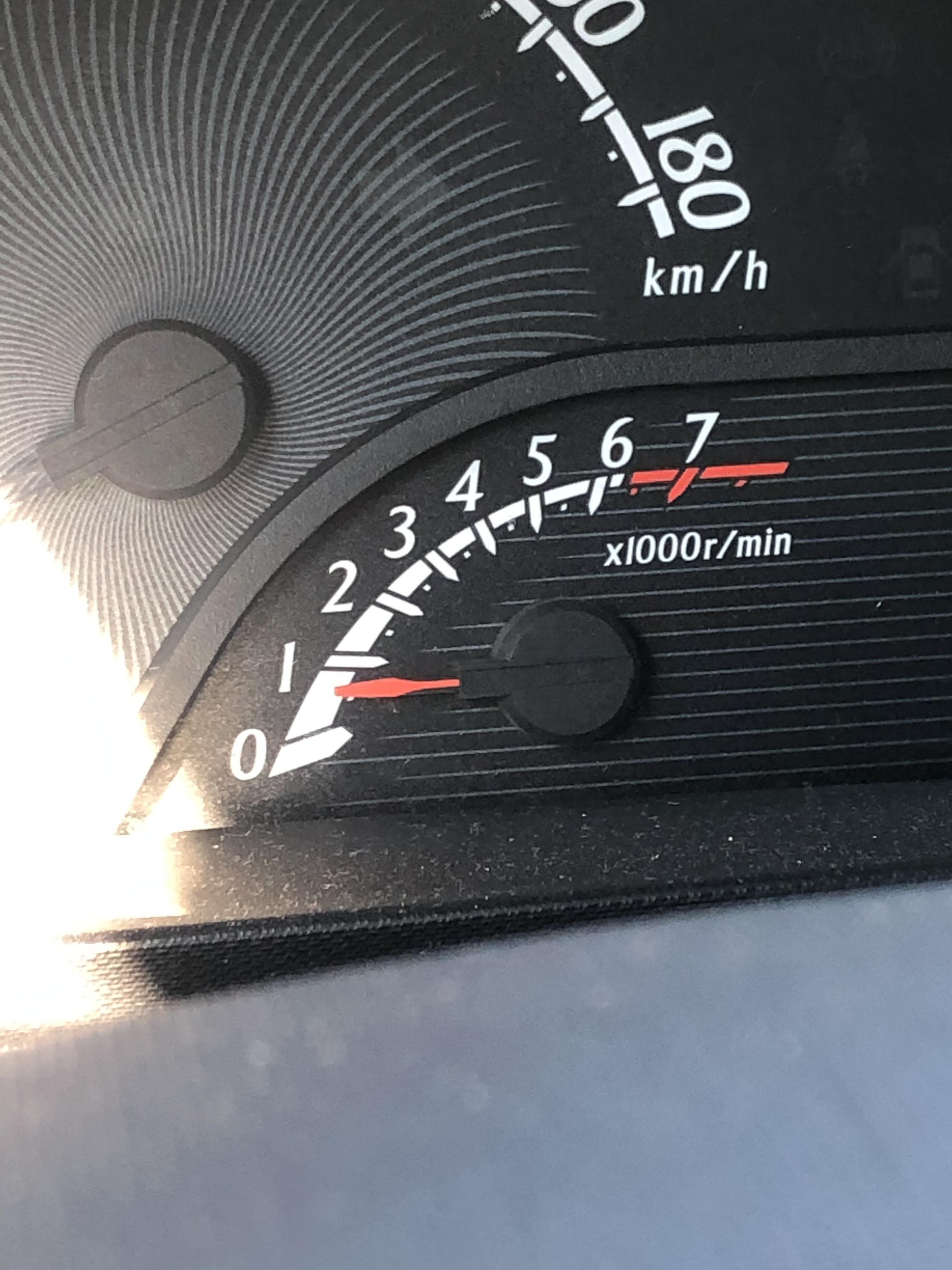

I did some checks before taking it to the workshop to clean the throttle body.  When there is flicker the engine is usually at 500 rpm is this normal?  Is the idle so low in your IQs when the engine is warm?
500 sounds to low. 800 to 900 would be more typical on a modern engine and this may actually increase to more like 1000 rpm in response to additional loading such as switching A/C on or heated window etc.
Ok thanks, here is a photo of the car at idle when the problem arises
Hard to say from that as the dial hasn't really got the resolution to make an accurate assessment... visually perhaps a little low.
The idle sped once the engine is up to temperature should be pretty consistent day to day (all other things being equal such as what you have turned on) and so if some days it is OK and others not then that suggests a problem.
Maybe others with a similar dial could see how it compares to theirs.
Looks about right for a 1KR 3 pot, if you raise the revs does it still flicker ?
