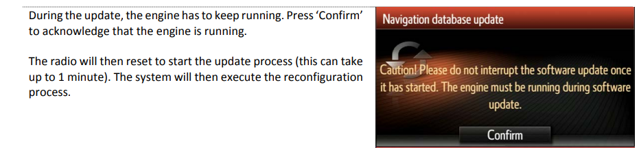

have a question about my Toyota touch 2 go multimedia system. I downloaded the maps updates and saved all files on an empty USB. followed the online guidance and went to my car and was planning to update the system. i made the critical mistake of not turning the engine on but just switching the multimedia on (it's a 2019 yaris hybrid, engine turns on with a button). the system started installing the updates (was supposed to take 30-40mins) but after 15 mins the multimedia switched off (because it's set to automatically turning off when the engine is turned off).

The instructions clearly say the engine must be running and you even have to confirm it on the screen !
