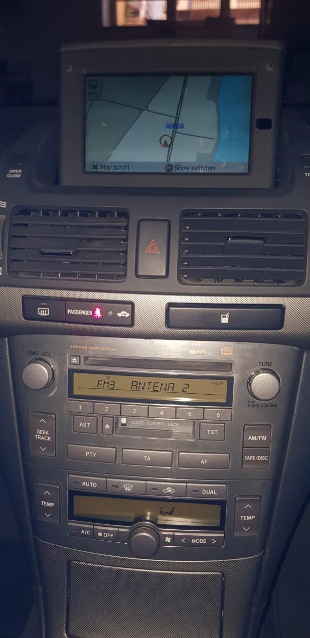

Reaaly aprecciate all your help, but i would like to know if does anyone can help me. I have the radio and sat nav (see picture pelase. I bought a lapower with Y cable but it doesn´t function properly. When i hook the two cables to y cable the lapower is recognized by bluetooth phone as a carkit, but i'm not able to switch in button mode to it. If i unplug the cable that was originaly hooked to radio ilapower works preaty well, but i lost all the functions of the navigation, trip informtion...
Does someone have the same problem and know the solution?
Thank's a lot in advance

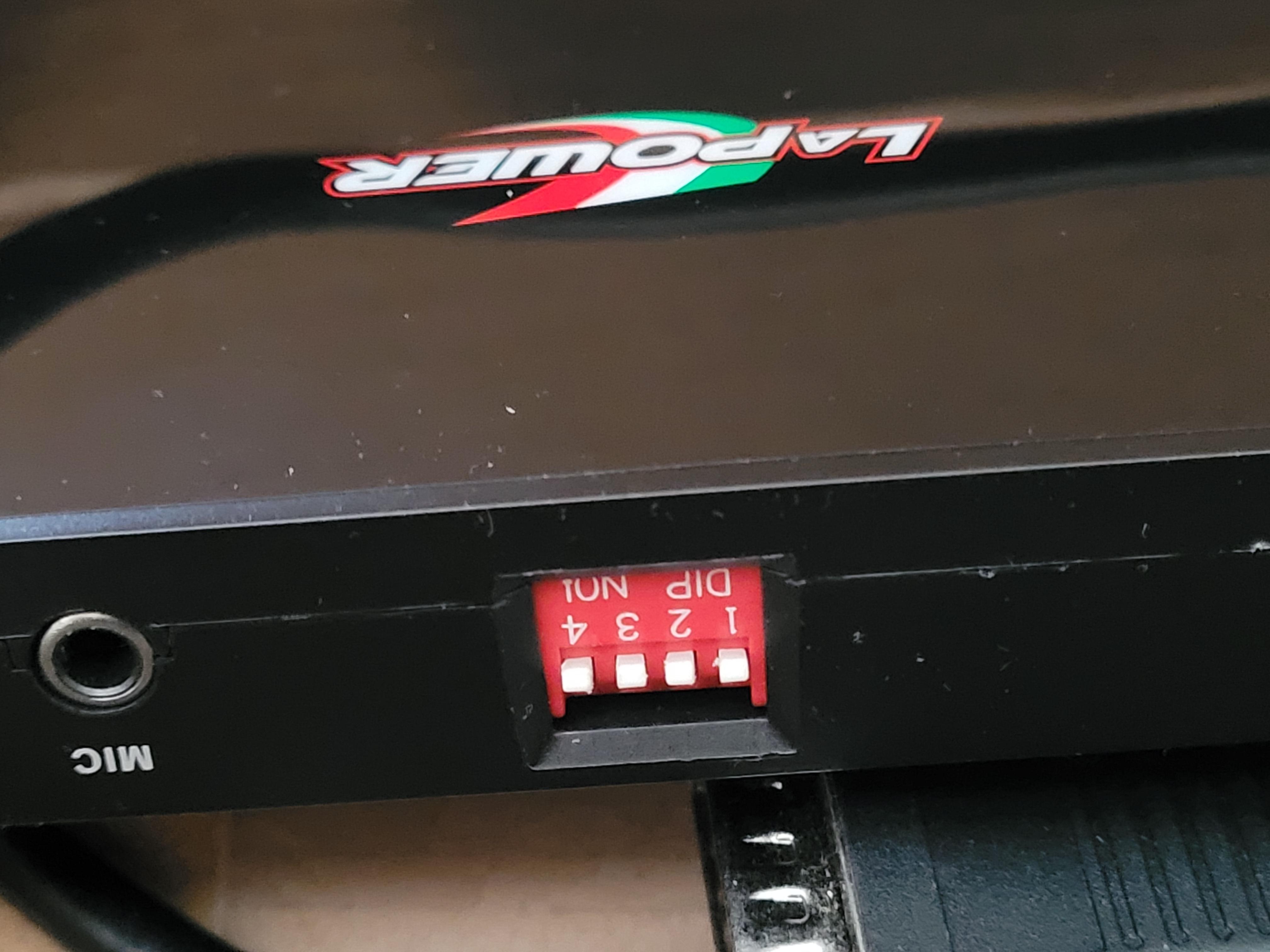

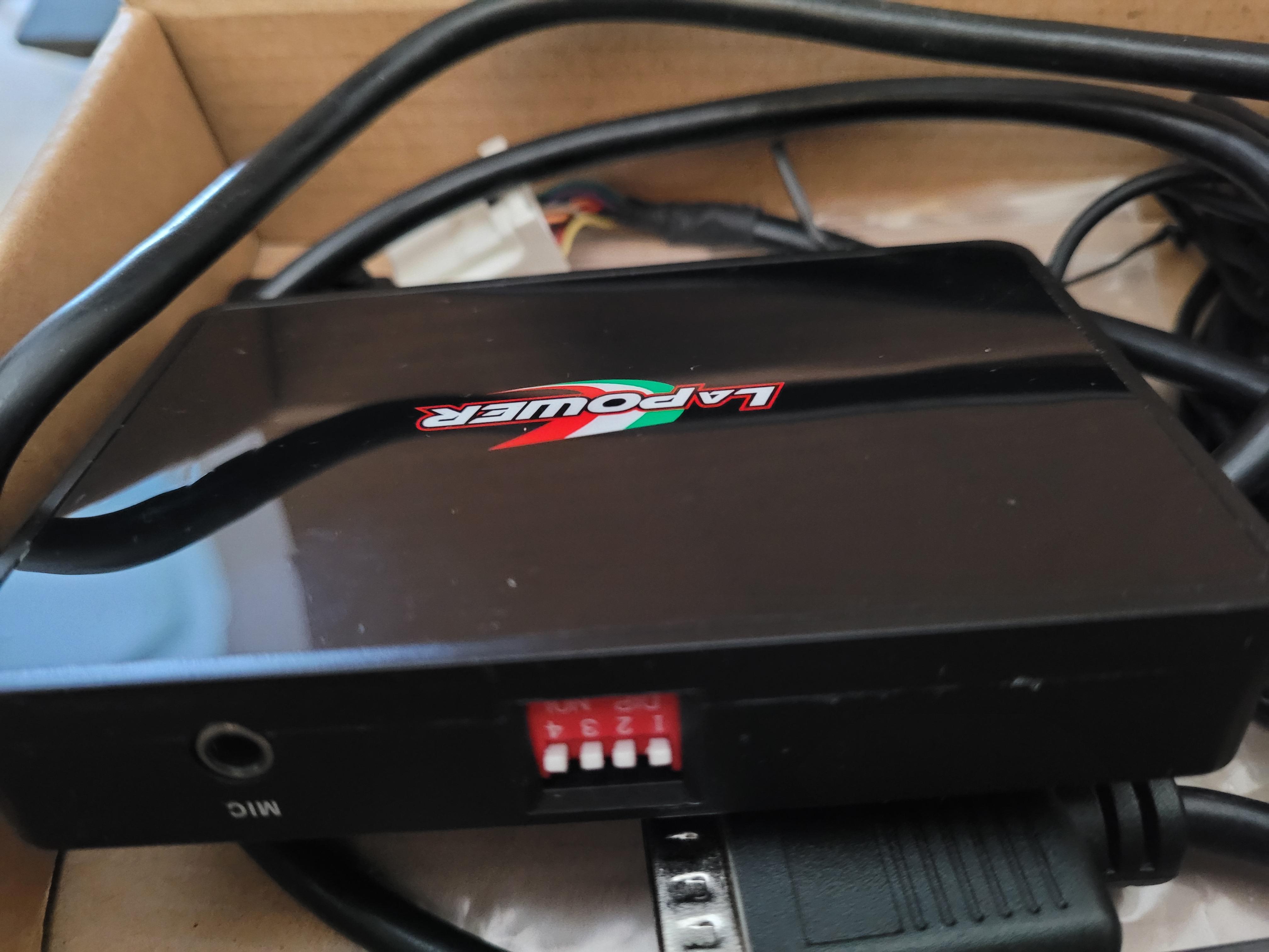

On my version of the LaPower MP3 adapter, there are dip switches. 20201208_141026.thumb.jpg.c55c109f434c68de2baaa59fb5b2cbee.jpg20201208_141041.thumb.jpg.c564ad8d9a9c535ffe85f9ee1e410cef.jpg
Ok. In the manual instructions it says that's for adapting volume do other brands, like bmw...
