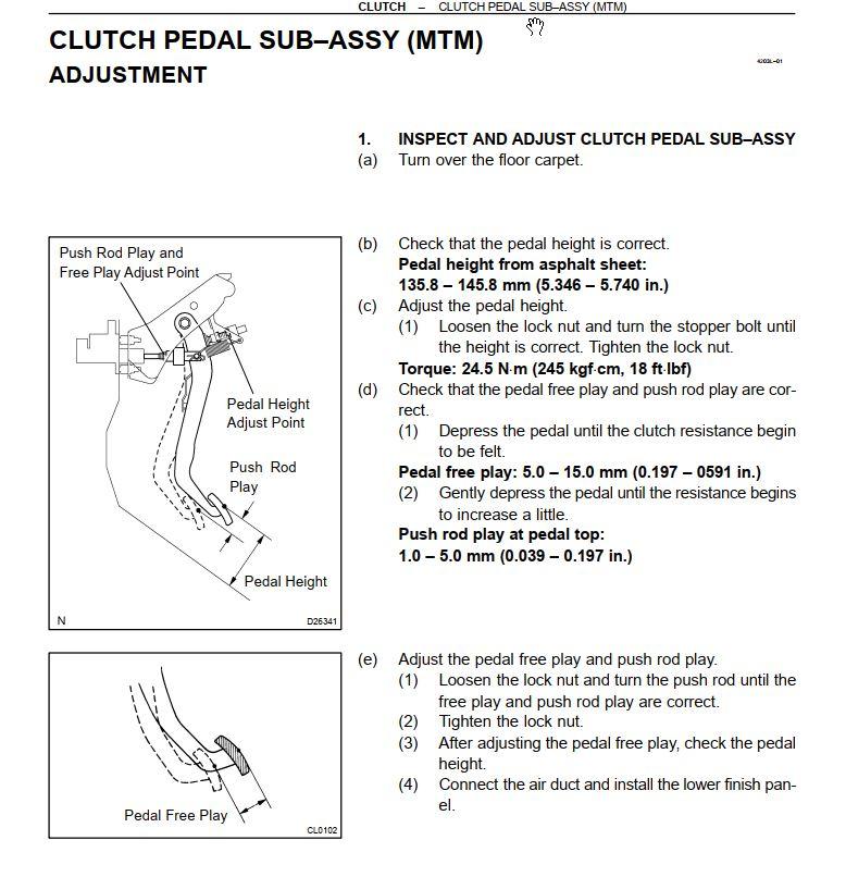

Hello, 1st post here...
Is there a diagram or info how i adjust this screw? Many thanks

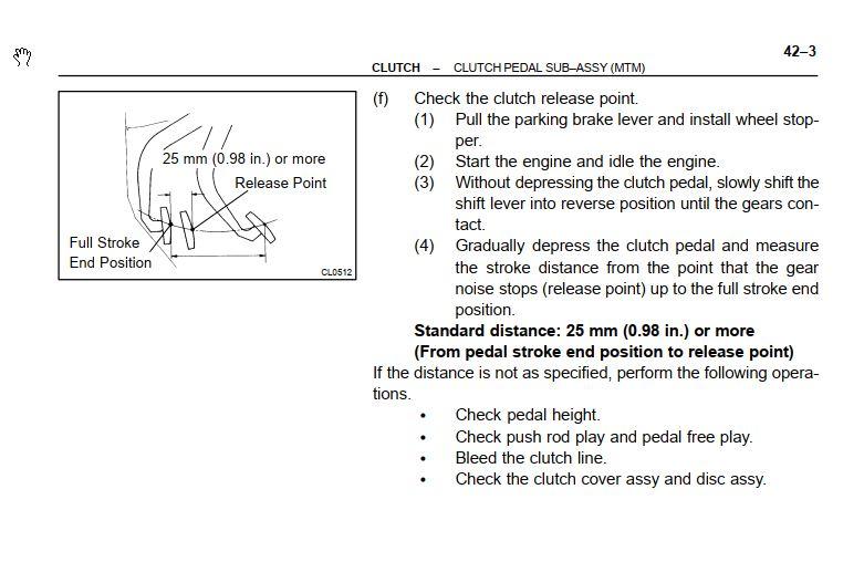

@tazzer10
These diagrams should help with clutch pedal adjustment.
However a high biting point, heavy clutch pedal and slipping clutch , as you seem to describe ?   all indicate the clutch is well worn.
Your Toyota dealer or most garages will be able to fit a new clutch, but prices vary considerably , so check around.
It is also a diy job if you are handy with auto maintenance, but beware of cheap clone clutch kits.
Thanks so much this is really helpful, will update asap 👍
