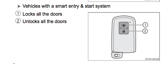

Red light eh?  I must look for that!  To be honest, we never look at the fob, just pressing the button!  Our car is supposed to have Smart Entry I believe, though when I've tried it, it doesn't seem to work.  Pressing the key fob button works of course!.
This is our key.
Mick.
Not all key fobs have a red light, most do, but not all. When they drop below 3V it's time to replace, some weird things happen with a low voltage, usually you need to get closer and closer to the door before it opens, or on some models, you get the warning light on the dash. You would not be marooned if you have a keyless type of fob and the Battery in the key went flat, hold the fob over the start button and press to start the car. I have people come in to say they have never replaced the batteries in years and seem surprised they need to spend a fiver, others will need replacing yearly, depends on use etc
Ours has a red light, but just playing with it here in the livingroom over a cuppa, it seems the red light flashes so so quick, you might miss it.  It truly is a flash and come gone in an instant, and hardly worth the technology, as in bright light you wouldn't see it. If it gave a series of flashes, it might be worth it.
I have a multimeter, but by the time I'd opened the key and taken the Battery out to check it, I may as well have put a brand new one in there.
As I said, it's the same Battery in all the time we've owned the car. Bought from Snows Toyota Paignton in August 2017.  We are the second owner and it's now done 48,000 miles.  I'd like to think that Snows fitted new batteries in both the keys.
Mick.
