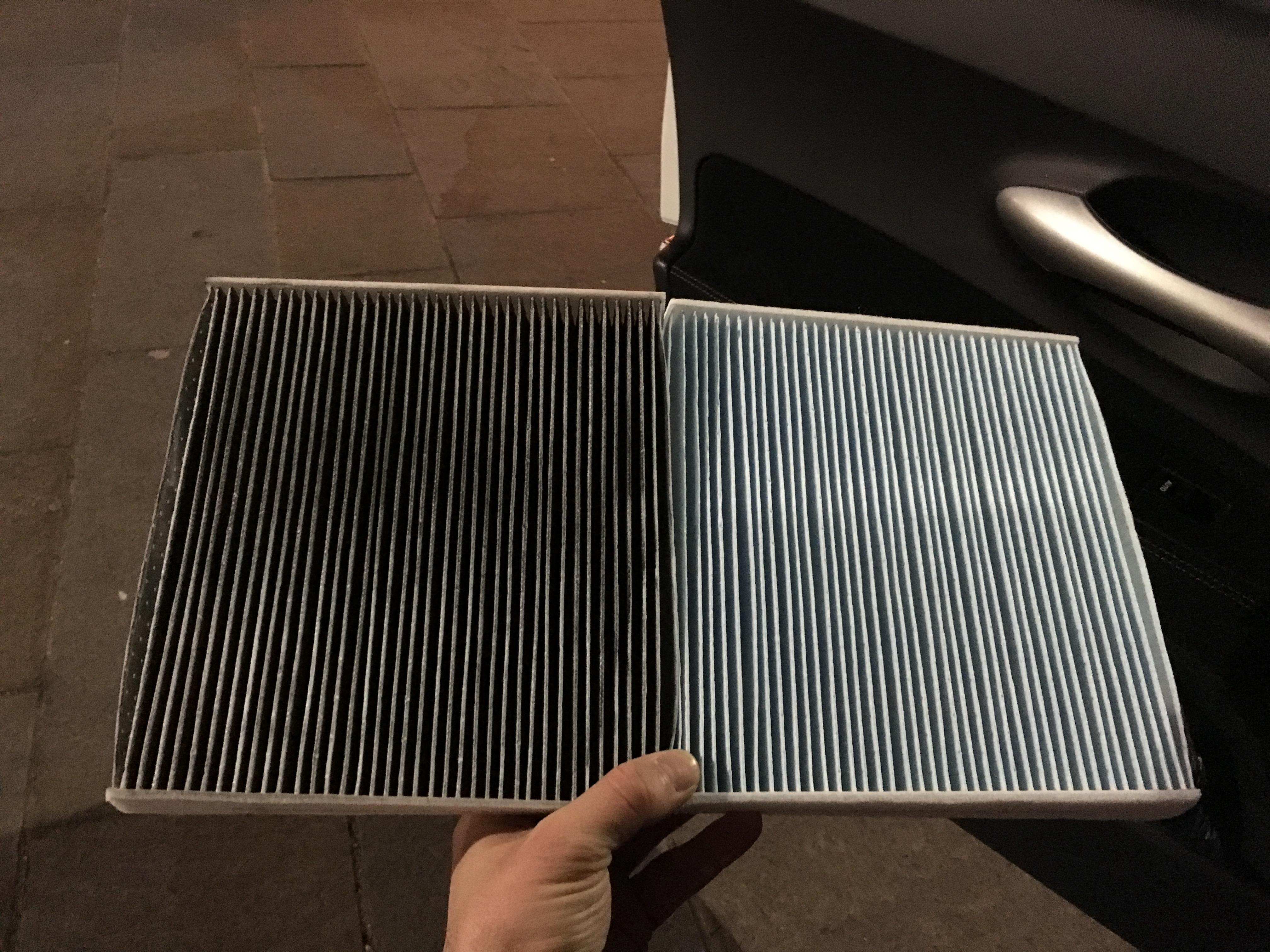

Similar here at 22C°, manually  set speed fan 2, air flow towards windscreen and feet in winter No AC, in summer season I change air flow to middle of dashboard and feet, AC ON only when necessary- outside temperatures over 20C° etc. Important thing to change cabin filter more frequently than dealers does for you. I do 5 times a year with every service and it’s full with carbon and smells of petrol.
