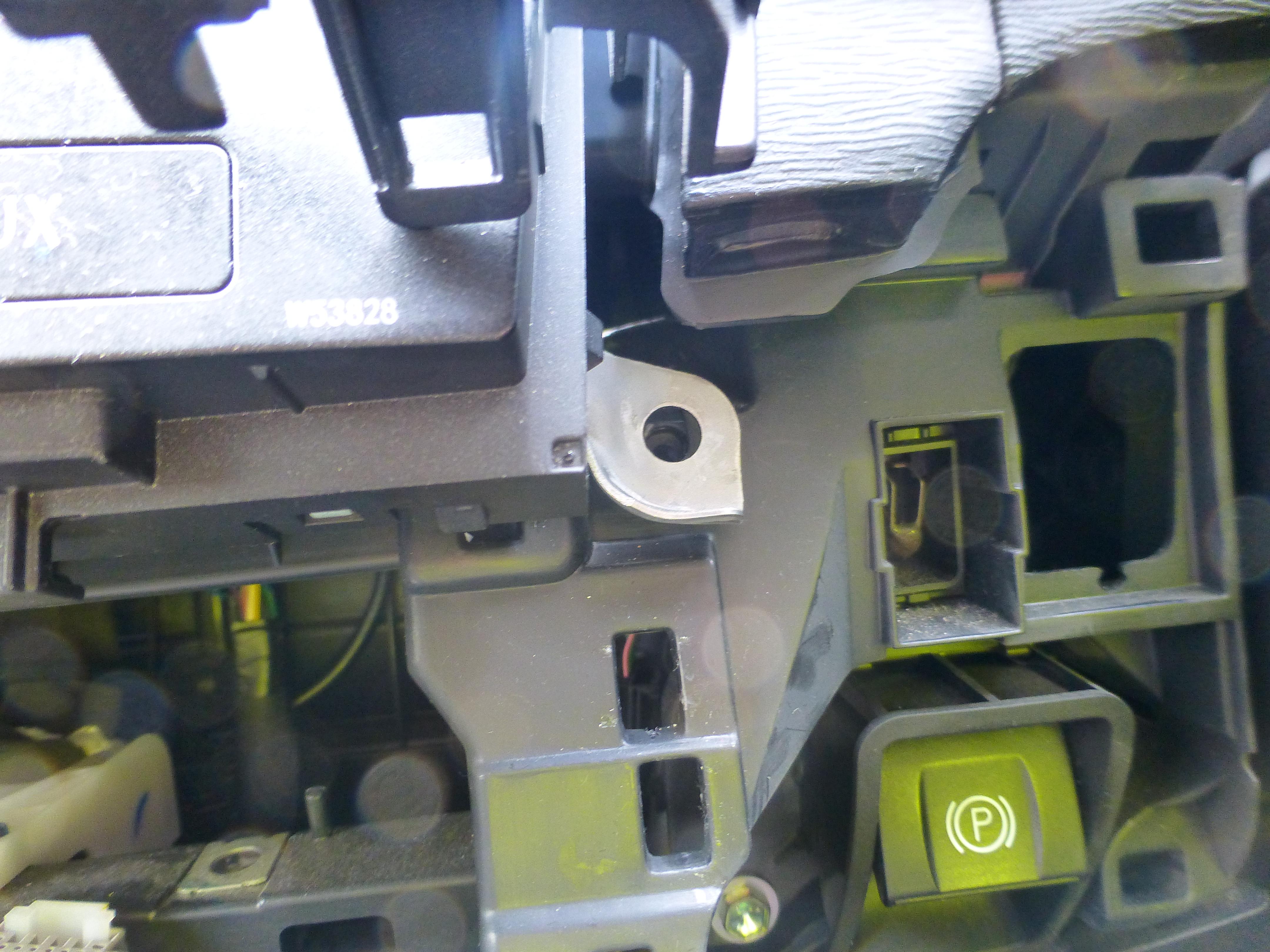

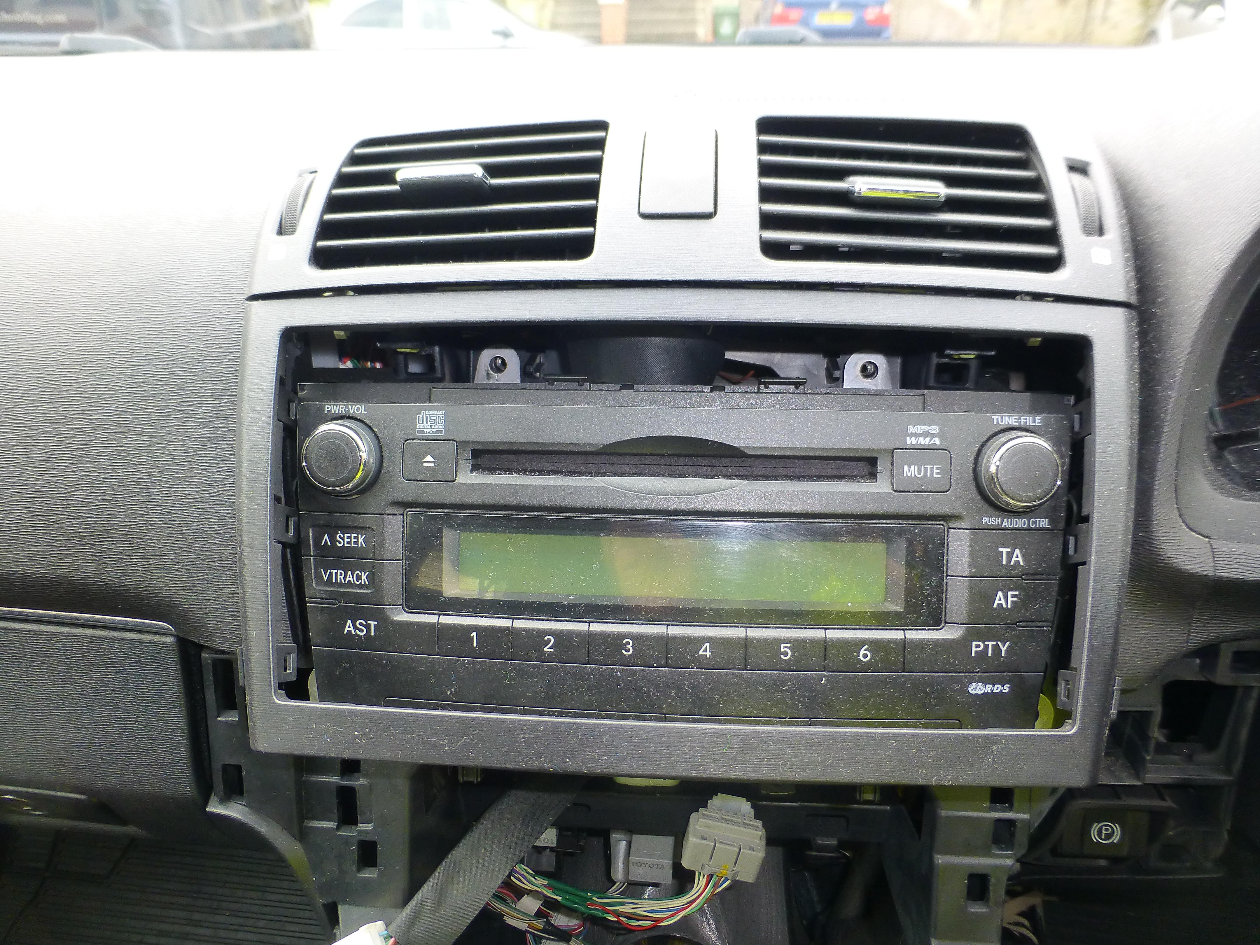

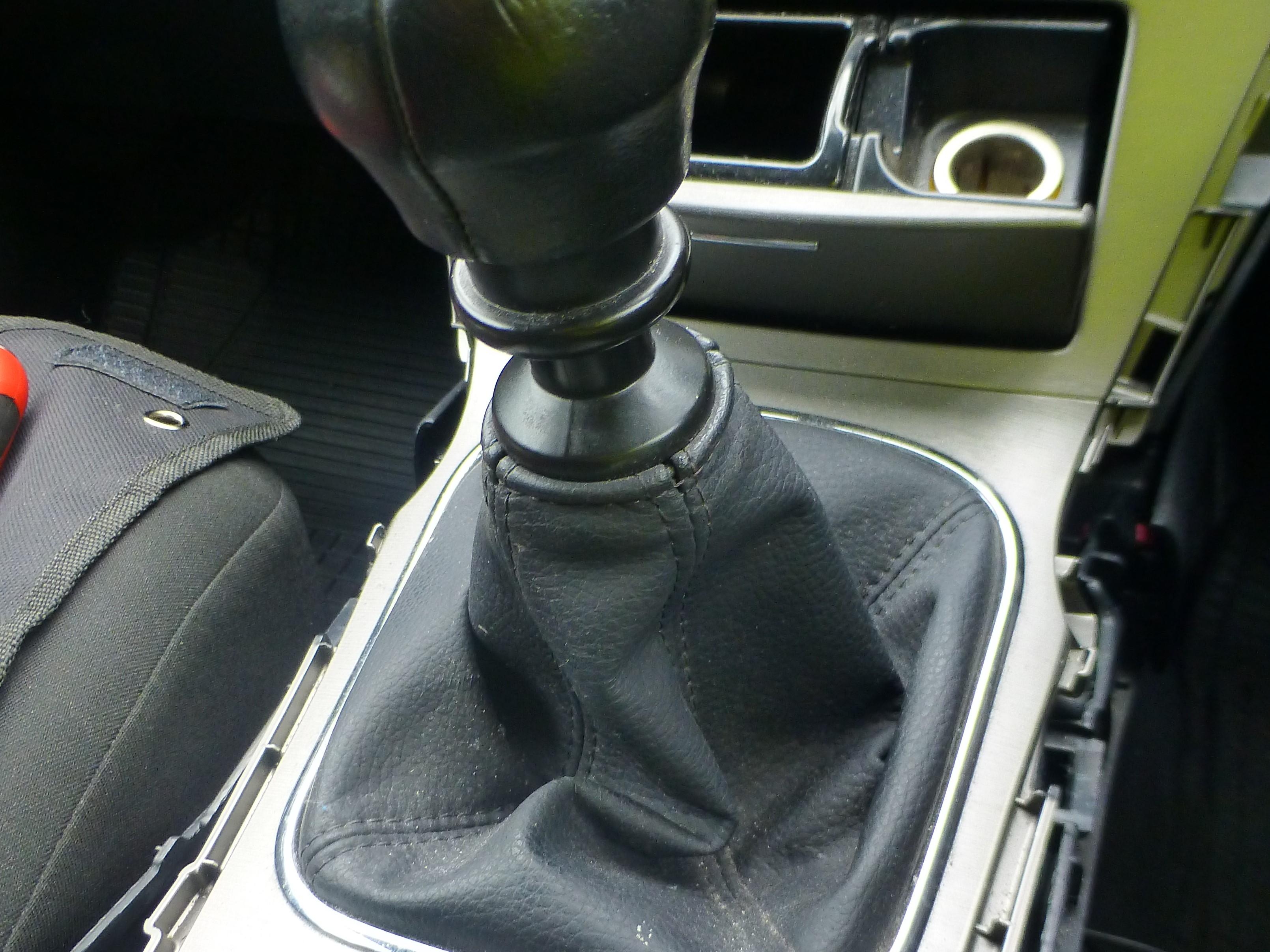

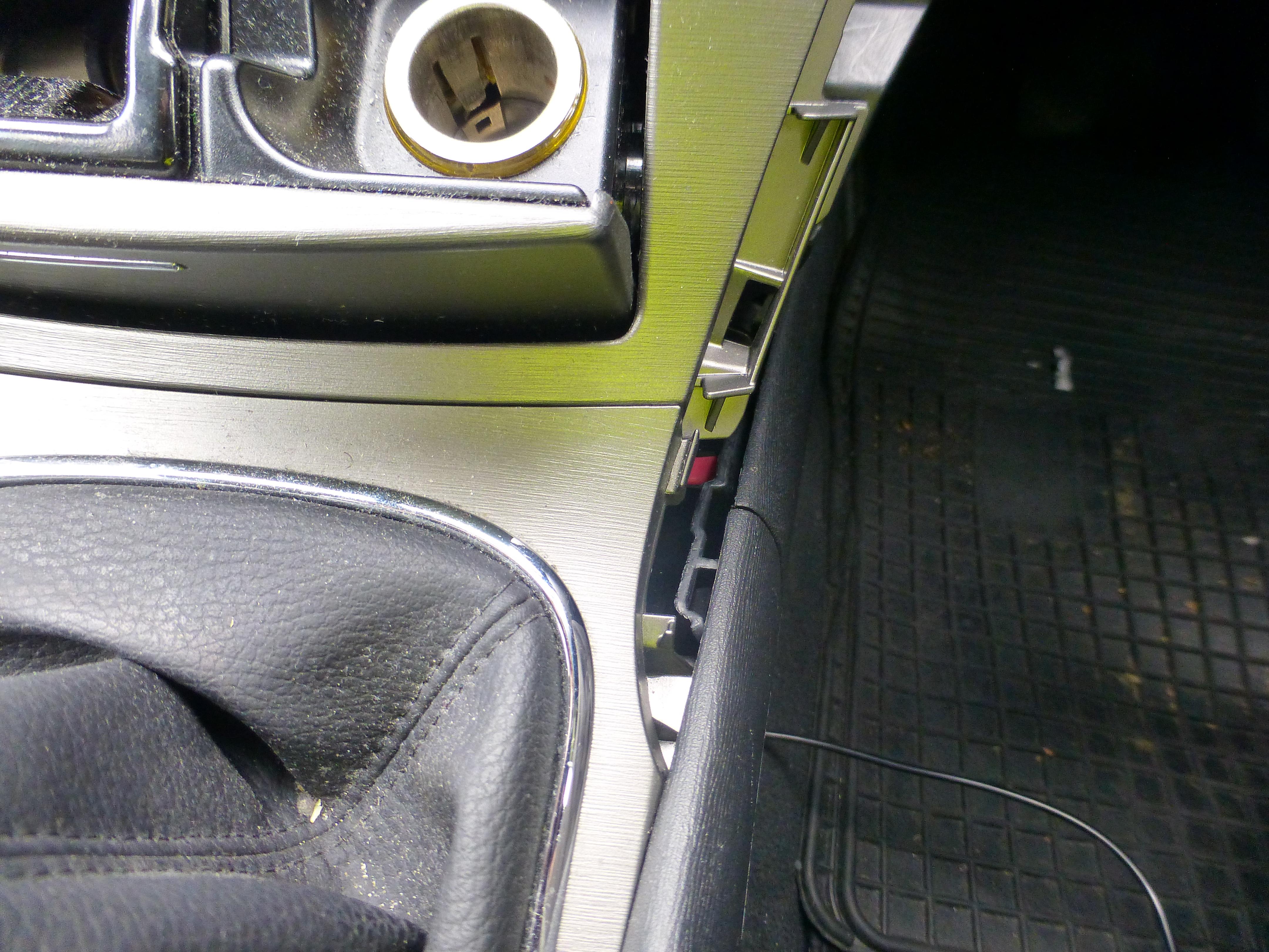

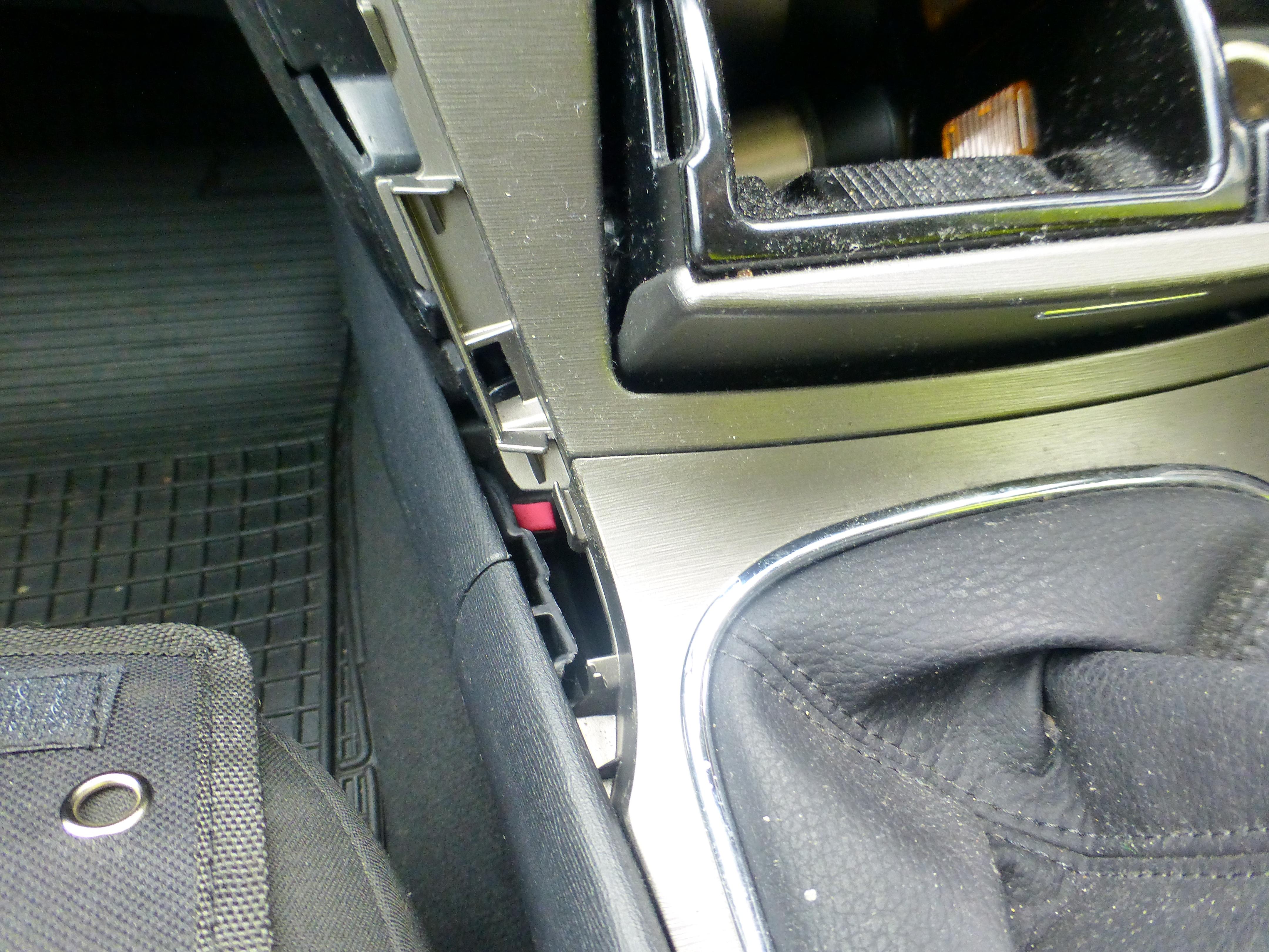

I went to my archive back up drives and found some photos.

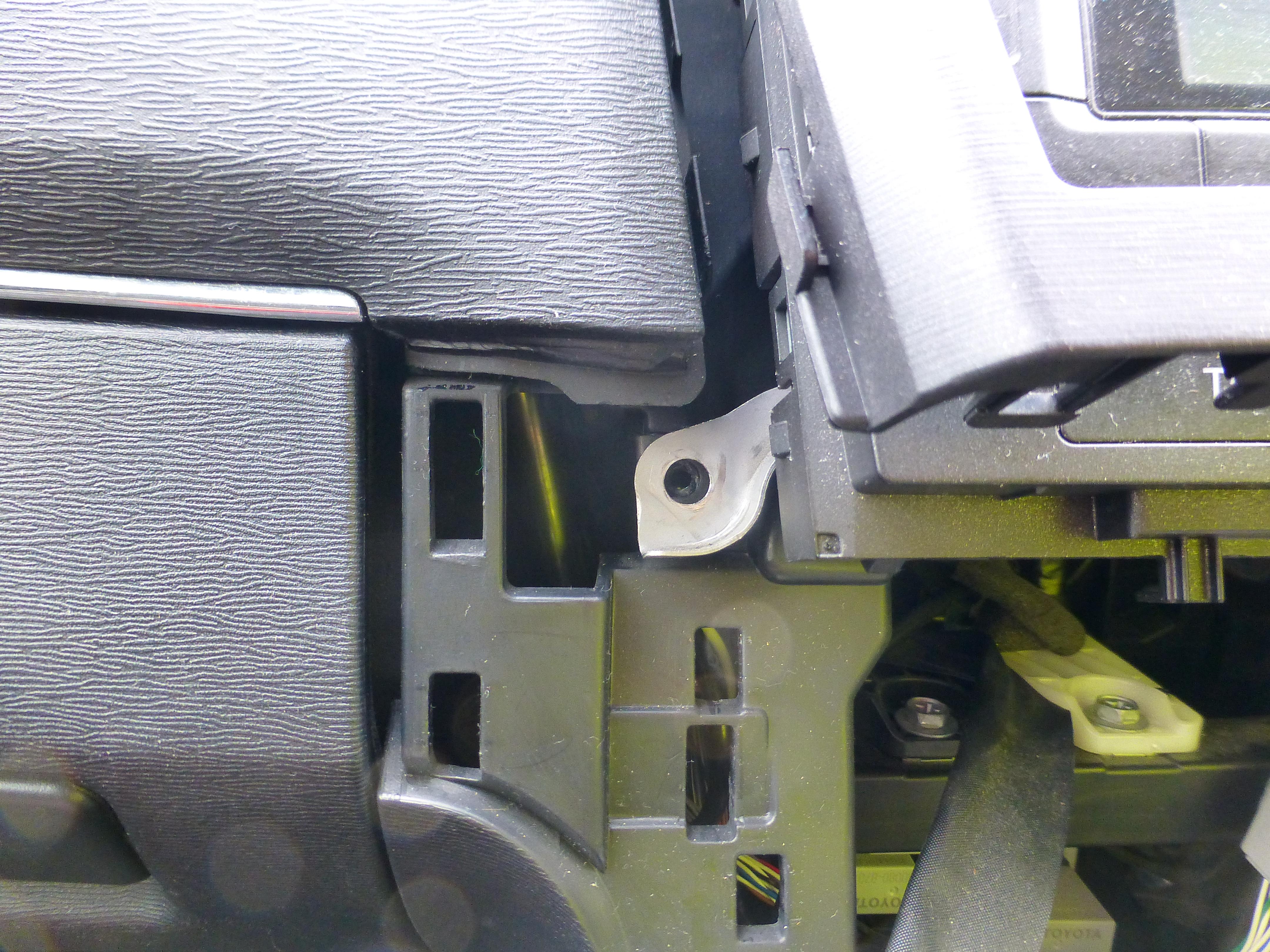

Remove side trims
P1140449.thumb.JPG.ec8f002961f07e45b36dc86dd63aa3ea.JPGP1140450.thumb.JPG.c3c8abc7cf4153a9210df25bec9bbf16.JPG654567074_P1140447(2).thumb.JPG.79e1daea1b7ac9b193a9e2fdecb83bc9.JPG

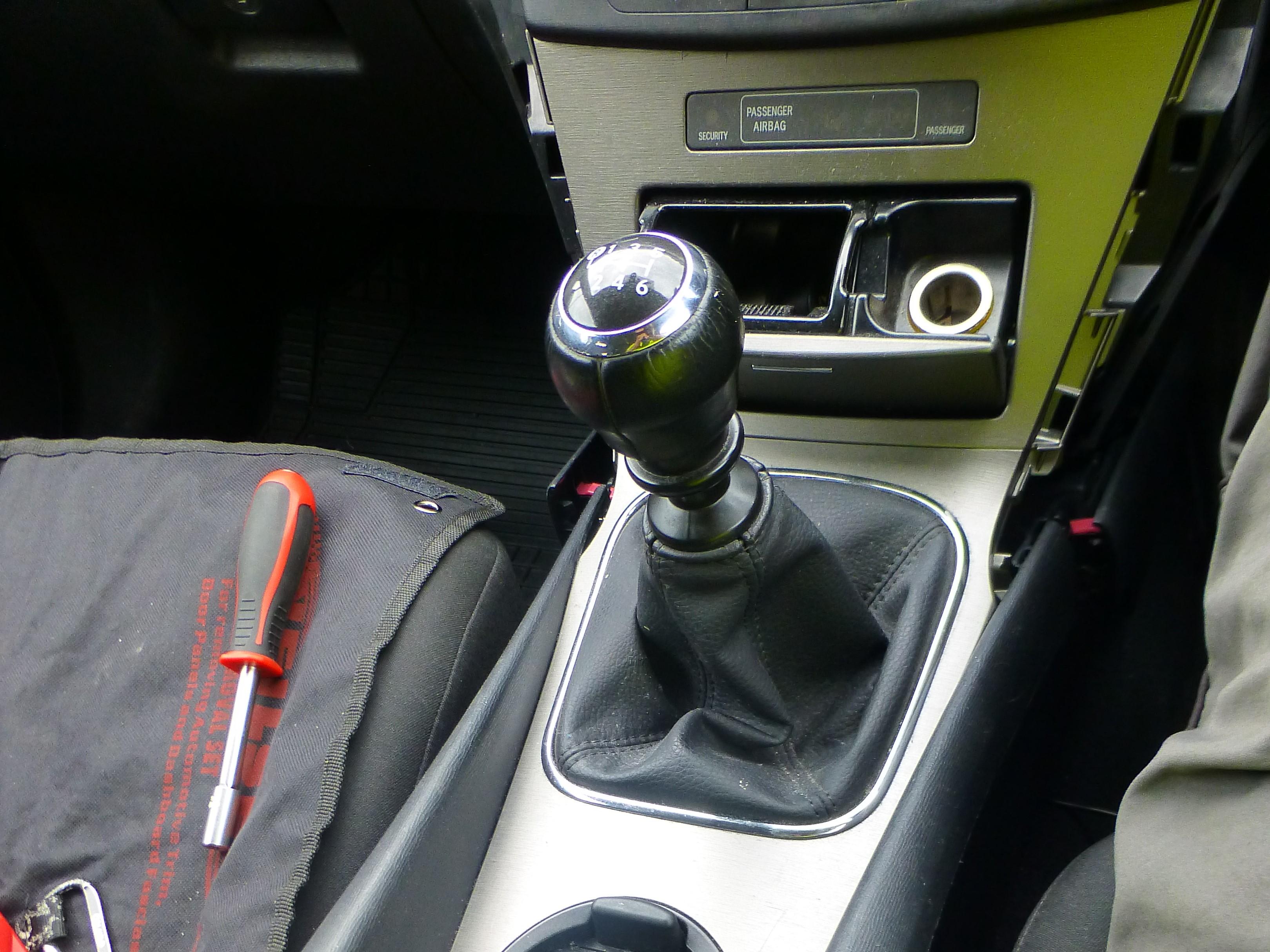

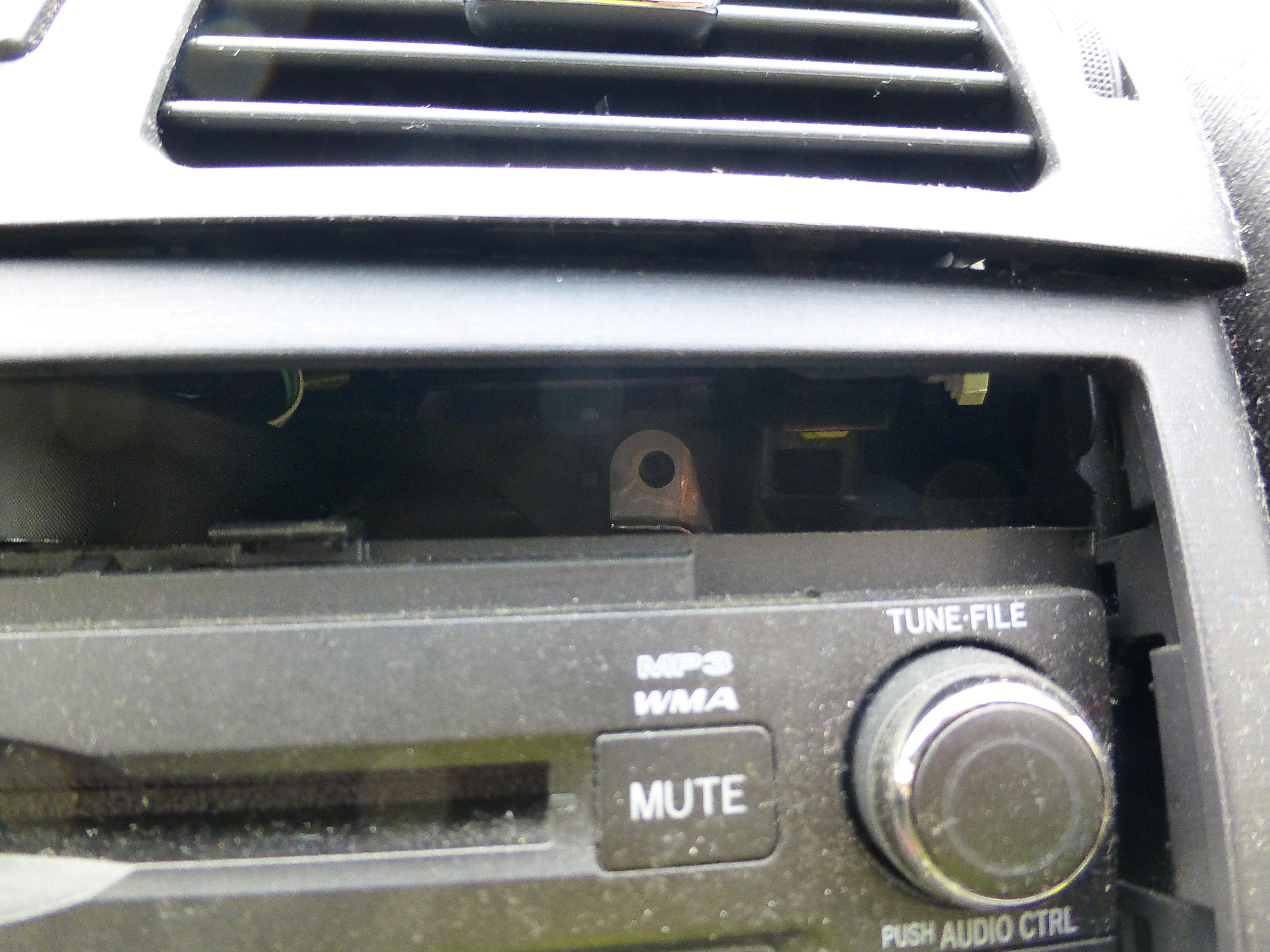

Remove panels surrounding gear lever - then remove the ashtray

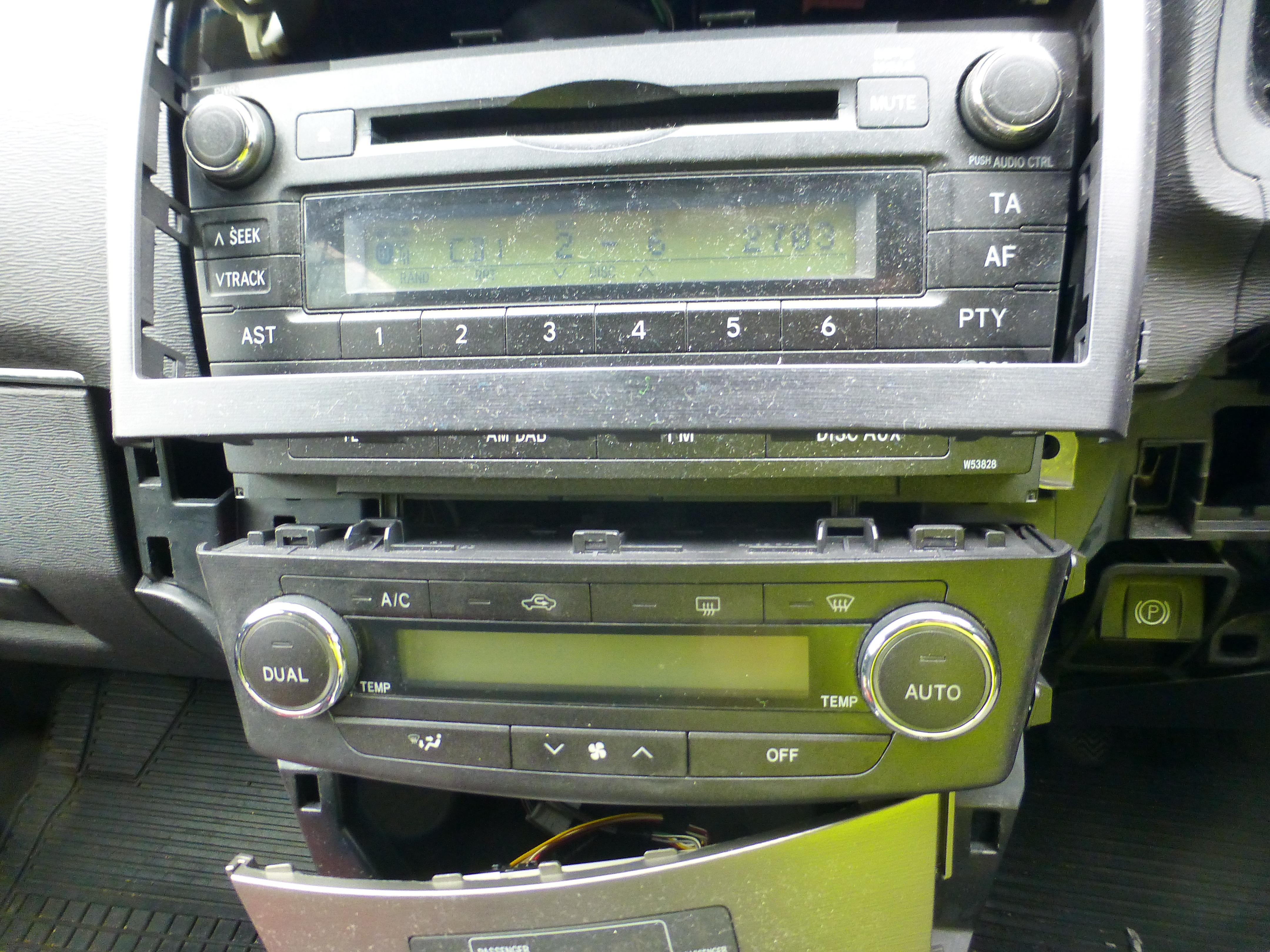

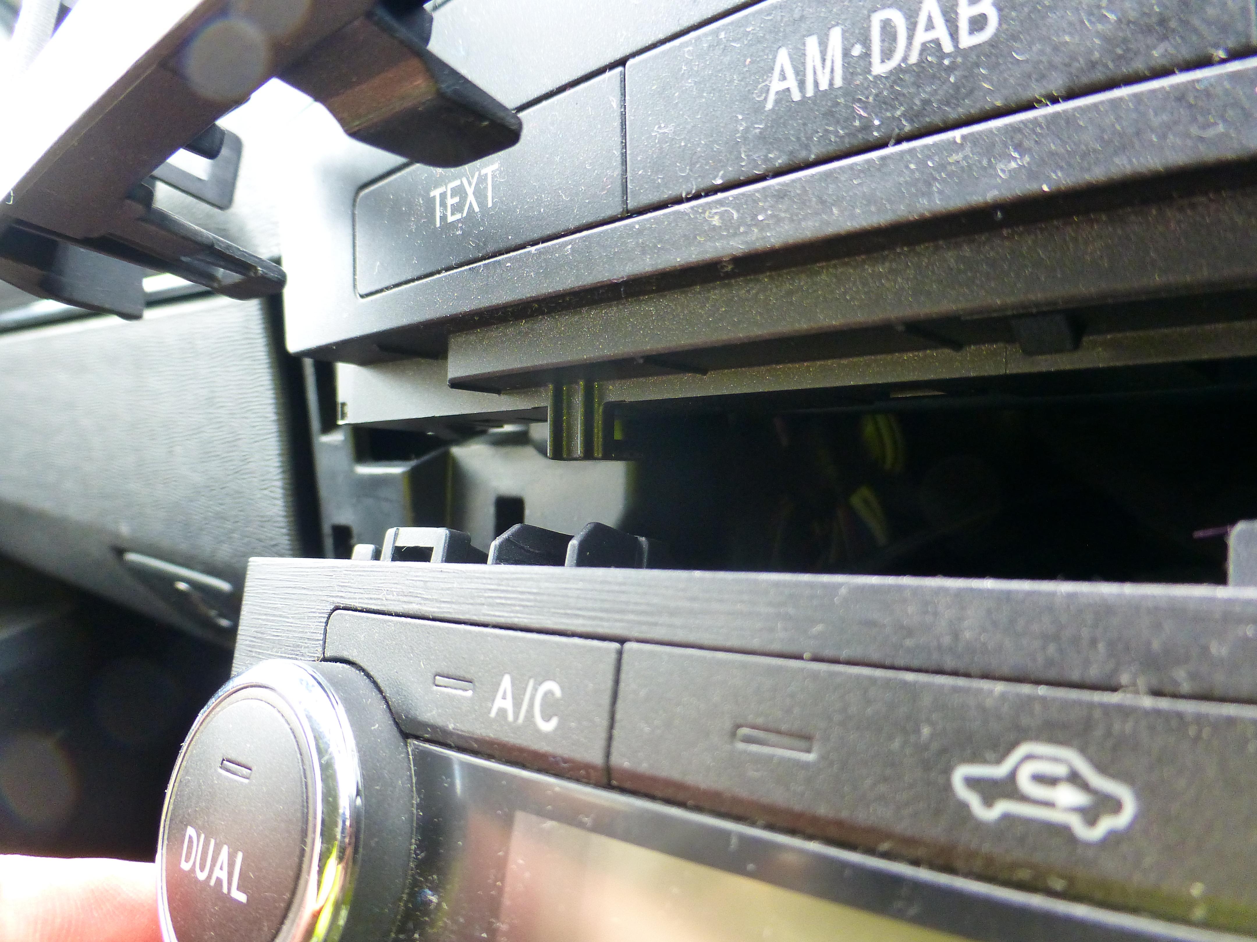

Lever the vent and radio surround, to separate from the heater control panel -
P1140413.thumb.JPG.94163d38331fd9cf1da11ec755ff0297.JPG P1140408.thumb.JPG.87dc657979d219cba8a8276d1806cc33.JPG P1140439.thumb.JPG.915f39223c223da05f1d157492246ce0.JPG

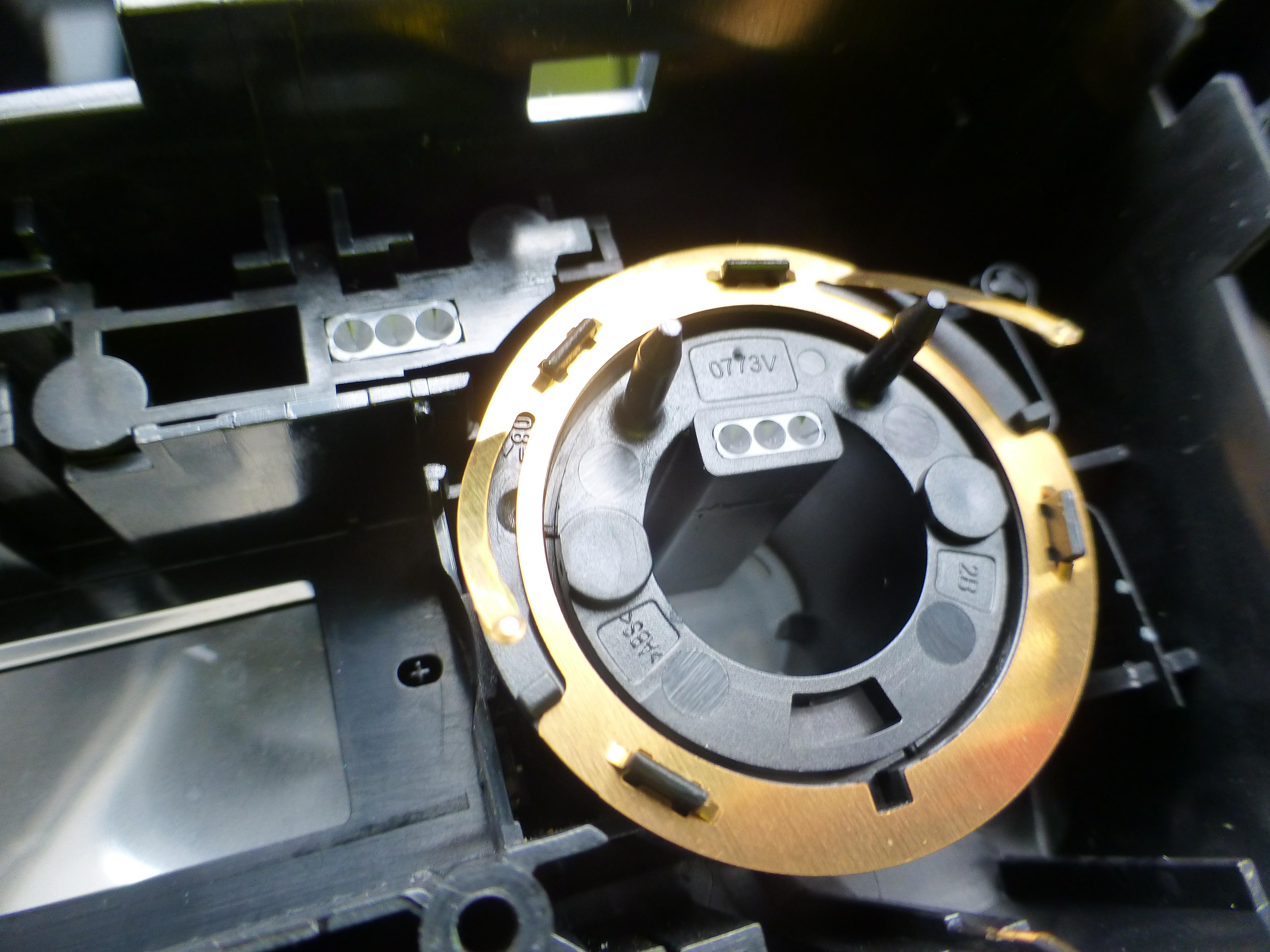

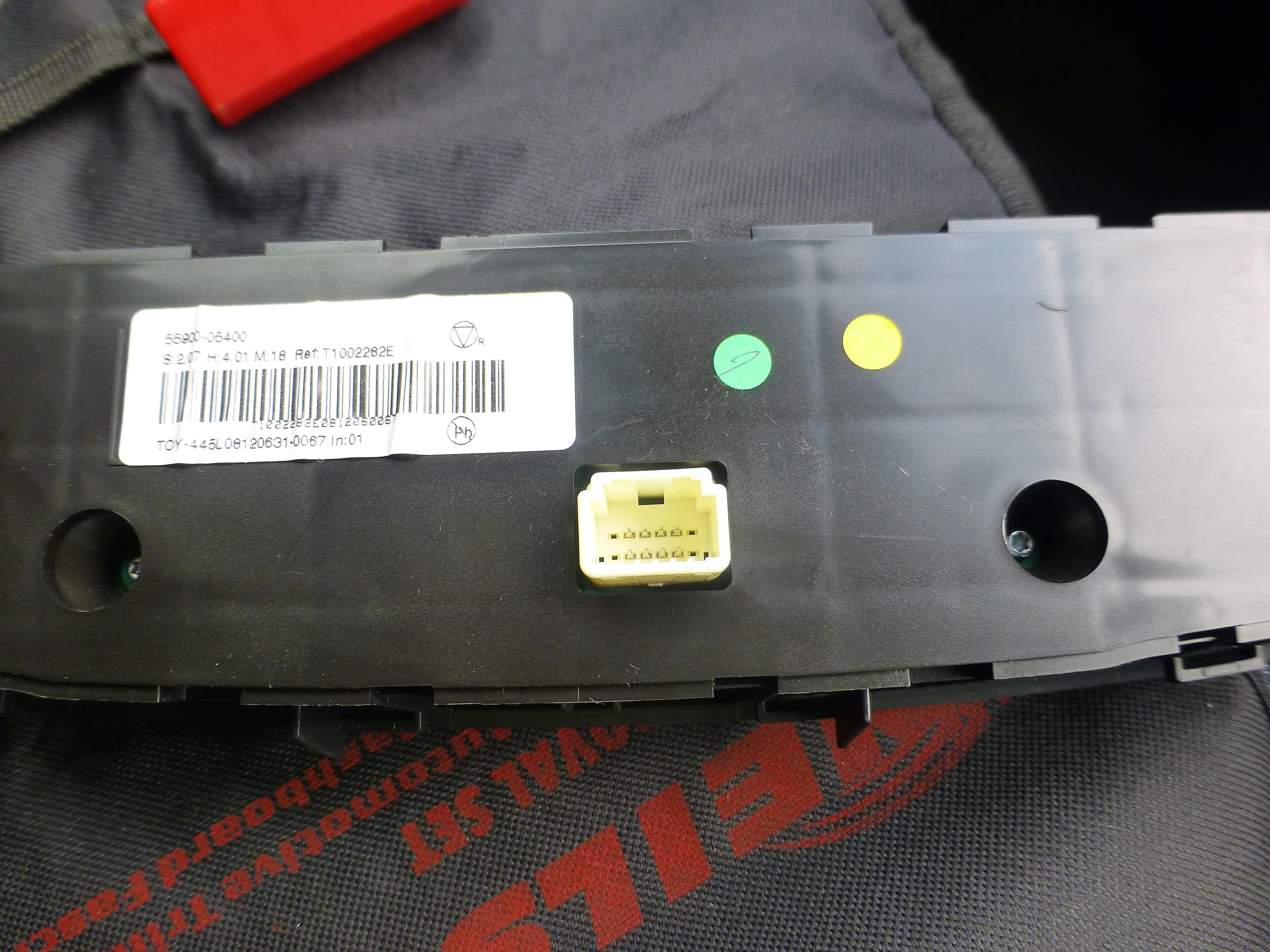

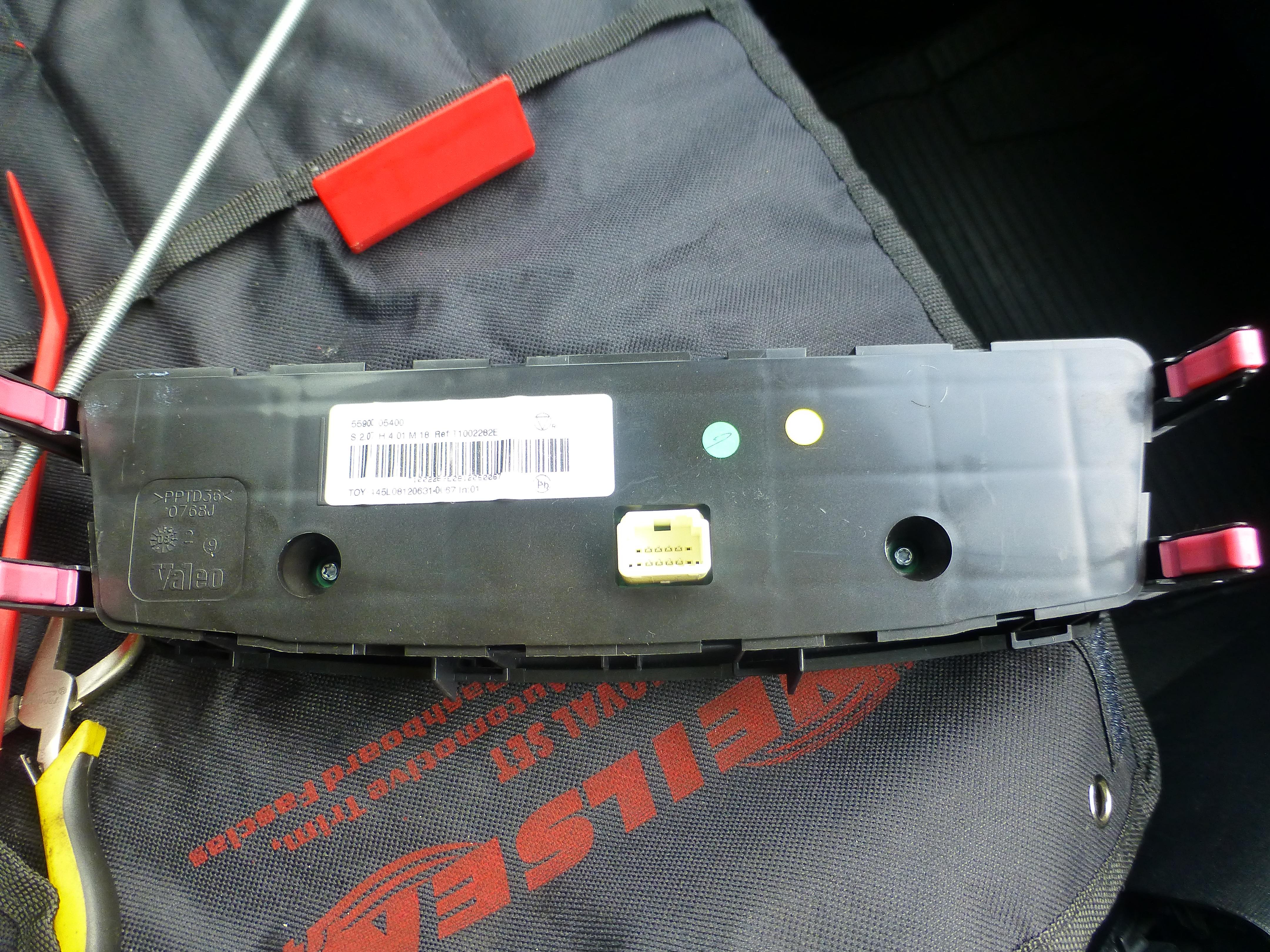

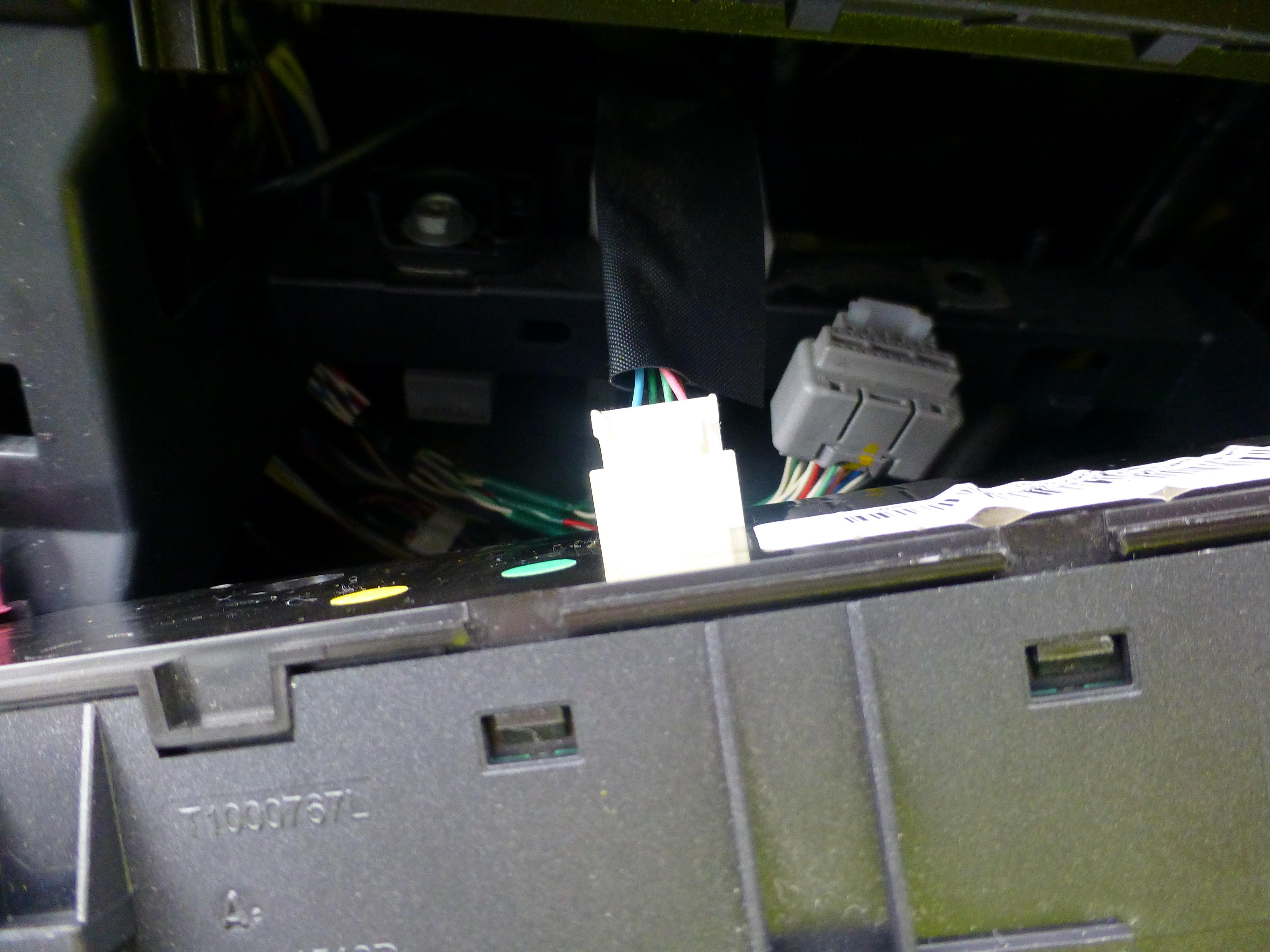

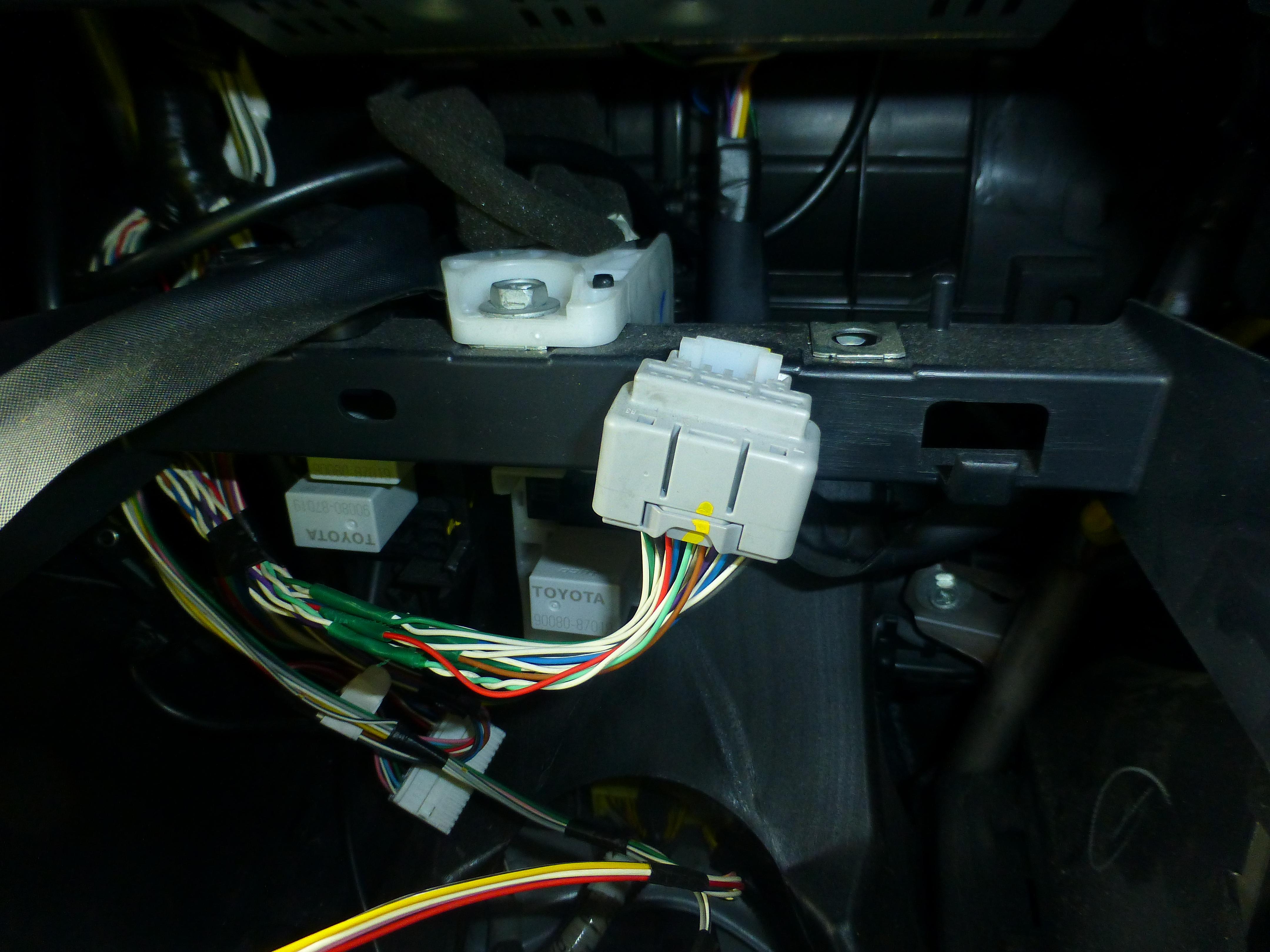

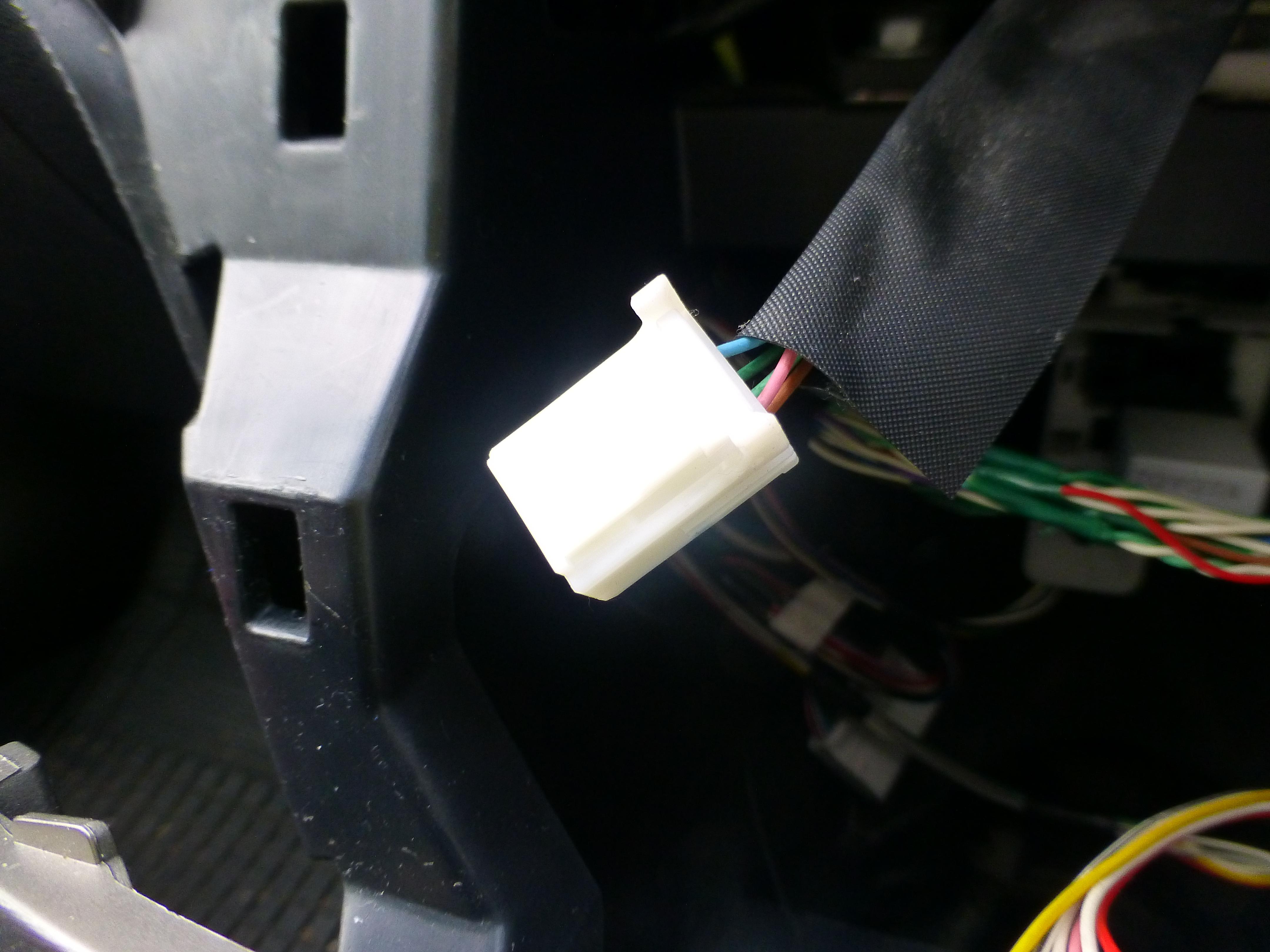

Unplug the heater control - P1140440.thumb.JPG.74deb2c5984c027de4b8837e6f143438.JPG P1140417.thumb.JPG.1425ad0ea802c6072d82ef259b61caf5.JPG

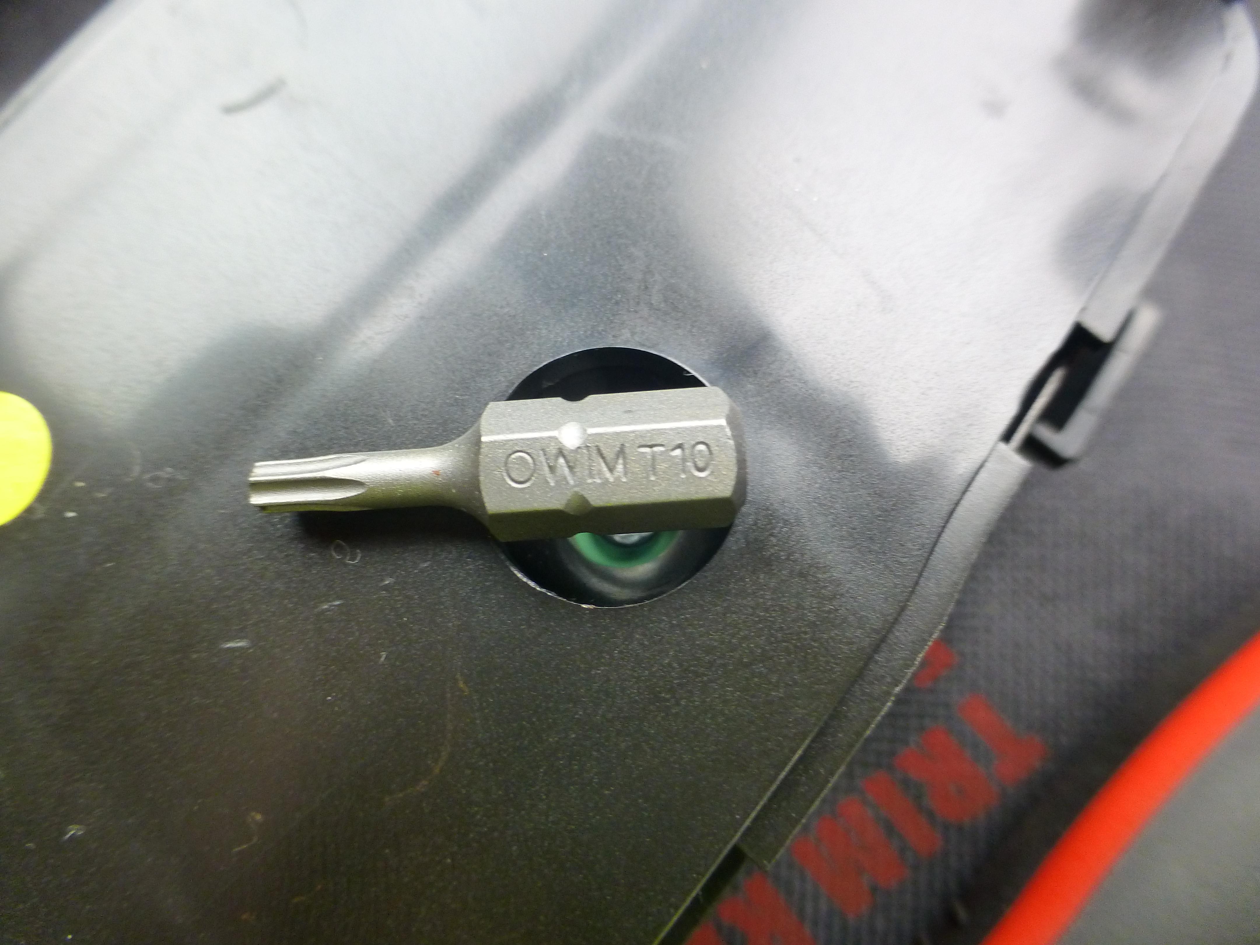

To open the unit first use a T10 Torx bit to remove the screws -
P1140438.thumb.JPG.f911571921d2798664f5230b7737a391.JPG P1140419.thumb.JPG.6d1d5e9b1cf19d9b4eaddb27df0498e5.JPG P1140418.thumb.JPG.21046ea28b05a41f644a6363d688f62d.JPG

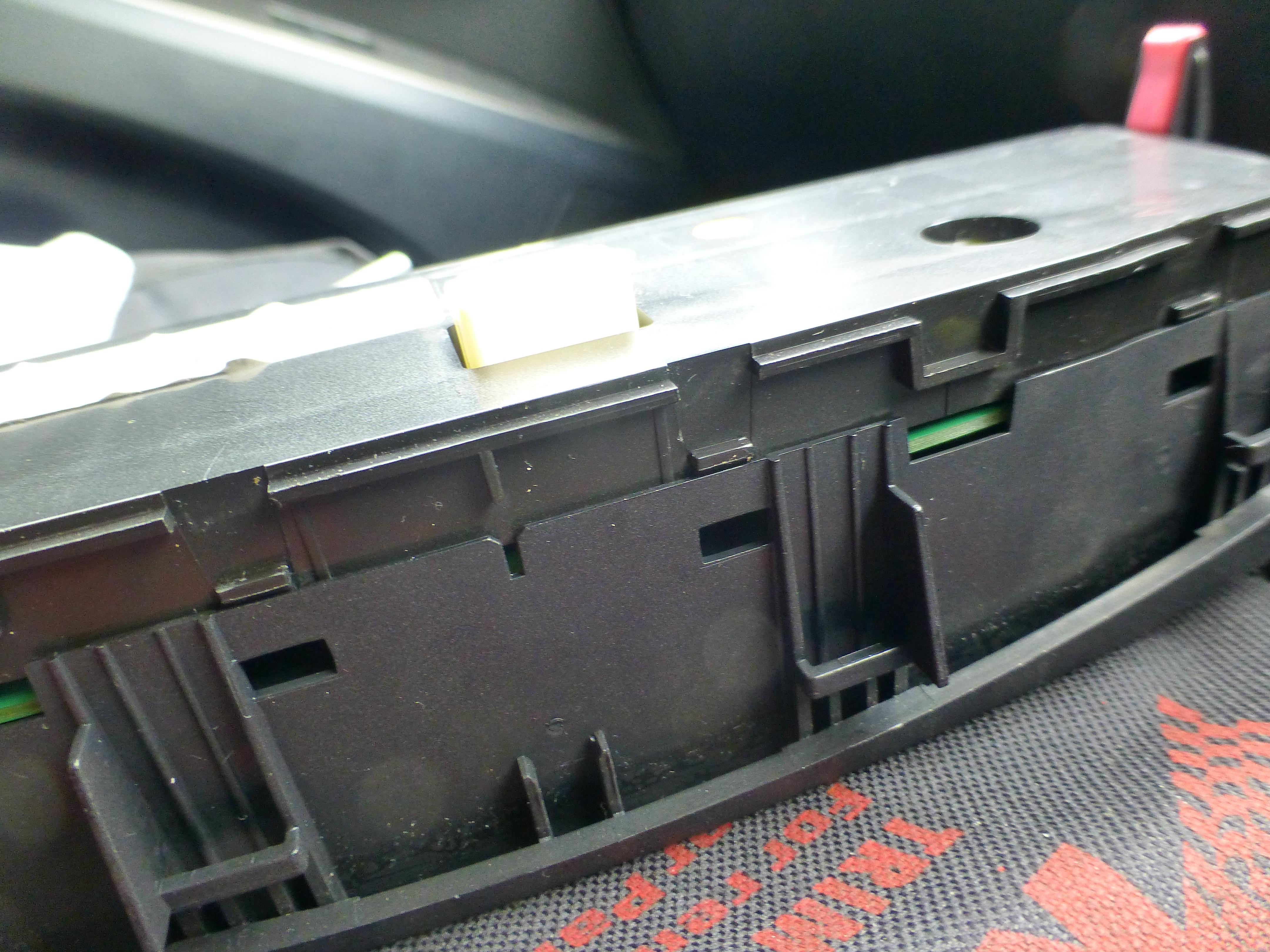

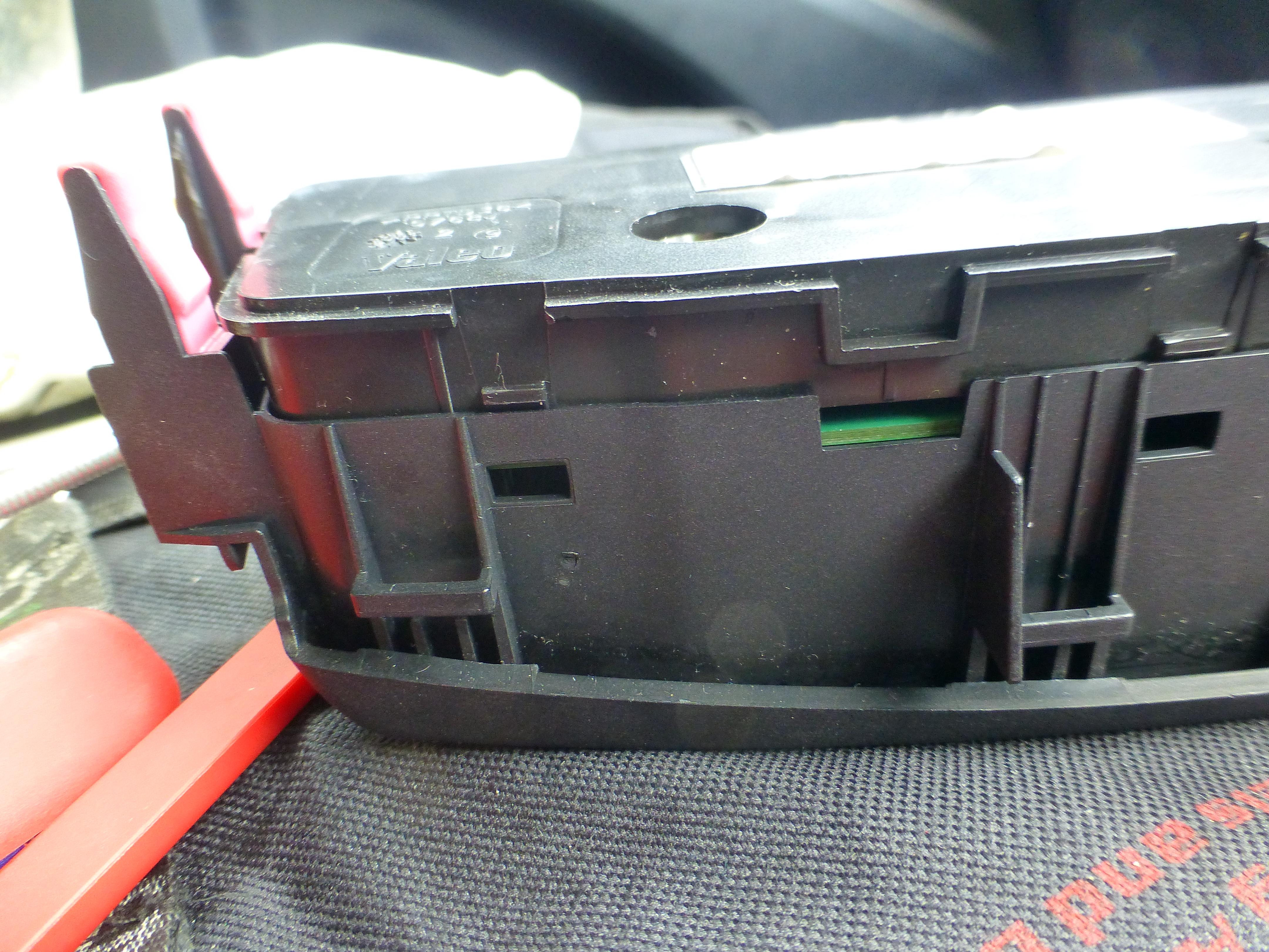

There are tabs around the edge -
P1140437.thumb.JPG.0f4f47f9cf37b8c249a8202e5f31f5c0.JPG P1140436.thumb.JPG.28508c54e712025b1bdb5925d8d31ef0.JPG

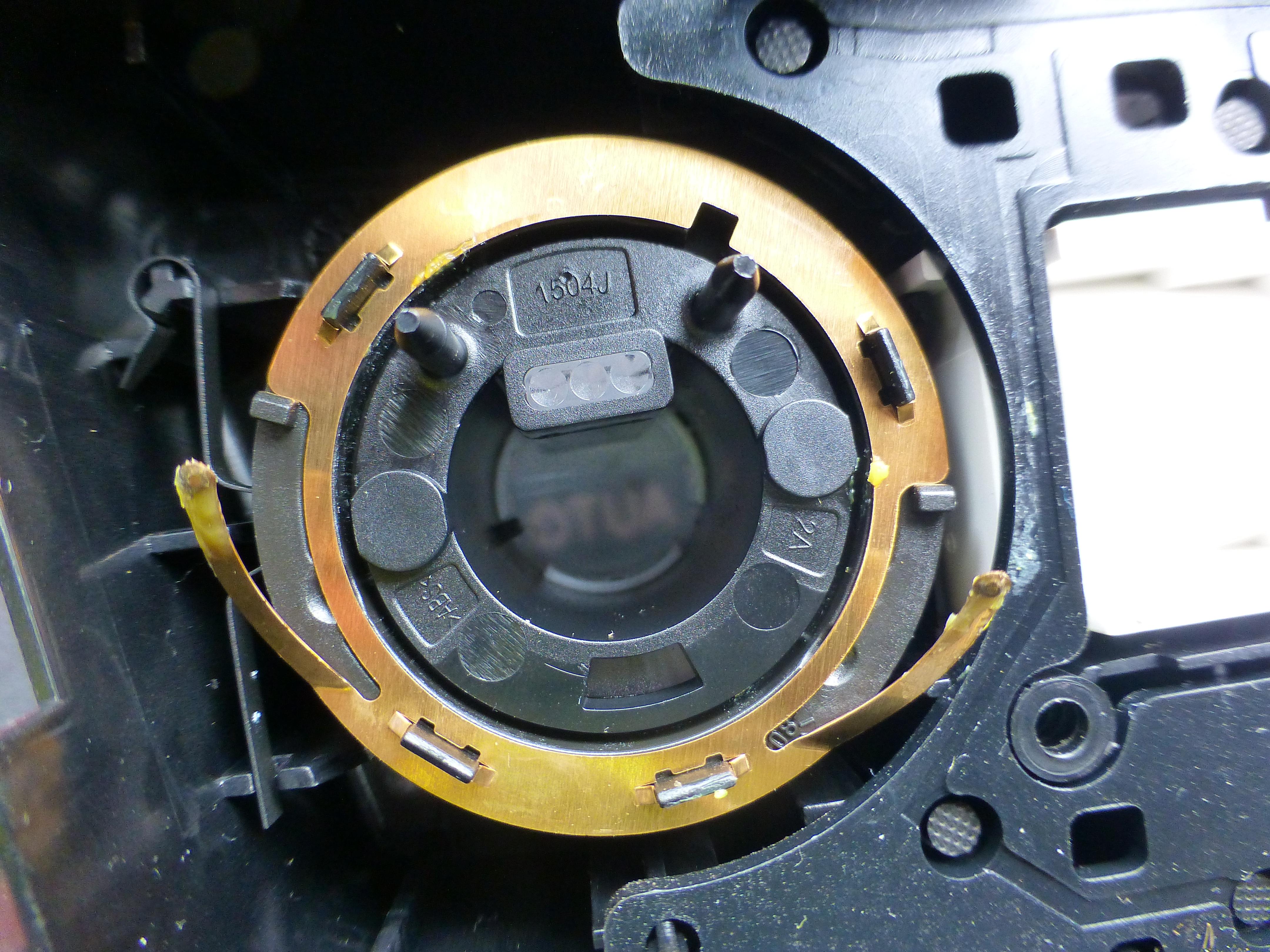

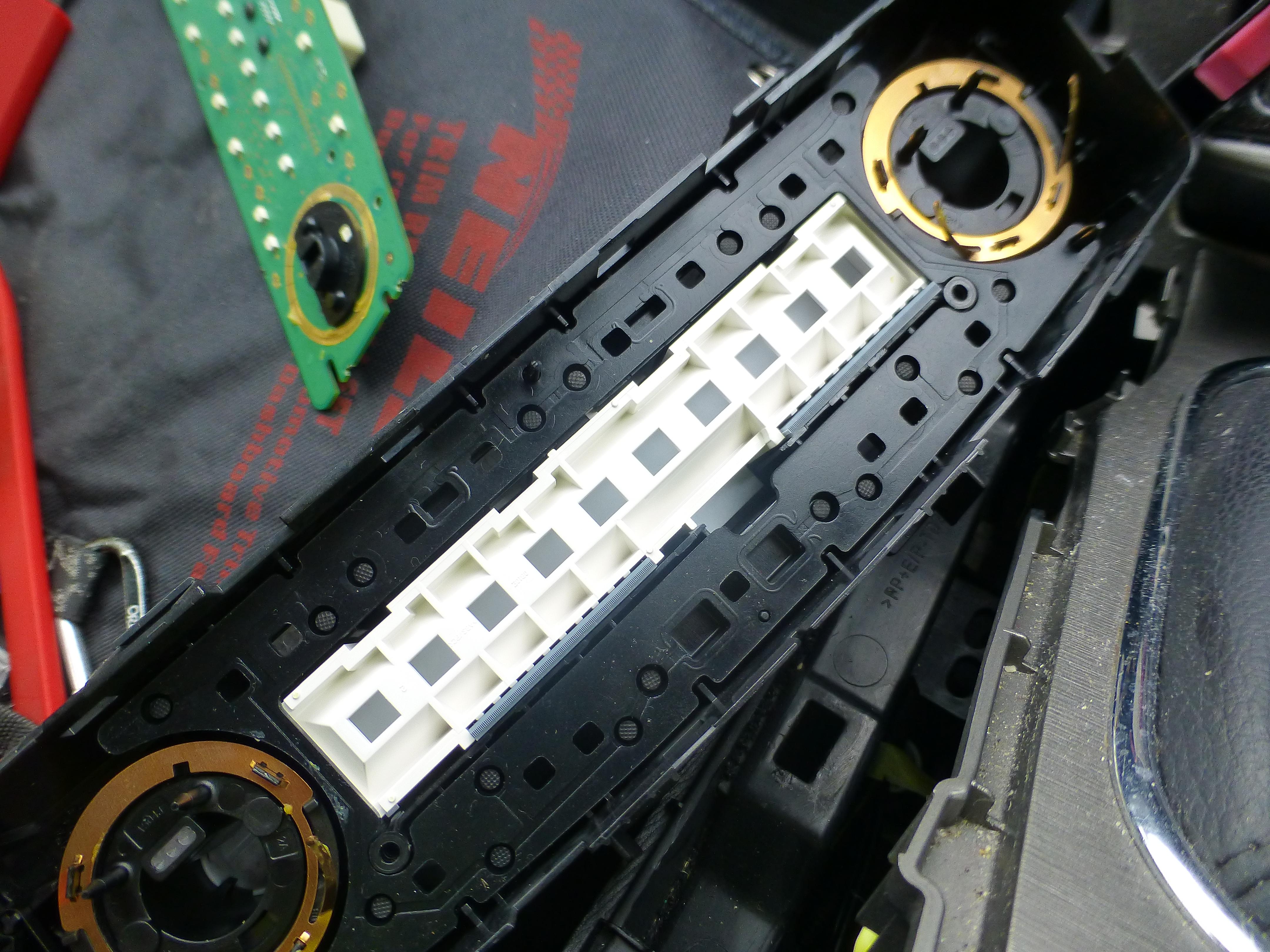

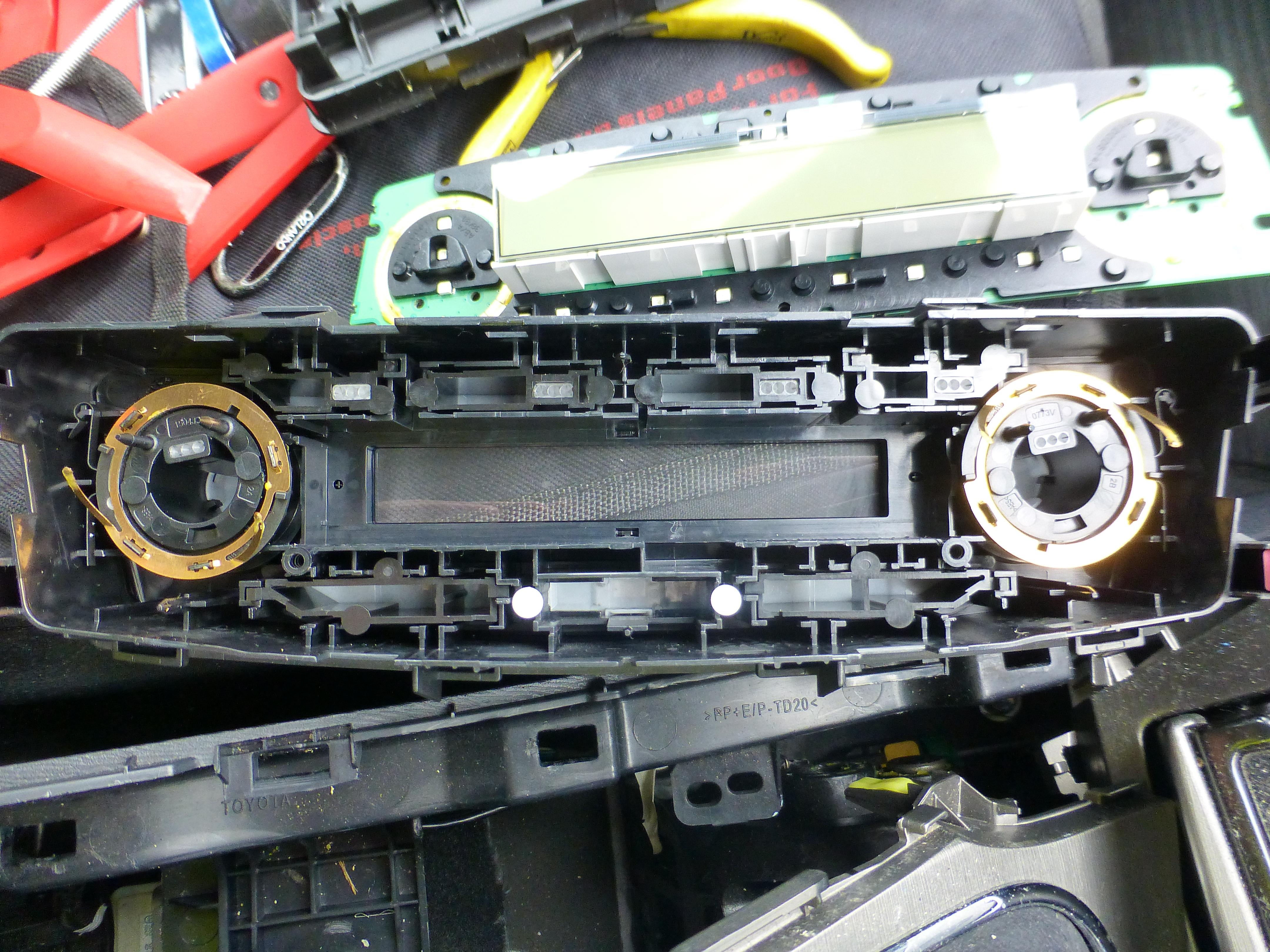

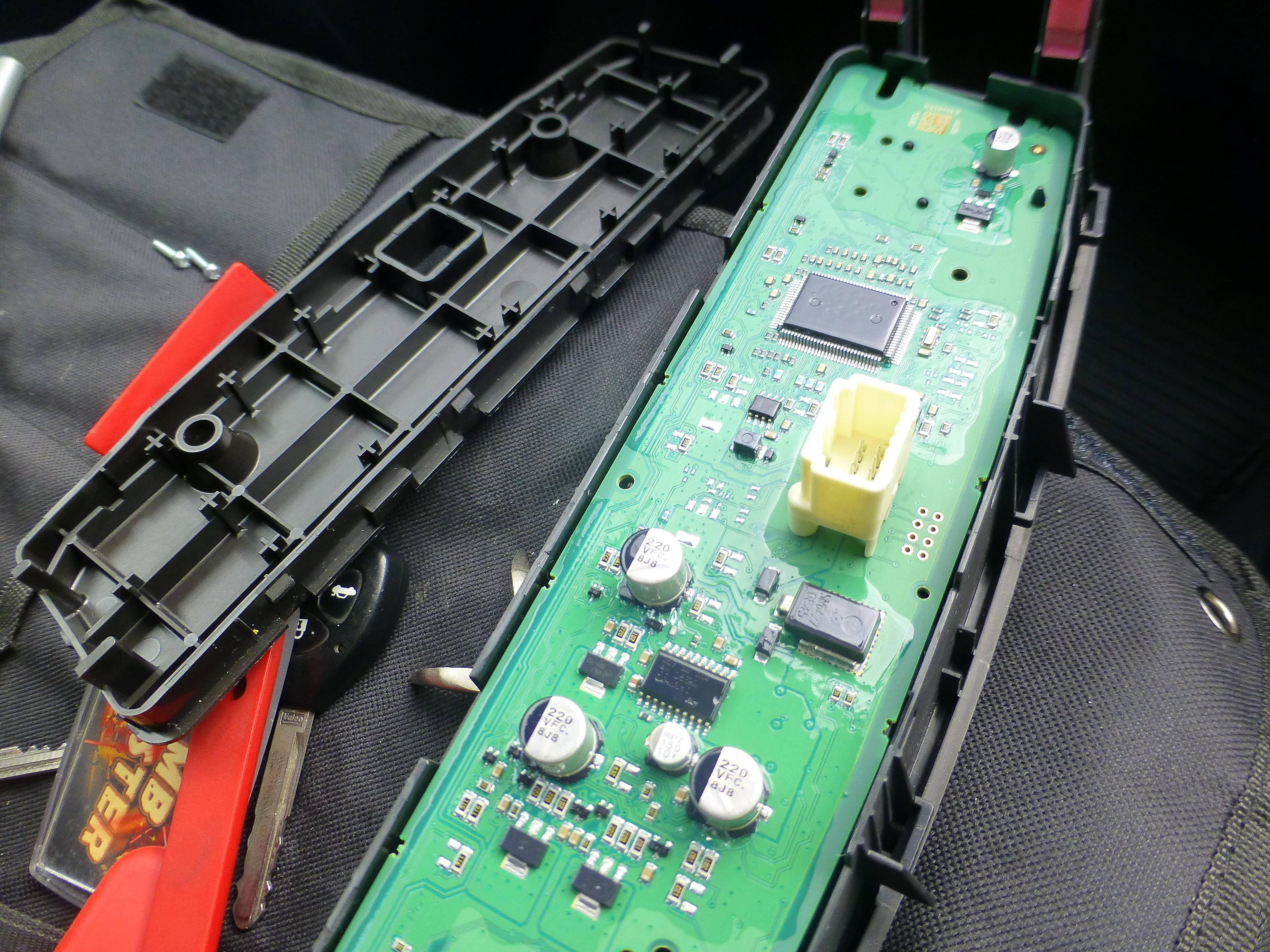

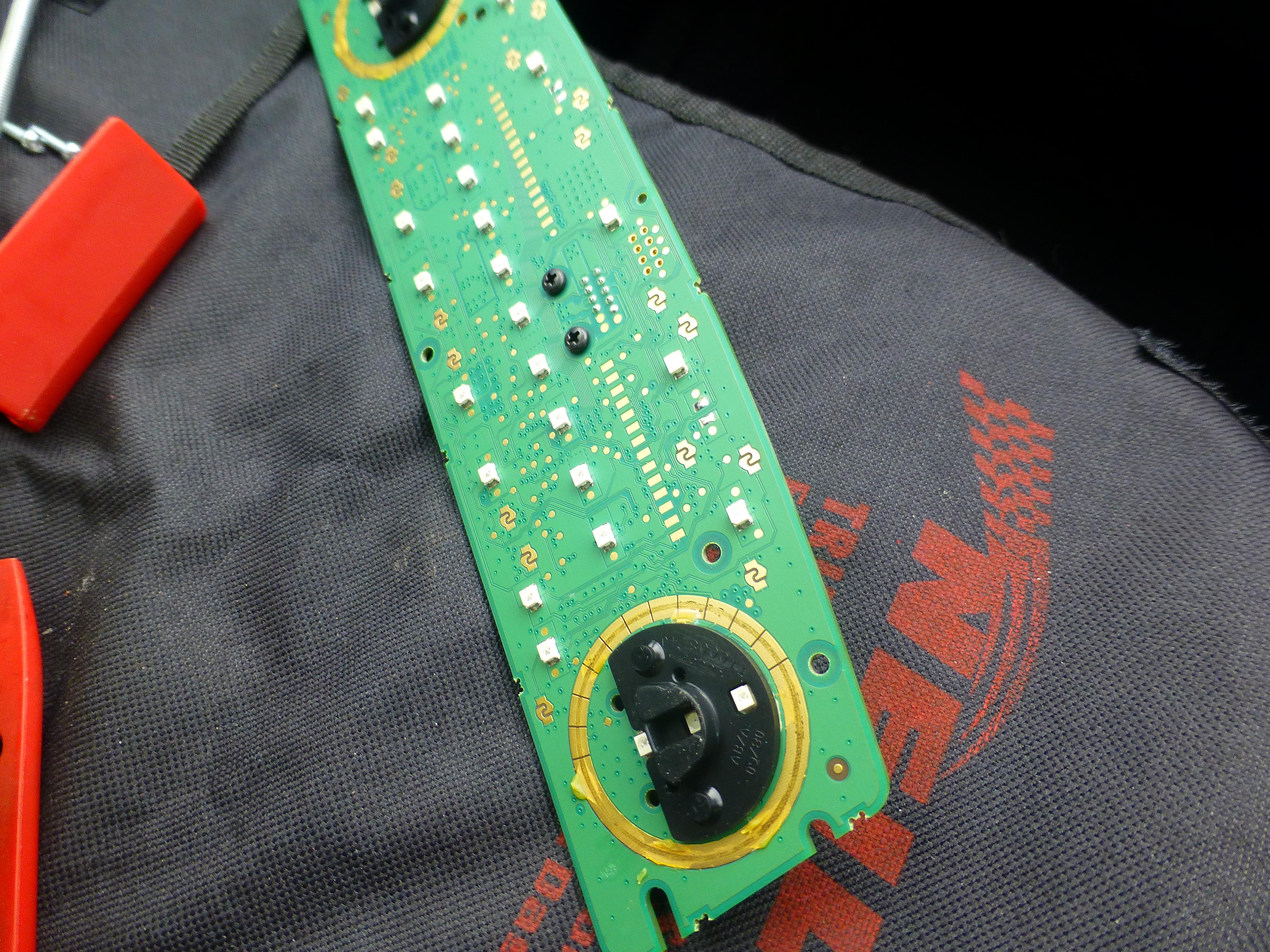

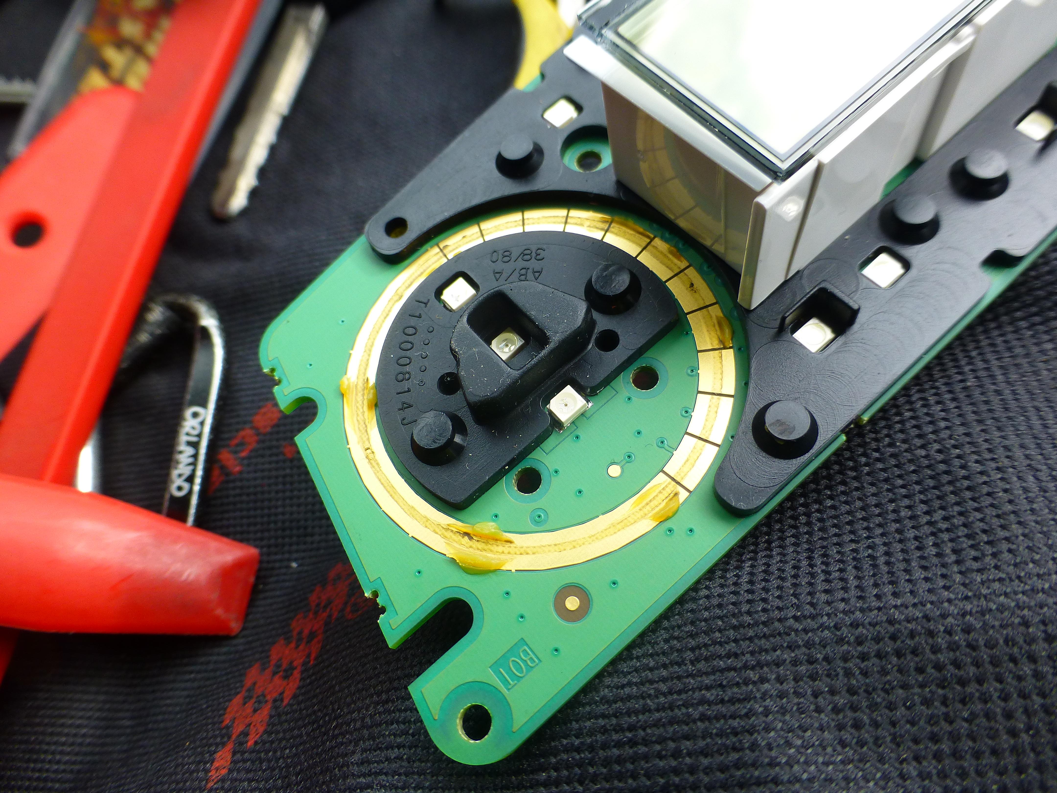

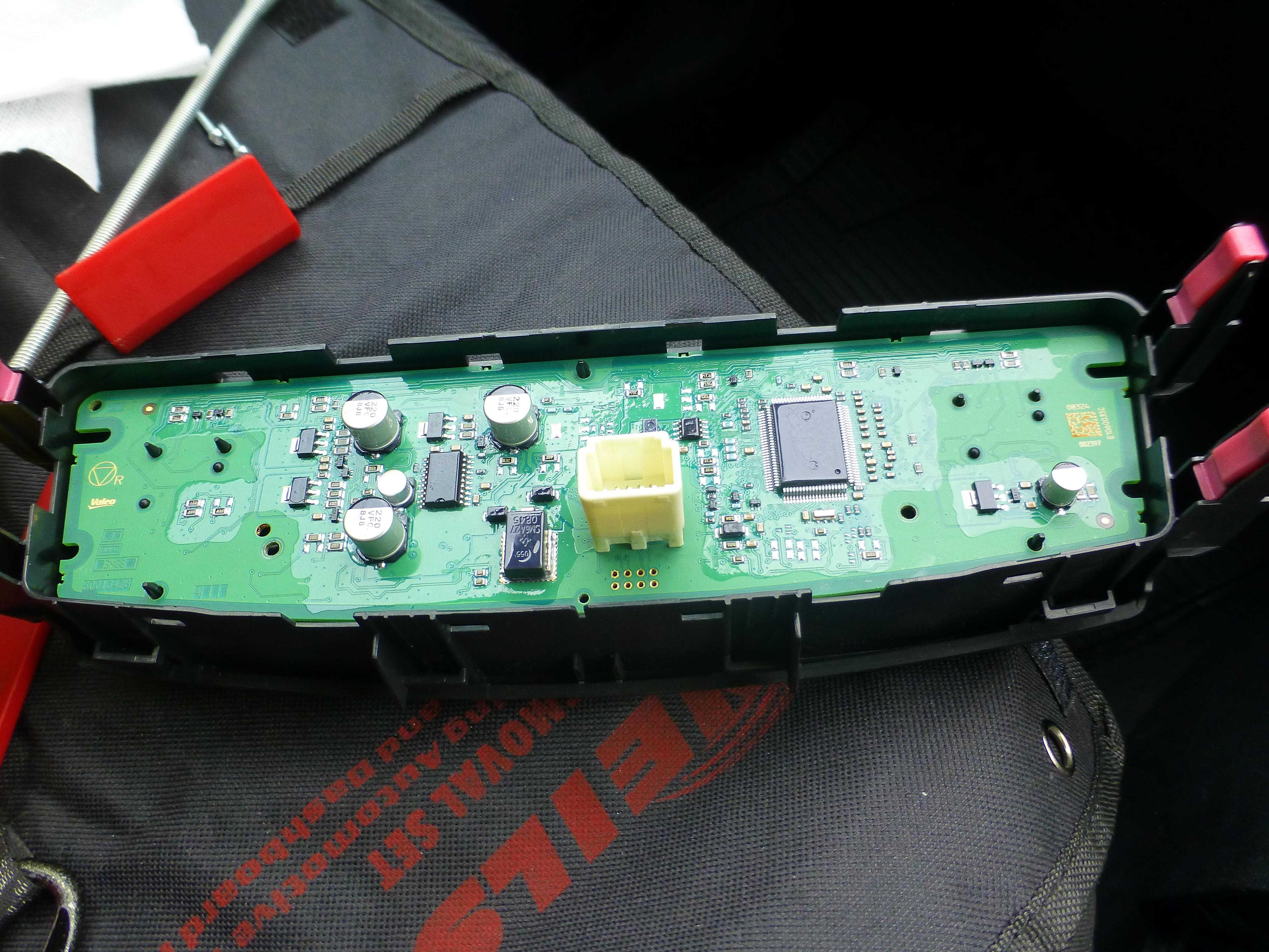

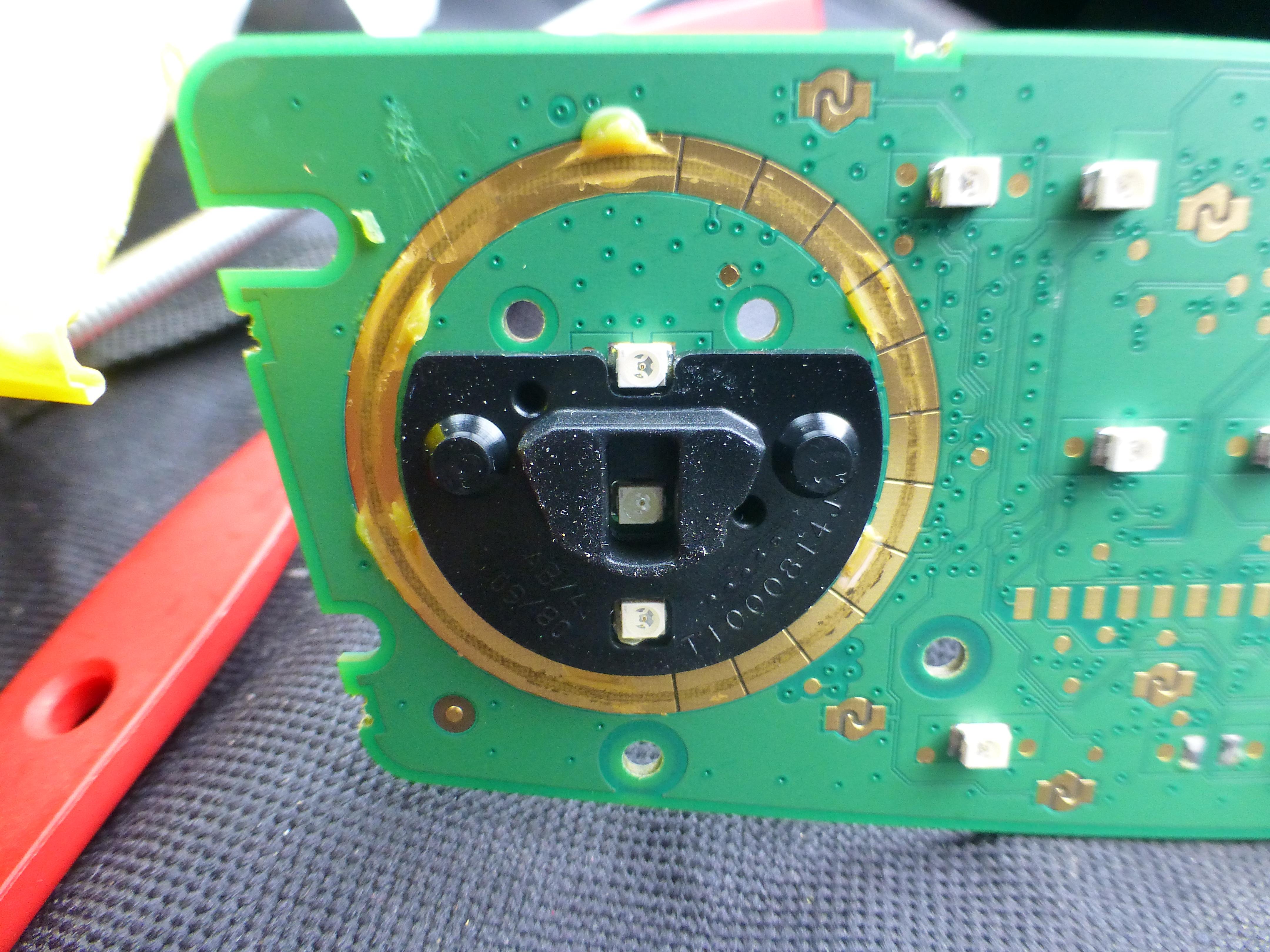

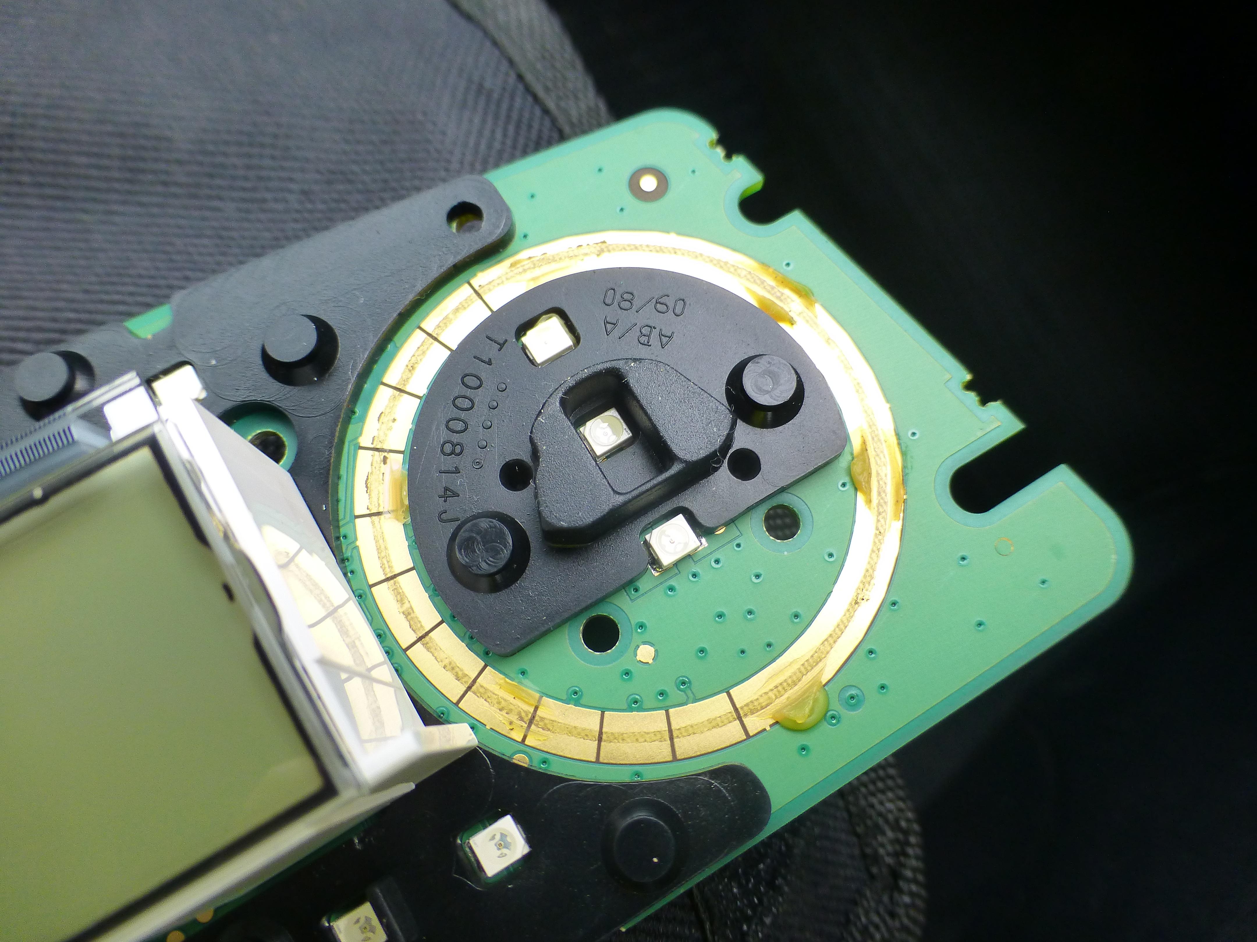

The heater controls dismantled.
 P1140426.thumb.JPG.ffa837b8a54a5aa872c654c7e7209970.JPG P1140421.thumb.JPG.5dc79b65fb7942d04703d956d9b0e3bf.JPG P1140423.thumb.JPG.3060823c928fbd561b07b6ca57f2c75f.JPG
P1140422.thumb.JPG.48e3312ca6c8b36f2dcff9d81c90d47d.JPG P1140425.thumb.JPG.4e19fe8a42f9e02103f6526777028b3d.JPG P1140420.thumb.JPG.5c116819a187c64fe71e411c194bbb1e.JPG
 P1140435.thumb.JPG.4f55c1a38e2ea505f20883c23064e2b0.JPG P1140430.thumb.JPG.62d33f6bc6d8d3b23cc40533adf61a66.JPG
Sorry for the jumble of photos. I hope this helps.
