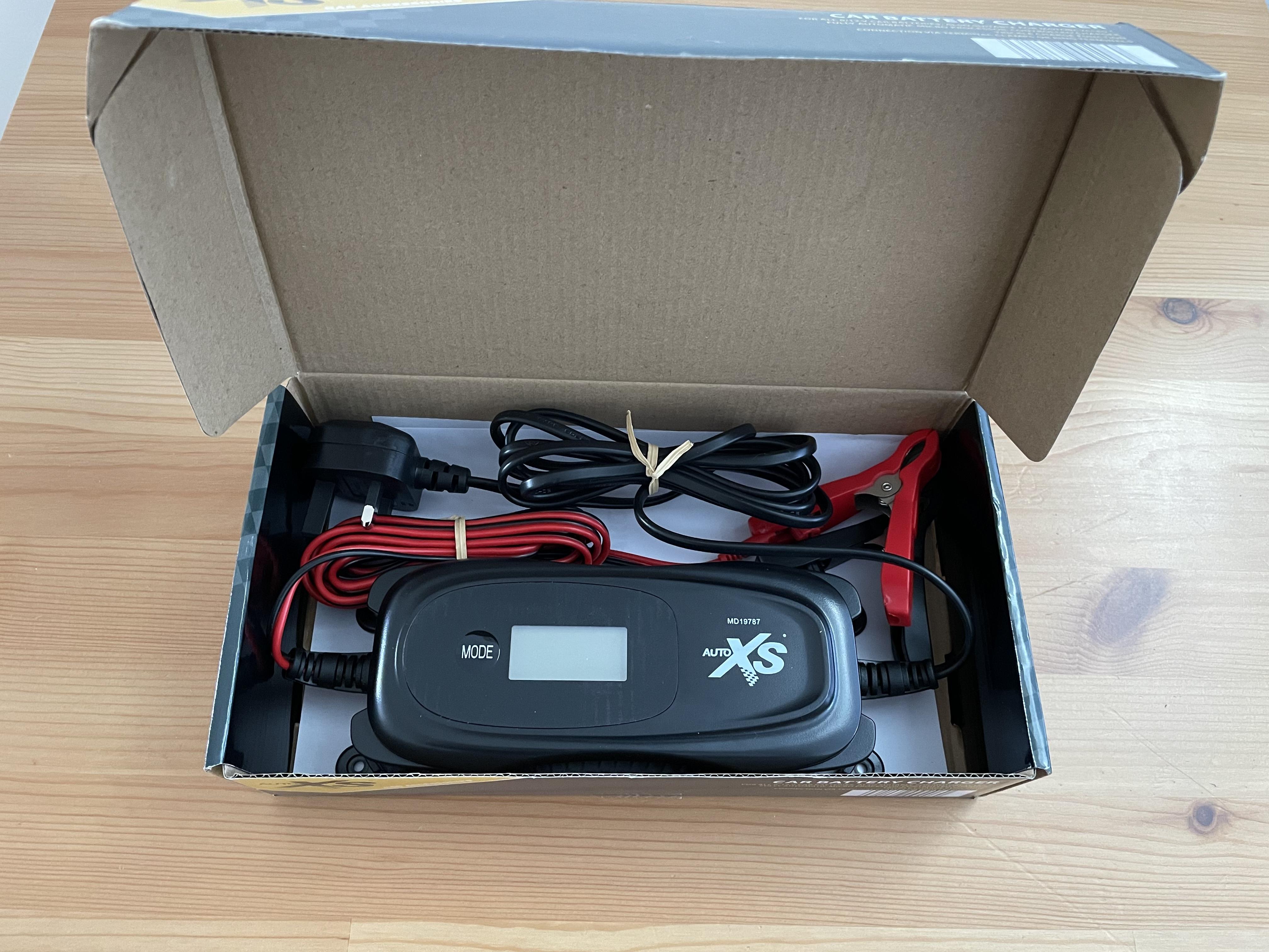

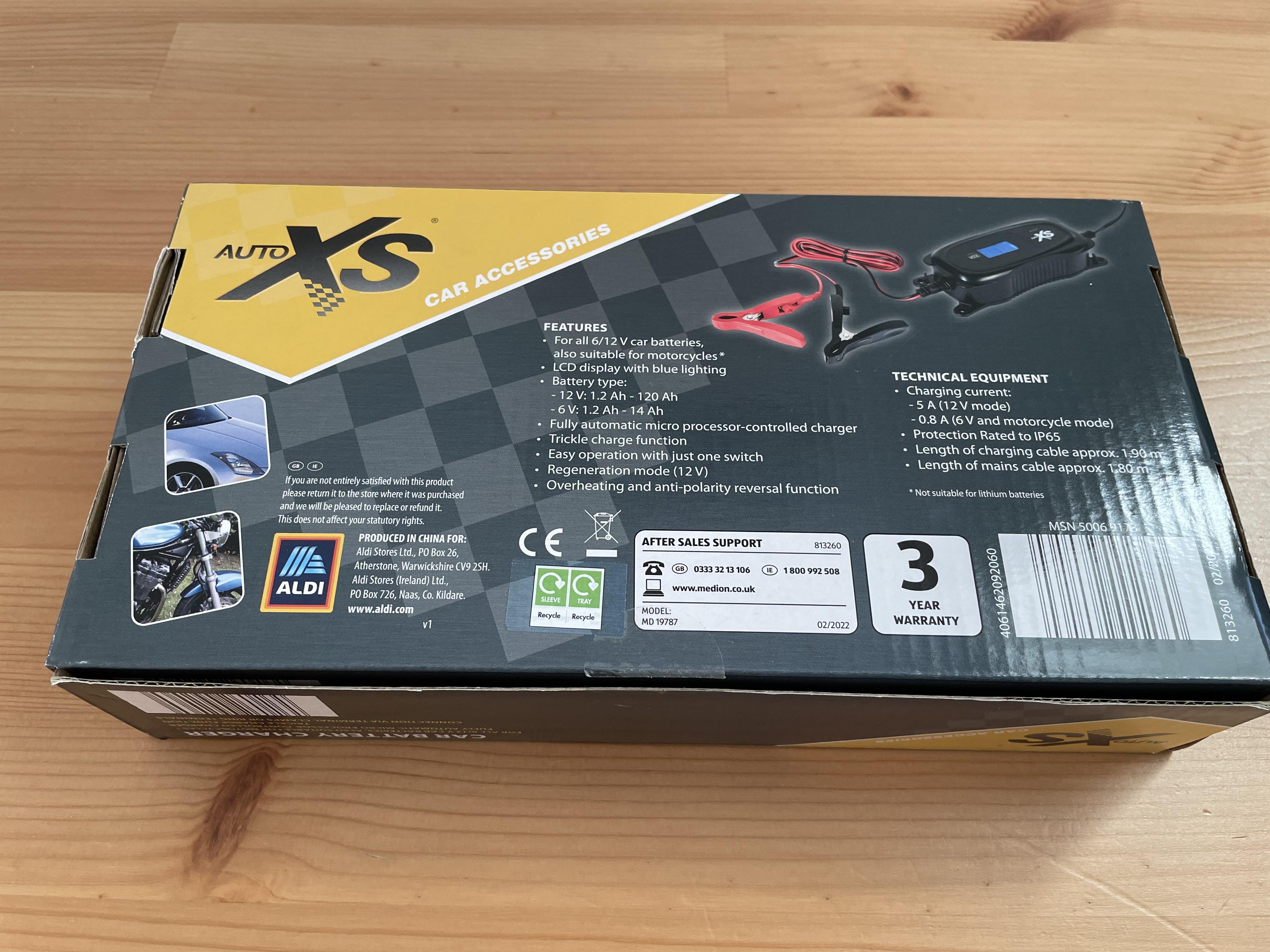

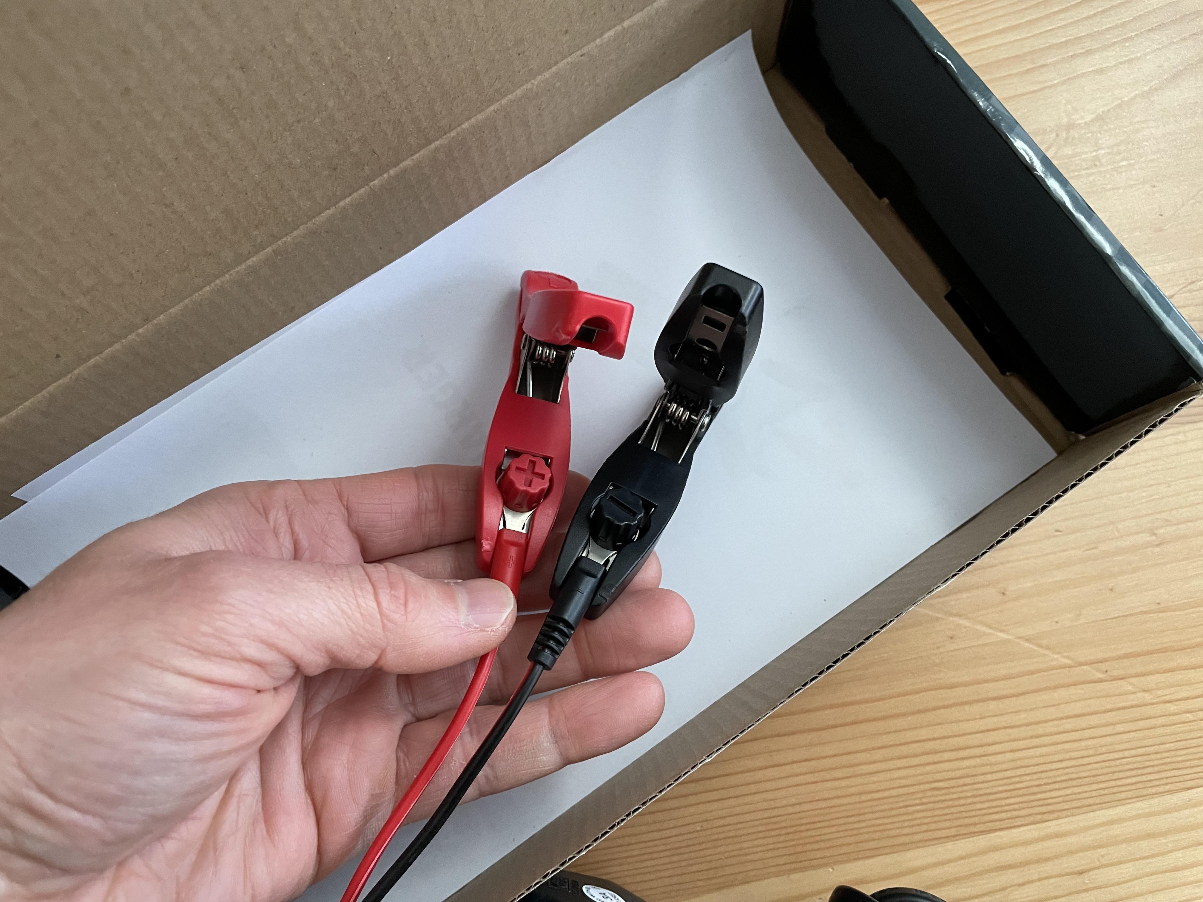

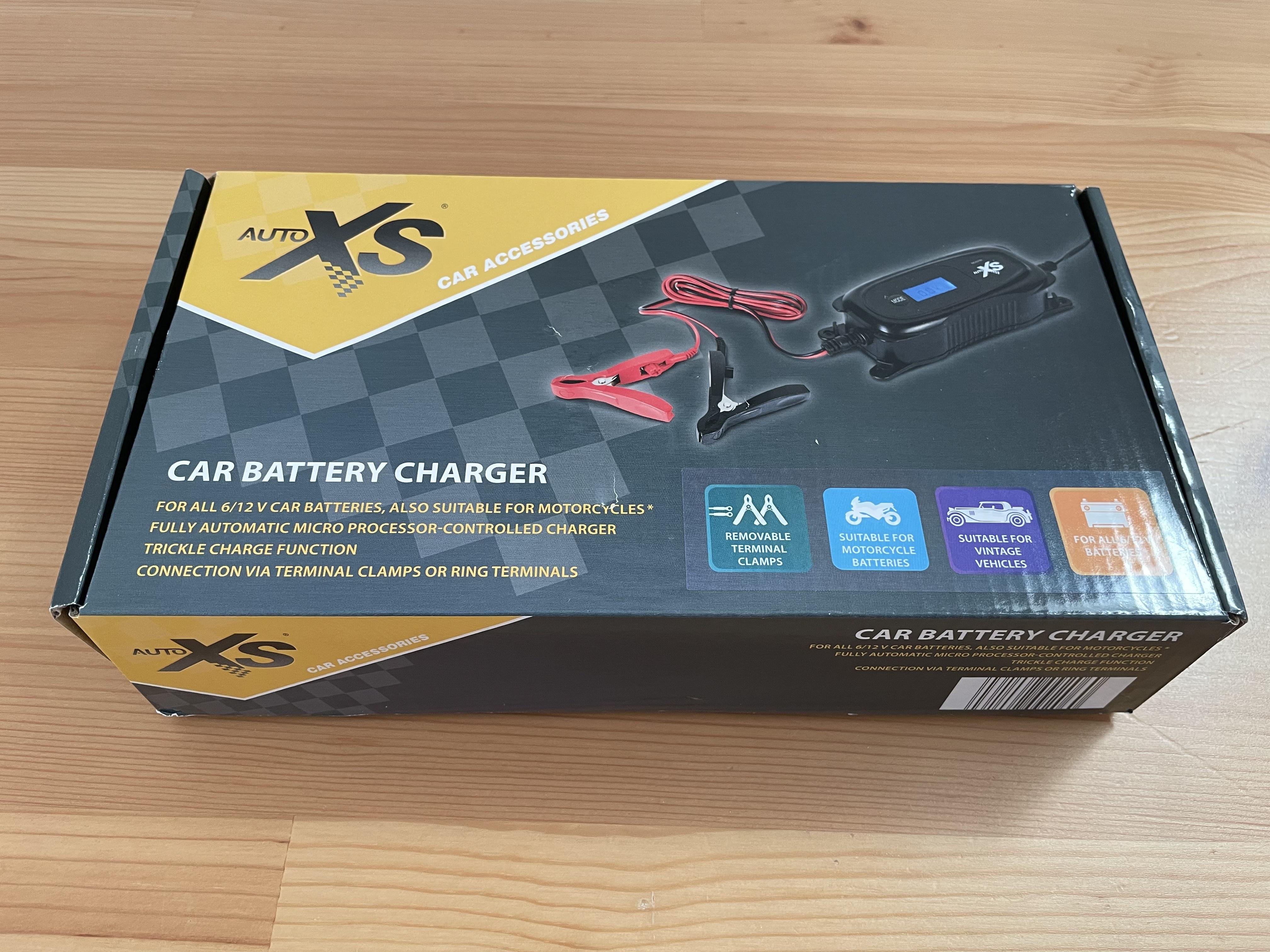

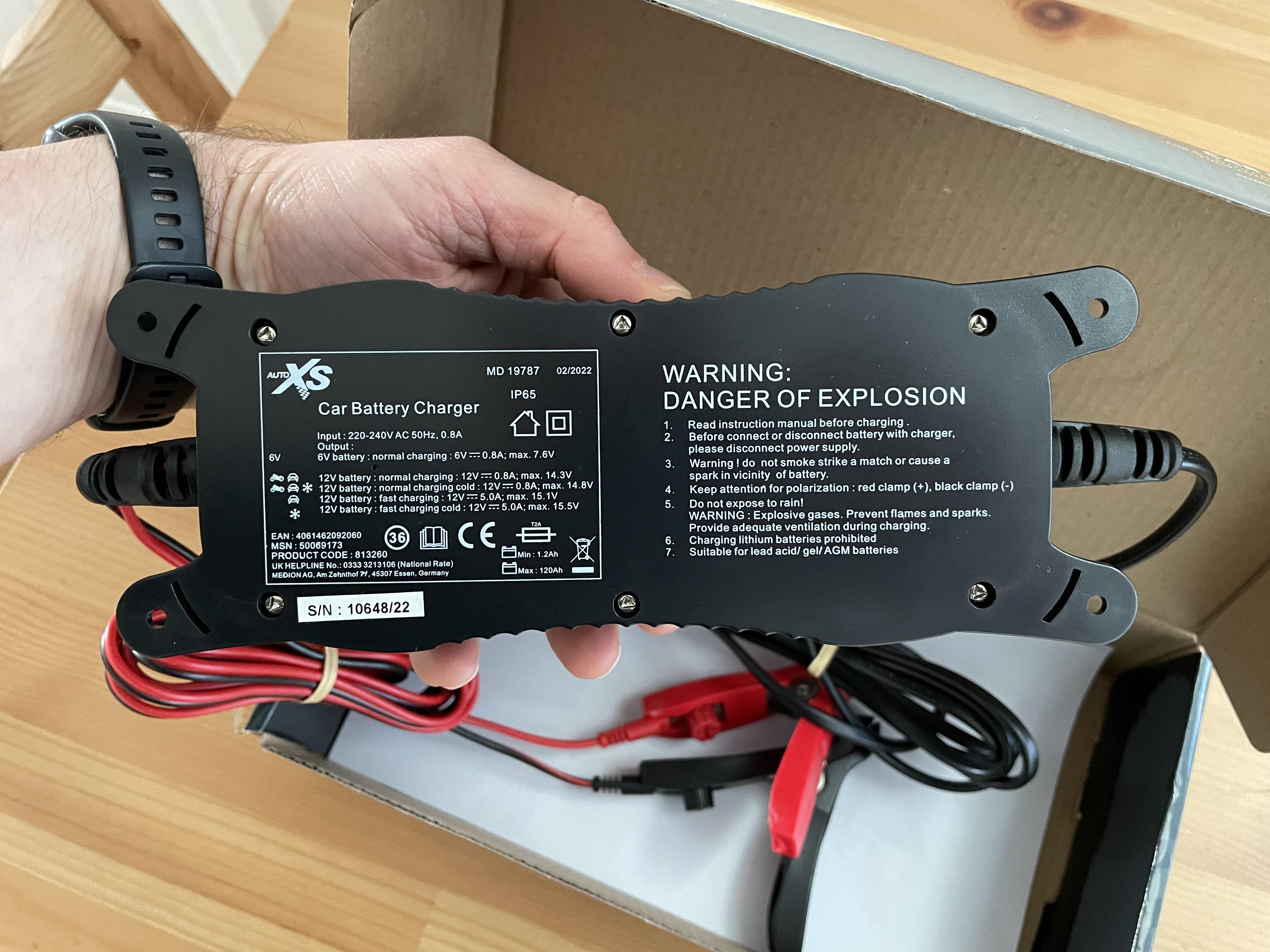

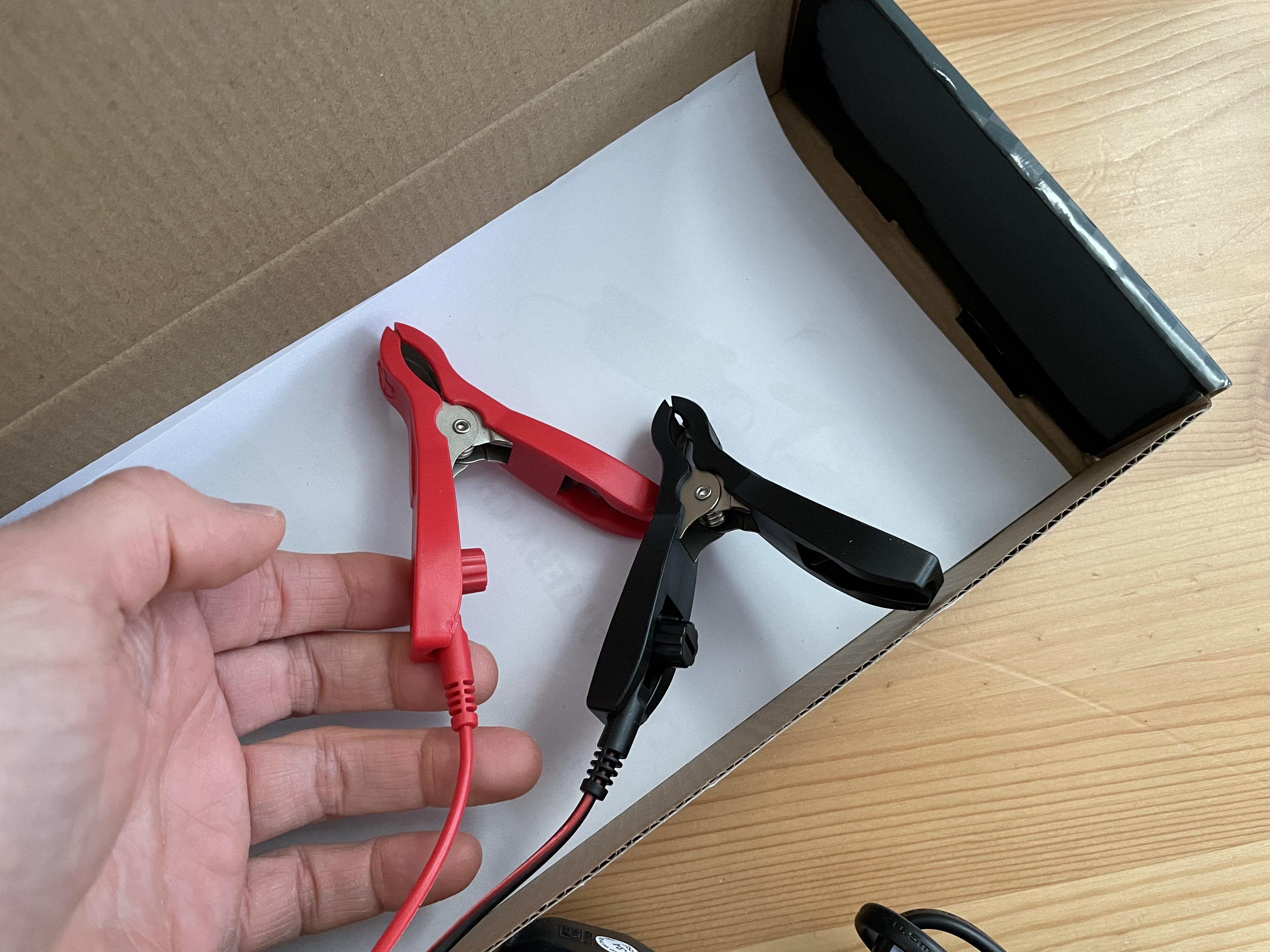

There it is my charger from Aldi. Looks good, quality made and very similar to ctek 5 for only £12.99 👌
I have no idea how good will be but I usually find Aldi and Lidl stuff often better quality than typical no name eBay or Amazon things.

@TonyHSD: Agree re quality. Do you need to plug this into electricity or can be plugged to the 12V socket in the vehicle. just wondering what do people do who do not have access to electric power socket near the vehicle?

Hi, this has a 3 pin uk plug and needs to be plugged into a wall socket, has a long cable but an extension would be helpful. The manual says to keep it dry and never expose to rain or water. I also have xs torque wrench that works better than some big names I used to have before so hopefully the charger will be ok if I ever need to use it👍

Looks very similar to the one I purchased from Amazon which has been working really well for me.
Amazon Smart Charger
It's gone up a few pounds since I bought it in May 20, but still good value I think.
If yours work out as well as mine, you have got yourself a bargain.

Just a point of clarification, this not a trickle charger but a proper fully automatic smart charger.  The mention of trickle charging on the box refers the final stage whereby it will trickle charge at the completion of the charging cycle.  This allows the charger to be left on the Battery to maintain it indefinitely without the risk of the Battery being damaged.
